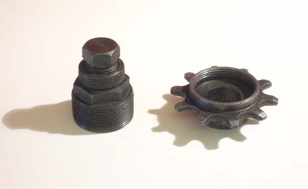

Welcome to the forum, to remove the sprocket first remove the nut. It looks fairly beat up but should come off, then you need the universal puller tool that comes with most kits to pull the sprocket off. If you look at the sprocket it has threads for the puller, you may have to reverse the center bolt of the tool because the tool is used for the clutch side gears also. The link below shows the tool.

I have the nut off now, but unfortunately I don't have the puller tool. I noticed it has that thread for a puller but don't see one in my extra goodies from the kit. I have a crank puller but it seems to be too small. They must have forgot to give me that tool in the kit. Is there any other way? I'm currently trying to pry it off but to no avail. I'm currently on a bike tour and might not be able to order something online.

You can pry it off if you can apply equal pressure on two places behind the gear. Be careful not to lose the key under the gear.
