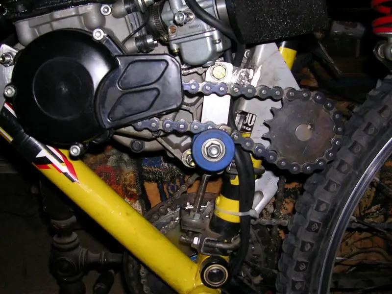

I also made a chain tensioner for the left side chain since I hadnt built a way to adjust that chain into my engine mounts. I used a modified skateboard wheel.
