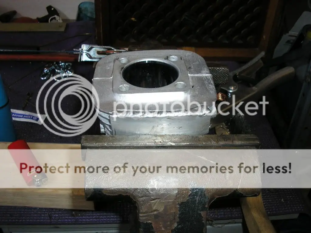

I am currently transforming a pk 80 into a liquid cooled engine. It is going in my slow building puma that I have been working on since april. the water pump and radiator are from a pocket bike and pump will be ran off the crank when finished I will post my progress

It's quite the task. boxing in the original jug and drilling water passages thru the cooling fins. quite a bit of welding as well.

Just a small update.. I have aquired all the materials for my travel into the unknown!! the new jug is all ready to start the fab proscess. will have to redial the welder as my new material is way thinner than what I used yesterday. I have a big piece of a hood from an audi its like a 16th thick aluminum. I still need to order my waterpump and radiator from pbu.. will snap pics of progress...

ok so I drilled the holes where the hoses will be coming out. I filled it with water and it held it without a weep for 3hrs. next is finishing up the rest of the bike so I can start putting it back together
