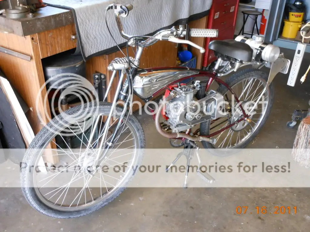

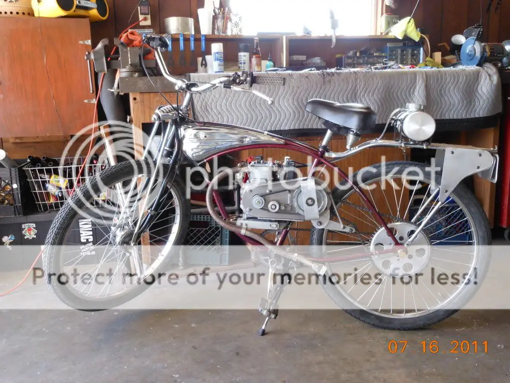

Took about 4 weeks for the kit to arrive and I have spent the last 2 months
building it. Here are pics of what I have so far.

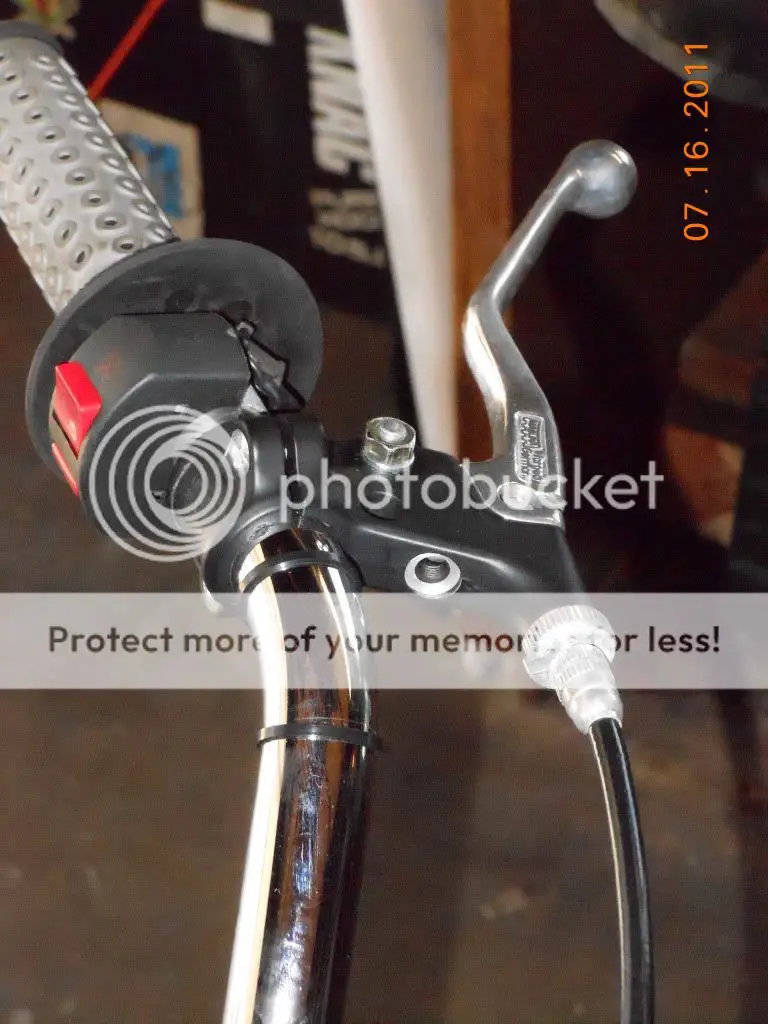

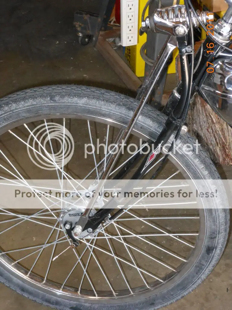

The first thing I wanted to do was make sure I can stop. I put a Sturmey
Archer front drum brake with an old Weinmann brake lever I had. The drum
brake need a few special spacers and locknuts as well as a strap for the arm.
I found a place online that deals with Sturmey small parts as well as a bunch
of other things Bike Tools Etc. - 1000's of bicycle tools and parts for the home mechanic!
The weinmann brake lever is too short to make the drum brake work effectively. On ebay I found a Magura brake lever with a brake light switch.
The front drum brake works really well with the added throw and I can wire
a rear stop light. People with small hands would not like this lever....it's
pretty long reach from the grips.........

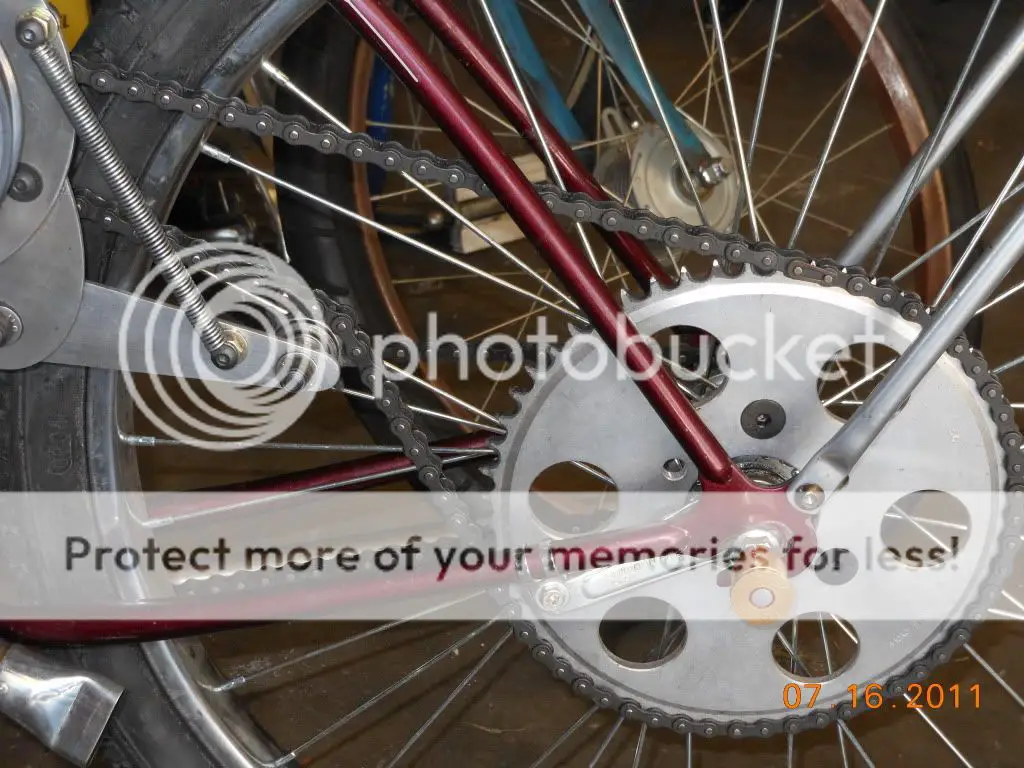

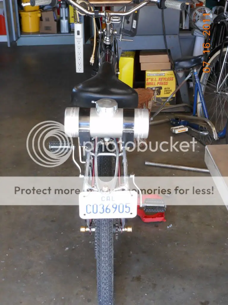

I installed a whole new wheel using Maniac Mechanic sproket adapter and 56T
gear, with a standard coaster brake.
I had to move the sprocket adapter all the way out to get chain clearance,
it just clears the brake arm. I also put some washers on the rear axle to
speard the rear for clearance.

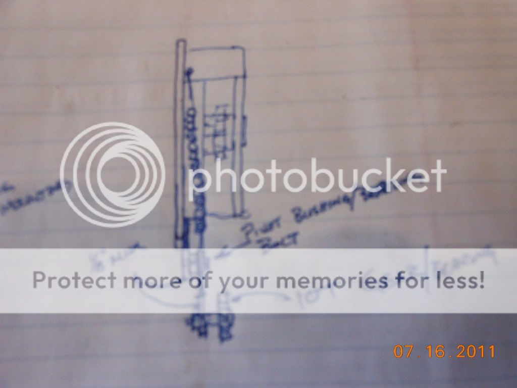

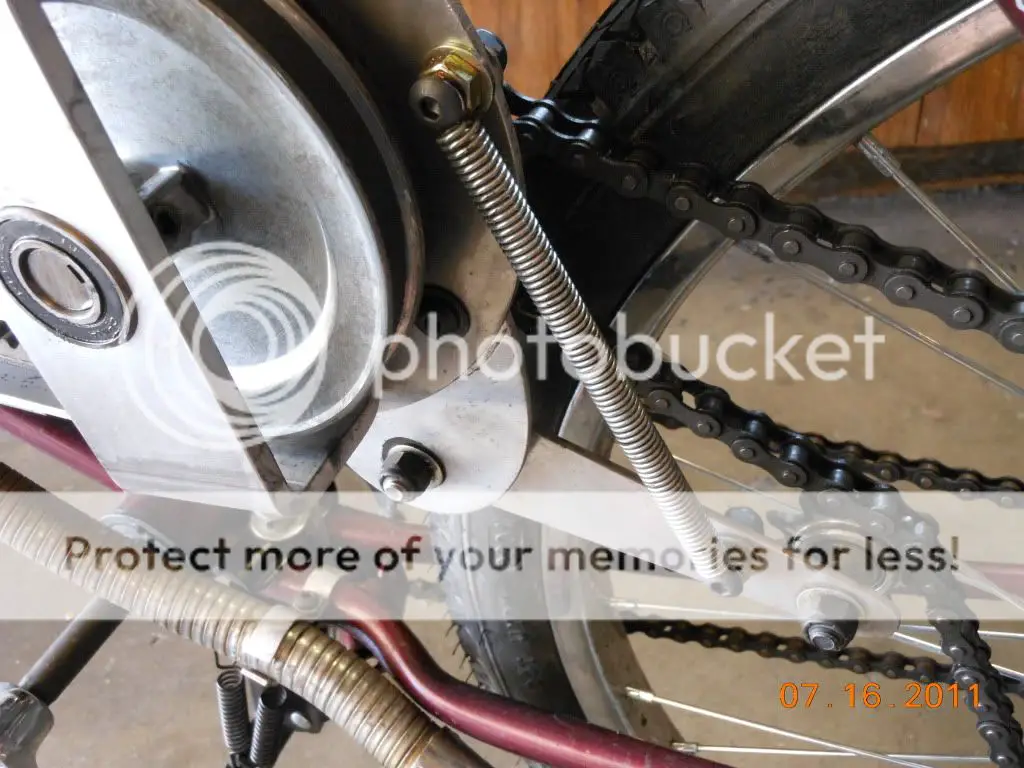

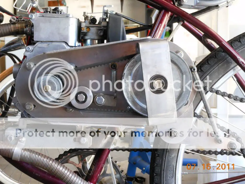

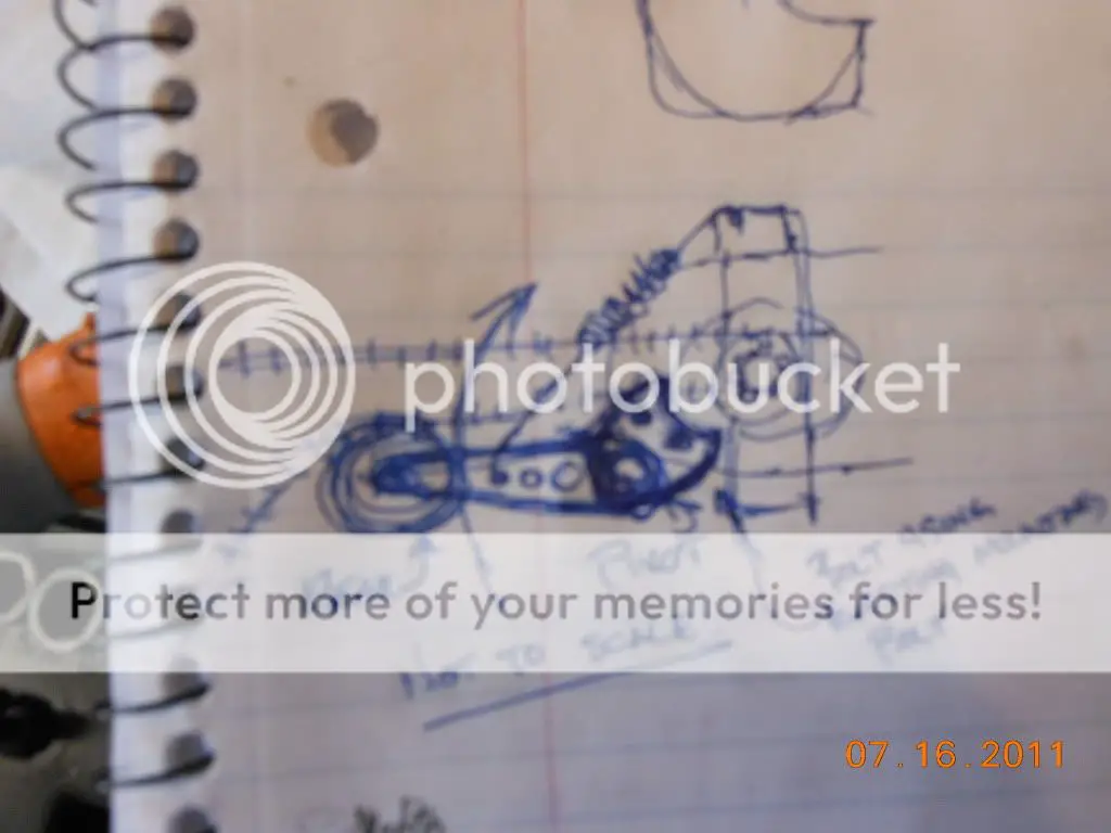

Next came the chain tensioner. I tried to set it up without but there was no
way. And I really did not like the looks of the stock one that came with the kit. Looks kinda dangerous. I started with thinking about a piece of alum
spanning the seat stays and chain stays. Then one night I sketched something different. Being this is the first motorbike I have built I really was
not sure if it would work.
The pics are fuzzy but you get the idea.

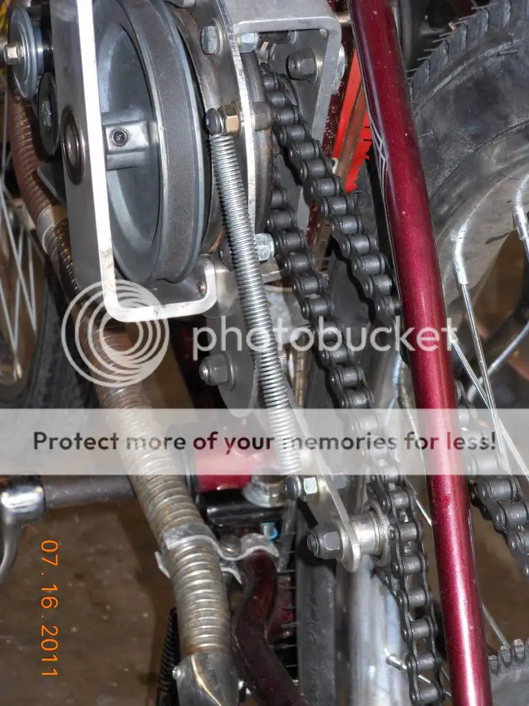

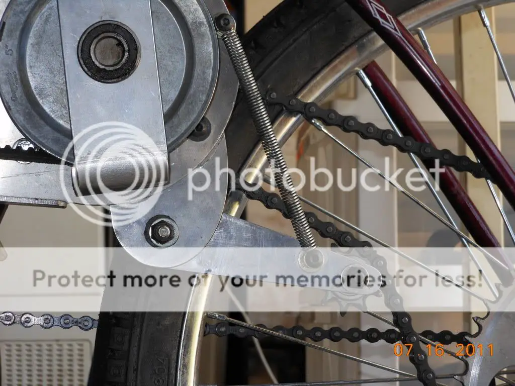

I first made the mount and arm out of cardboard and tried to figure out how
long the arm needs to be as well as how much spring tension. I cut 1/8" alum
then used a grinder and sand paper to match my cardboard templates. It uses
a shoulder bolt and thrust bearings for the arm pivot. I used spacers at the 10T gear to align with the Q-matic. I originally used a softer spring but that failed as the chain jumped off on hard motor braking.
I put a stiffer spring on and it seems to work good. However, I hear a lot of chain noise with the 10T alum gear. Just how tight should the chain be?

Been a while since I posted my first build. I have about 800 miles her now and all seems to be going well. I have had zero problems so far. Would anyone be able to give some insight as to how tight my tensioner spring should be?
As I am riding, the spring loaded tensioner does bounce up and down and really goes down under motor braking. The chain does not jump off, but I am sometimes concerned by how far the spring does let the arm pivot.
