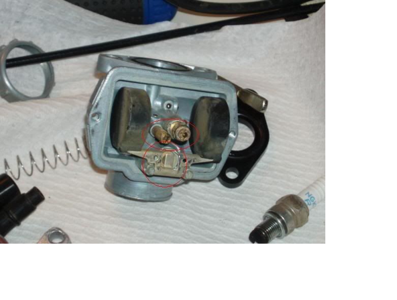

Cant tell how well you cleaned the carb but I circled in red what is most important. I have the same carb, when I have time I will post pics on how to clean it very well if you need me to.
Be sure to remove the float and jet and make sure it's not plugged in their. From the looks of the float it sat with gas in there for a while and a good chance it has gummed up in their
The best way to clean the carb is to take it completey apart and run down to local auto parts store and get a can of parts &carb clean solution(not the spray type) and put it in a cofee can and soak it over night.

What about the rubber bowl gasket? Can I re-use it if its still in 1 piece?

If the gasket is in one piece, you can usually re-use it. Don't get carb cleaner (the soaking kind) on anything rubber! Including O-rings and gaskets.

Thanks for the warning, but I have enough general knowledge to know better. I went shopping today, and couldn't find the same type of battery. I'm going to have to order that. Might as well get a new gasket since it only adds $3.30 to the order.
I'm about to remove the jets and float for soaking. How crucial is the depth that the jets are screwed in. I have the feeling I should try to re-install it to the same depth.

Well the drain hose I had was broken off, so I have no idea which way it goes. I was going by this pic I found online that is the exact same carb I have.
It sounds like I just need to have it go down and off to the side a bit. The reason the gas was leaking earlier was most likely due to the drain screw not being tightened all the way.

I've completely re-built the carb w/ a new float bowl gasket, new fuel line, new fuel filter, and I added a fuel cut-off switch. Cleaned and re-oiled the air filter.
Got a new battery, and a charger.
Changed out the spark plug, and also changed the oil.
Pushed the starter button, and she fired right up! I played around w/ the carb a little, but I need to read up some more. It was getting too late to have the thing running...its loud and I have neighbors.
