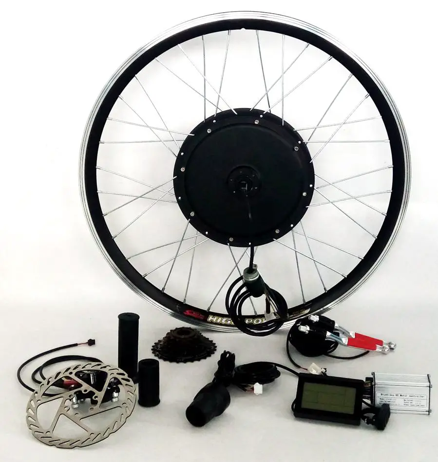

48v x 30a gets you to 1440watts, I have run my Pie like this however the max watts I ever saw was 1330w.
52v x 30a=1560w
Get a Geared MAC10t if you want more torque, this MAC I have has better torque at 20a than the Pie at 30a.
