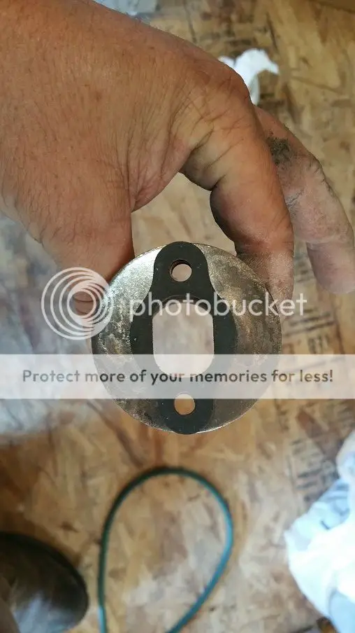

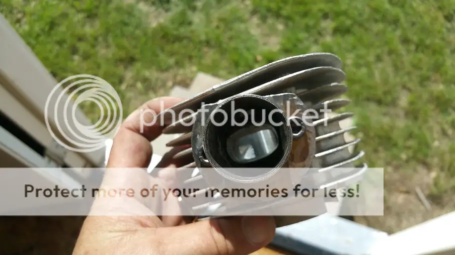

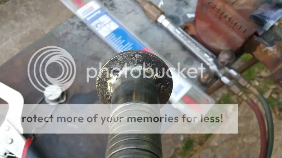

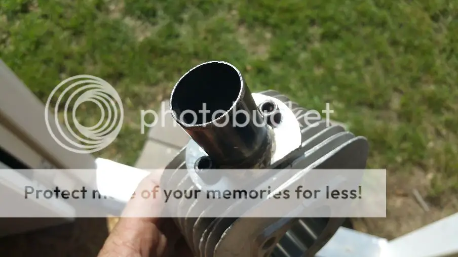

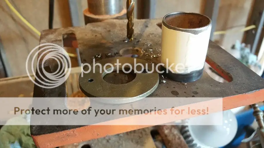

Nothing fancy here and I haven't taken pix of it since some more cleaning up and the header pipe being brazed to flange tubing, but I just thought I would share some pix of how you can make a nice exhaust flange from a washer if you have the tools and want to take the time, I wanted the "Taffy Bike" to have a large unrestricted exhaust since the mods I have done to its engine will allow it to get so higher than normal revs, the header pipe has a 1" ID and is currently 18" long, I will likely reduce the length to 14-16" if I have room to go that much shorter and still be able to mount the expansion pipe where I want it.
These pix are all of things in the rough and honestly I didn't do a lot of cosmetic clean up since the header pipe from flange to chamber will be wrapped in exhaust wrap so none of it will be seen anyway, but is is cleaner then seen in these pix now and has been sprayed with hight heat flat black paint.

y'know those bolt through frame adapters that come in the kits? the one where you're supposed to dri a hole in your frame to mount your engine?
drill the center hole bigger and boom, instant exhaust flange.
Thanks bairdco, I think I have one of those drill through the frame mounts, thats a great tip, Ill try to find it and try that mod out, little things like that are good to know for repurposing junk parts like those type mounts.

The pix make it all look way bigger than it is, its only 1" ID, but it does look huge in those pix, I have a moped expansion pipe I got from treatland.tv a couple years ago that has been sitti g in a box, Im not sure the stinger pipe running through the silencer is as big as it needs to be, but Im gonna try it on the Yellow "Taffy" bike and see how it runs, I thi k the chamber will suit my needs or wants but I'm not so sure I won5 need to cut the silencer off and braze on a large ID stinger to get the flow where I want it.
I have one of the big fatty snake looking pipesI rigged up last year, and its an under performer do to the small 3/4" ID header pipe and maybe even because the exit is a bit restrictive also.
Ive found that one of the key things to higher rpm potential on my engines has been to get the exhaust right, an expansion pipe is not needed abut good if its done right, an expansion exhaust thats to restrictive on either end with have worse performance that a straight pipe or even a gutted out and modified stock type muffler/exhaust, Ive yet to have m6 fastest bike do its top speeds with an expansion pipe, all my top speeds have been done with very free flowing exhaust that I rigged up myself, problem is that they are very loud which makes no difference to me where I live, but for city people that kind of exhaust can draw negative attention to our bikes.
Im not shooting for a top speed personal record anymore so as long as I can get a couple of my bike to comfortably cruise at 40-43mph on the flat with a 32-36T on the rear Im happy, Ive done 50+mph on the one bike, done 48mph on another and Im good, I was inspired by bairdco way back when I got i to this hobby to build an engine that would get me to or over the 50mph mark, I did it and now Im happy at 40mph-ish for a top speed and a comfortable cruise speed of 35-40mph if I want it.
The right balance, the right jug, good clean ports, good compression, well tuned carb like even the little NT or NT Speed carb,the right gearing and a good free flowing exhaust will get what I want done with my bikes and thats what Im shooting for each time I put one together, having a good crankshaft balance is a huge part of all this, if someone has a horribly balanced crank all the other things dont mean much since the higher rpms will just help the engine grenade much quicker.
