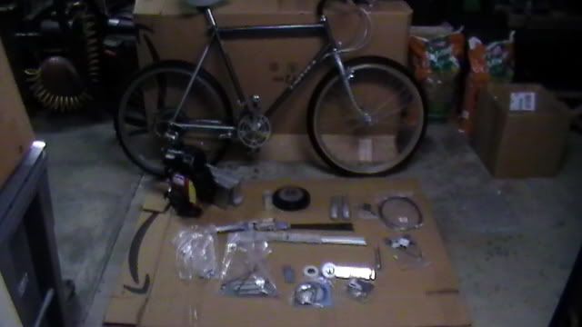

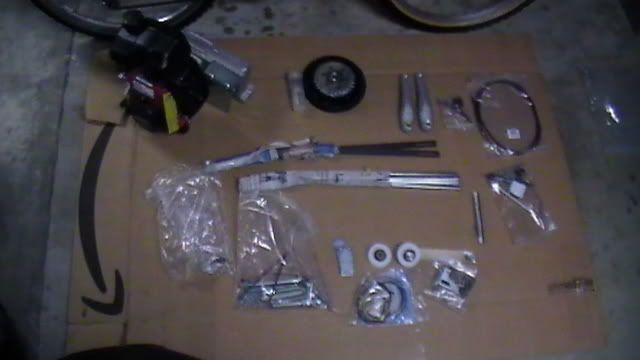

Fedex just stopped by earlier today to drop off a new Staton crankshift kit with Honda GXH50 motor and 16 to 1 gearbox, 14 tooth output sprocket, which I will be installing on an older Univega 21 speed bike that has some mid-range Shimano components, and will be used for some more extreme off road hill/mountain hauling, 400 lb. load capacities.
This will be my second Staton crankshift kit build and will allow me to compare differences between the Honda GXH50 and Subura 35cc motors installed on 21 speed geared bikes.
There will be a few other small variations to this second build, that I will document as I go along, and pertain more to ease of use and assembly.
All the pieces seemed to have arrived with the kit, so I should have a good 4th of July weekend putting the build together and testing its capabilities.........................Don
Bike and kit;

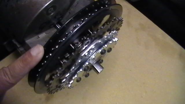

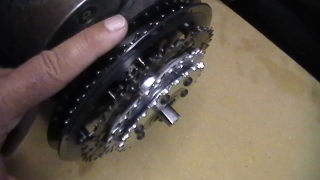

Staton now appears to have all the wobble removed (previous build and others have had excessive wobble runnout) from the complicated front chainring/freewheel/gear assembly, and the thing runs near perfectly true, I am very happy to see this since the fix requires alot of dis-assembly, realignment, and re-assembly work, yea!

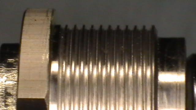

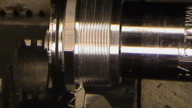

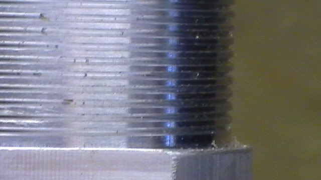

The sealed bearing carriers for the crank axle are still a problem, it appears Staton is still only cutting the threads to half the required depth and therefore the bearing carriers will not thread into the bottom bracket housing. Previous build and builds by others have had this same problem, Staton needs to re-program his CNC machine for deeper cuts on these threads.
So I had to lathe re-cut these threads an additional .016" on the diameter to make them fit to the bottom bracket, which is no easy chore when having to pick up existing threads especially ones with a left hand twist.
Photos show bearing carrier threads that are too shallow before being re-cut, re-cut on the lathe, and carrier threads after the re-cut that now fit the bottom bracket correctly;

I'm glad to hear there is no wobble to the sprocket but the bottom bracket threads are just a pain in the A!! I'm interested in how the honda works out.

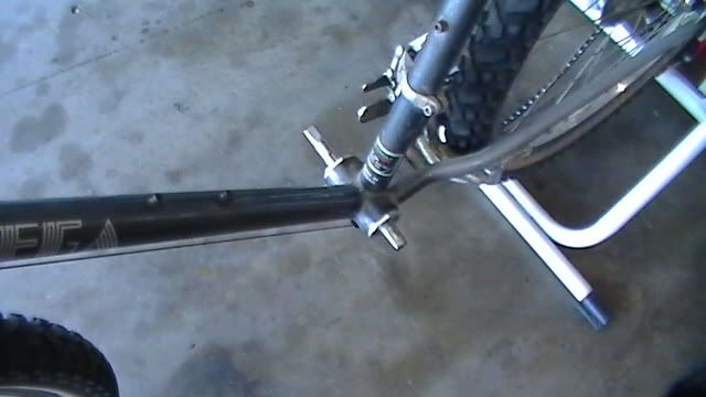

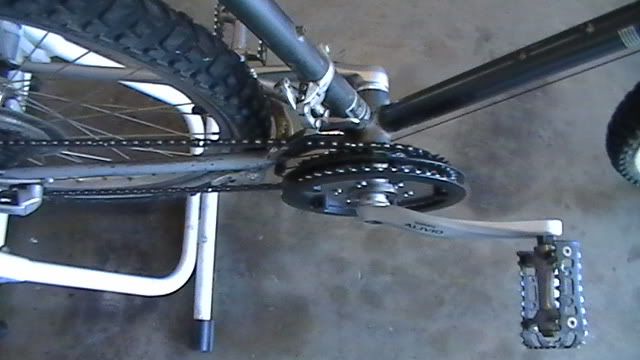

Succesfull installation of the re-cut sealed bearing carriers, crank axle, true running front ring assembly, crank arms, and pedals.
Surprisingly the front chain ring shifter works perfectly with the new front chain ring assembly, only requiring a slight adjustment to get a little more outboard throw to get the chain to shift to the largest ring.
Most time consuming problem so far was figuring out that I had the incorrect carriers identified, tried to install the left and right hand sides in reverse order................Don

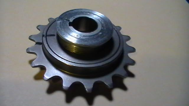

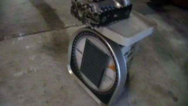

Well, the build has been going along just fine with the installation of the engine/gearbox, some small modifications to get these items tucked forward and as low as possible in order to minimize the high outboard appearance of the setup...............then ran into a major road block..........upon completing the rough installation of the engine/gearbox I decided to run a quick in-shop drive train test to see if everything was tracking and running properly, it was not.
Somehow the complex front chainring/freewheel assembly is not freewheeling for the motor drive side, causing 8 pounds (as measured with a postal scale) of drag force being transfered to the pedal side drive making the pedals rotate with the motor ring. The pedal side freewheel works just fine with zero drag.
Anybody experience this same problem and know of what I should look for to correct this situation?
Photos to follow................Don
dtj6ppc
Feb 23, 2011
61
redondo

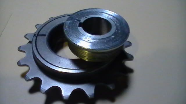

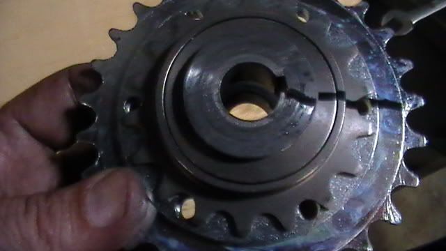

Problem component solved!...........key slot threaded flange backed out of inboard freewheel until it could travel no further due to making contact with big chain ring inner flange area thereby causing the 8 lbs worth of freewheel drag.
Not sure what caused the key slotted flange to back out, possible incorrect washer spacing allowing this flange to contact the bearing carrier which in turn spun the flange.
Or, maybe I was the cause when I requested that Staton not locktite any of the chainring assembly in order for ease of part replacement and repairs, maybe if key slot flange were loctited in place then it would not have spun loose, didnt think it necessary at the time because it all appears to be self tightening but this assemblys various movements are complex and hard to follow.................Don

Hi Max............I was the one to black mark the various chainring components since there are no self indexing features and if anything gets off axis then the "terrible wobble" comes into affect.
Again, the secret to no "wobble" is to assemble the entire chain ring installation on the keyed crank axle, that way everything is assured to be on axis when all the various bolts/screws are tightened, bearings inserted, and freewheels cinched.
