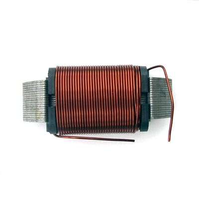

It's a couple of coils and a regulator.
* Msiert's pic enlarged, thanks for sharing.
One big Stator coil would work, they used 2 smaller ones.

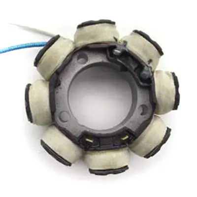

On lager engines like this one for a Honda 125, the stator has a series of 8 of these coils around the rotor magnet for tons of power like this.
The more coils you have, the more power it makes (and drags the engine) as the magnet spins around inside it, that's why don't see them on little engines, the Rotor magnet is on the outside of the flywheel/cooling fins for the CDI's magneto only.
All that is needed is just a Stator coil or two like Phantoms and a 12V AC/DC converter and regulator mounted where the magnet with spin.
This looks like as good as any place to find stator coils and 12V AC/DC converter and regulators.
http://www.rickystator.com/
A 75W coil or two like this for ~$55 should do the trick.

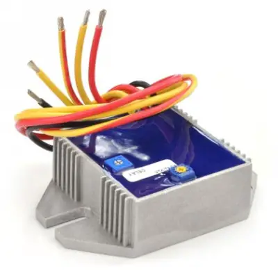

This looks like a fair price for a 12V regulator/rectifier for ~$55 as well.
75W / 12V = 6.25A max output current.
You'll never see that, there are losses at the regulator and RPM's will matter some, but you should be able to count on 4-5A regardless of RPM, at least as long as it's enough to make it into 12C DC.

This reg/rect works just fine no need to spend $50 for something meant for a 650 motorcycle. building one yourself cost about the same $4.50 for parts from radioshack, without being in a housing already.
http://www.ebay.com/itm/Voltage-Reg...Go-kart-JCL-/121441210733?hash=item1c4675d16d
