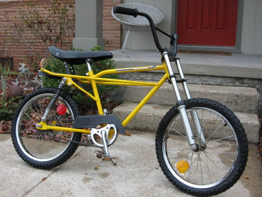

Mine had the raw non painted front shocks and yes it had the number plate, I still have the frame with rear shocks, the cranks and the handlebars and the original front wheel, everything else got stolen.
I'll post a pic tomorrow of the frame and yes the bikes were expensive back then compared to aother popular bike like the old Huffy Bandit bikes and such, I never seen another of the Yamaha Moto bikes in my town, everyone I knew back then were crazy about mine and my brothers Yamaha bikes, I did some jumps on mine that makes me still cringe today when I think about it, I took full advantage of that suspension many times...LOL!

Ok your bike must have been a 1974 model A. I had never seen one before in my town either. My dad who was a teen in that mid 70s time period had never seen one either. He had a cool Schwinn lemon peel back then. Sounds like you have the most important parts. Some of those parts are easy and cheap to replace. Unless you want the original parts which will probably be up there in price. Do you still have the triple trees? I would like to see a pic of your bike when you get a chance. How was the suspension on the Moto-bike? I only weigh 125lbs and my rear suspension seems pretty firm but soaks up the big bumps and the triple trees suspension is a little softer and gobbles the little bumps. Haven't came close to bottoming either out yet.

Here are the pix of the Yamaha Moto frame, I do not have the triple tree, it got stolen, I thought I still had the front wheel but I cant find it now but I found a rear wheel that I think may be for the old Moto bike, I have the Handlebars and the cranks and that is all I have for it, sure wish I would have been able to put this old bike back together some day but just not enough parts to put it back original.
This last pic here shows how mine looked when it was new, I'm not sure the cranks on this bike are correct though, the chain ring isn't like mine, but maybe there was more than one that they could have had.

Cool bike map and nice pics thanks. You are lucky to have that bike. You could always buy a ds-20 and use parts off it. It would probably be cheaper than finding the original parts. That last bike maybe a non-correct restoration. I'm not 100% sure but like I said earlier the 74 had metal colored front forks and no banana seat. Then in 75 they had the option of a banana seat but frame colored forks where standard. Also if I'm not mistaken the chain ring and guard look from a 76. I believe the 75 had a metal chain guard then in 76 it was black plastic like the one on the last bike pic. The wheels and reflectors as well as the other parts are period/make correct but could be from different model years.
