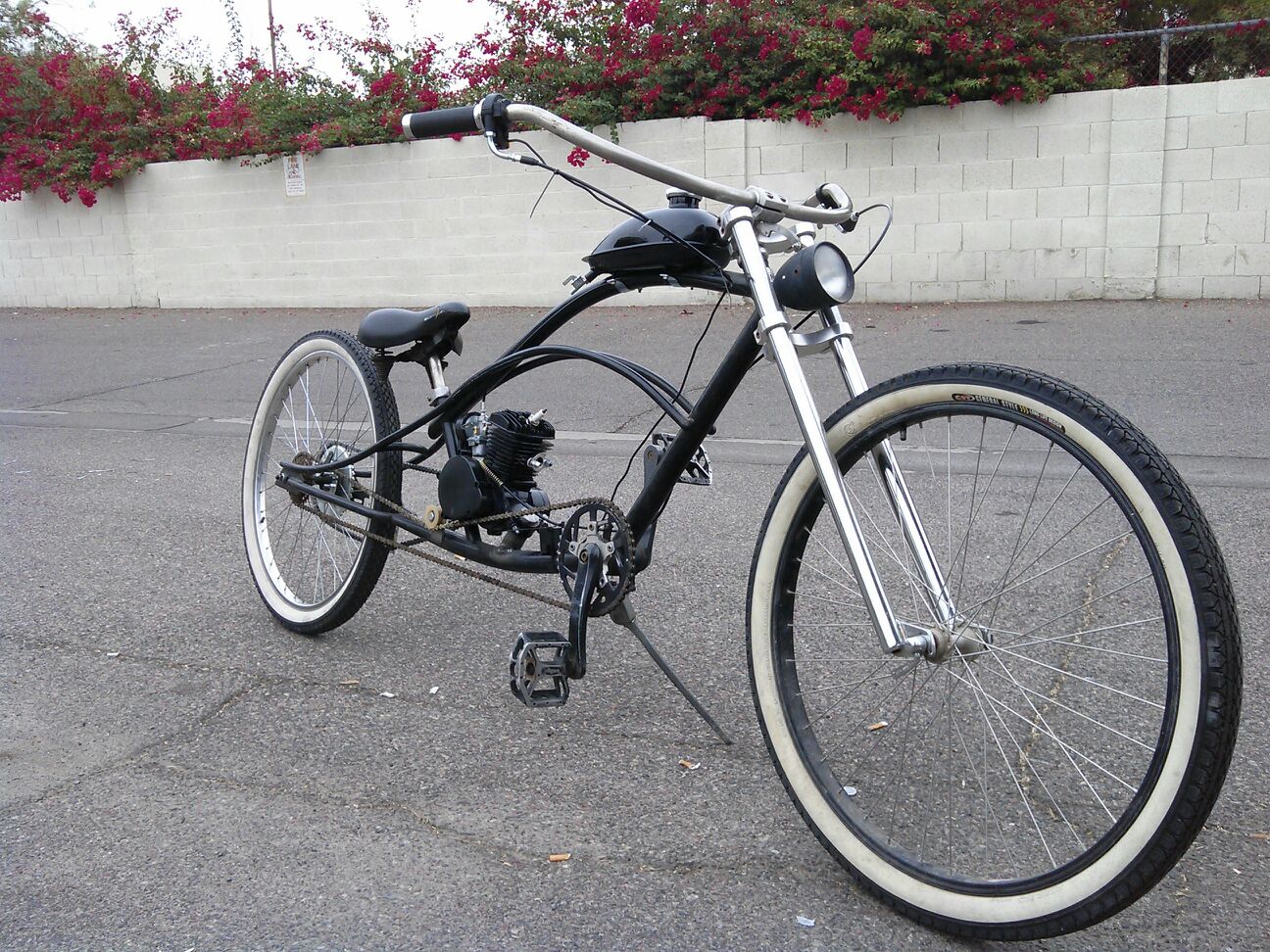

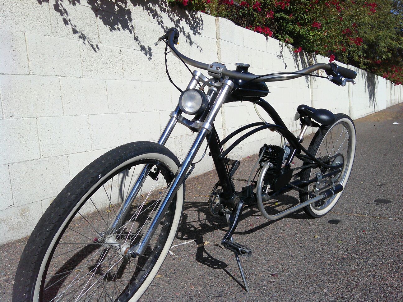

Have not been on the forum in a long time but thought I'd share a work in progress. Its a So Cal Kustom Kruisier I picked up for a big buck- rough shape but straight ya know. Needs paint and a few good miles on before that happens. Welded up an engine mount and some front brakes just to get her rolling. I welded the front brakes on the back side of the forks- had to have them since I dont do coaster brakes- pedal chain is on the first gear of a mountain bike type hub to make it easy to start while pulling my kid and groceries around. Took a lot of time to figure out the pedal and drive chains but so far so good- 10 miles is all. I'm really happy with the way it rides and its already pulling many double takes. This bike is big and is taking some getting some getting used to as far as turning radius. Will look nice when she is done.

Thanks azbill ! I really lucked out on the pipe- first bend and it fit like a charm- That never happens lol. Hope to paint by the weekend- just black- keeping it all pretty simple and hopefully reliable. I do love looking at your builds though Bill- art work plain and simple!

ilike it the front engine mount is a great peace and i like the use of the tensioner to make the chain clear and yes your exhaust rocks

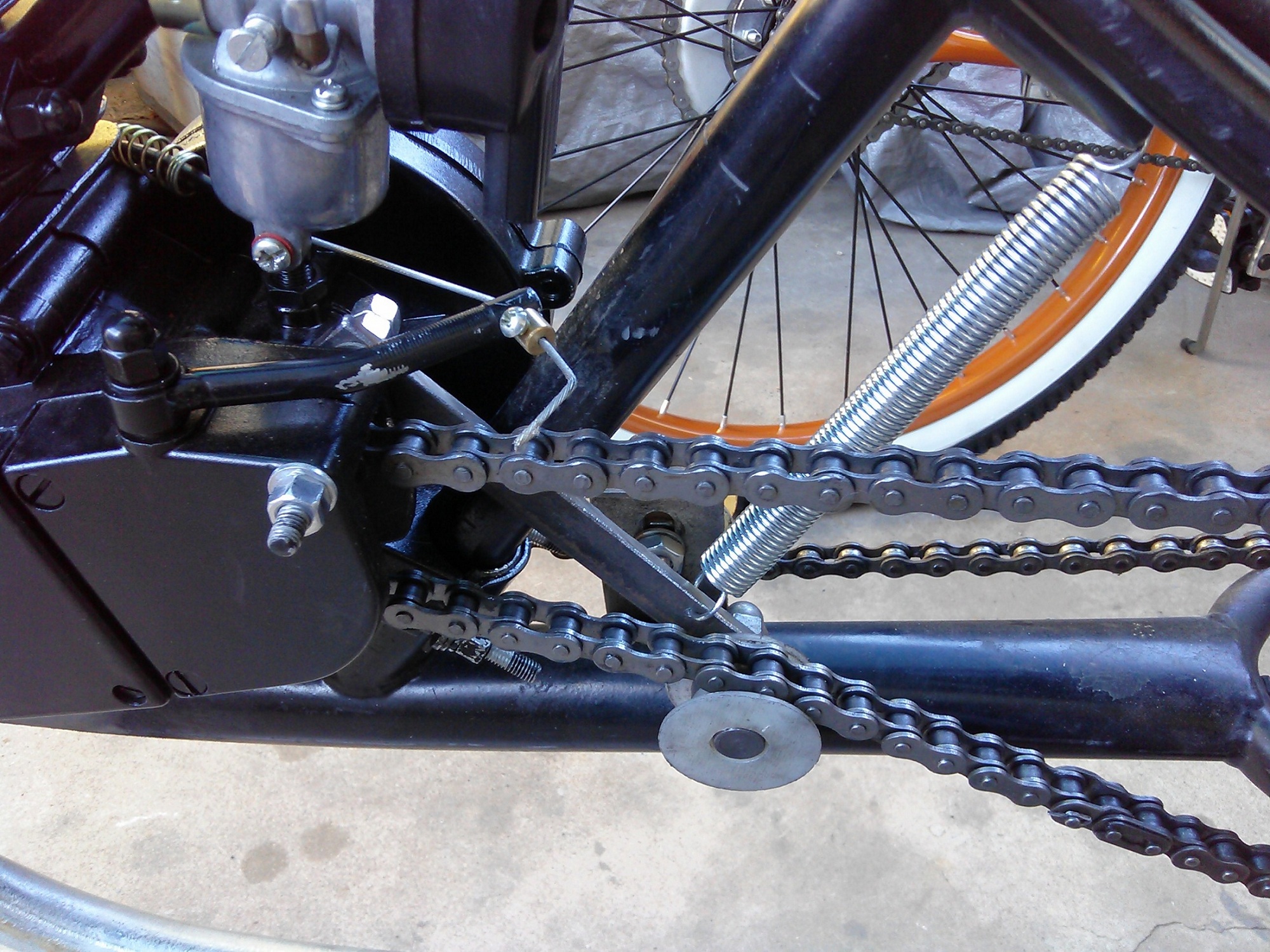

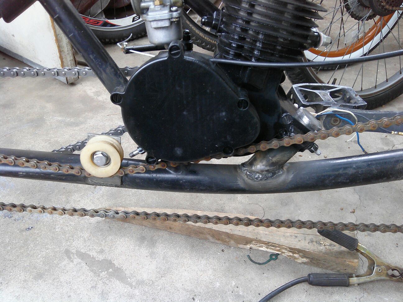

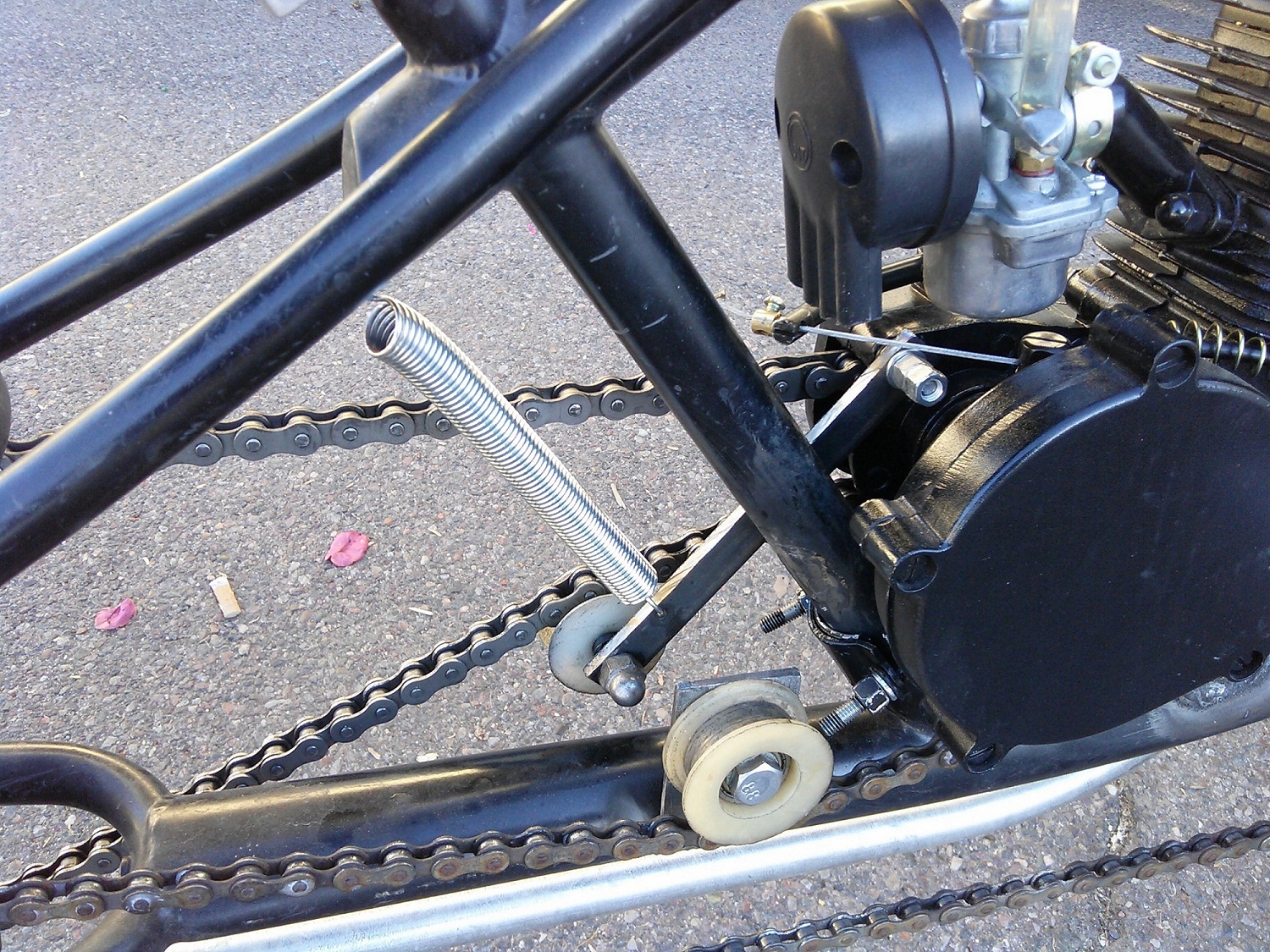

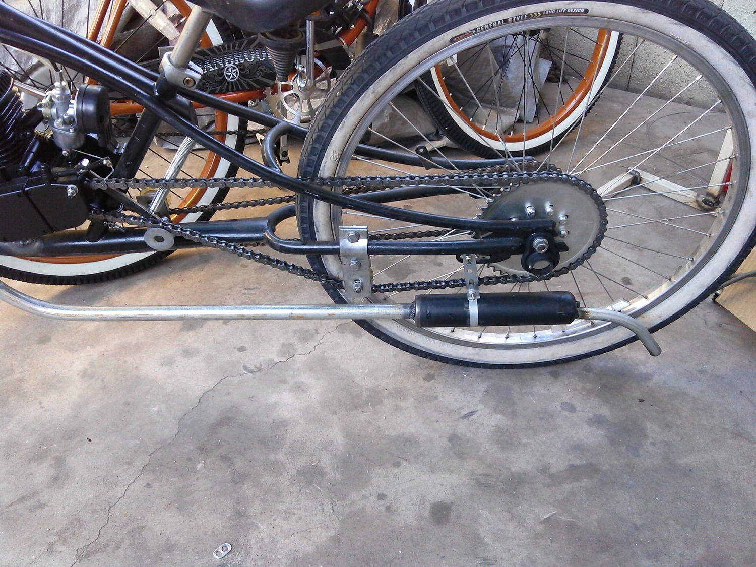

I was really hoping to have her painted by now but........... Turkey was good! So I have an issue with my chain, I ended up having to use a half link to get it where both the pedal and drive chains work but when the half link comes to the bottom of the rear sprocket my chain gets tight, once its on the sprocket about 1/8 of a rotation its normal. Kinda strange. So after I built another cranbrook today I messed with a spring tensioner- so far so good. I am still waiting for my KMC chains to arrive but the spring tensioner seems to work well. I also added a down spout for the exhaust, not sure if I like the way it looks but it keeps the exhaust fumes out of my daughters face when she is in the trailer. I get a lot of looks on this bike, I'm excited to get her finished.

Real nice, I like it. Nice weld job too. I'm curious about the pipe. How's it run with a long pipe like that?

After lowering the clip on the needle a notch it runs really well. I cant tell any performance difference good or bad caused by the long pipe. I like the way it sounds, its a bit deeper. I'm still thinking of putting an expansion chamber in there also and I might steal the high compression head off my mountain bike. Its gonna be awhile before its "really" done......
