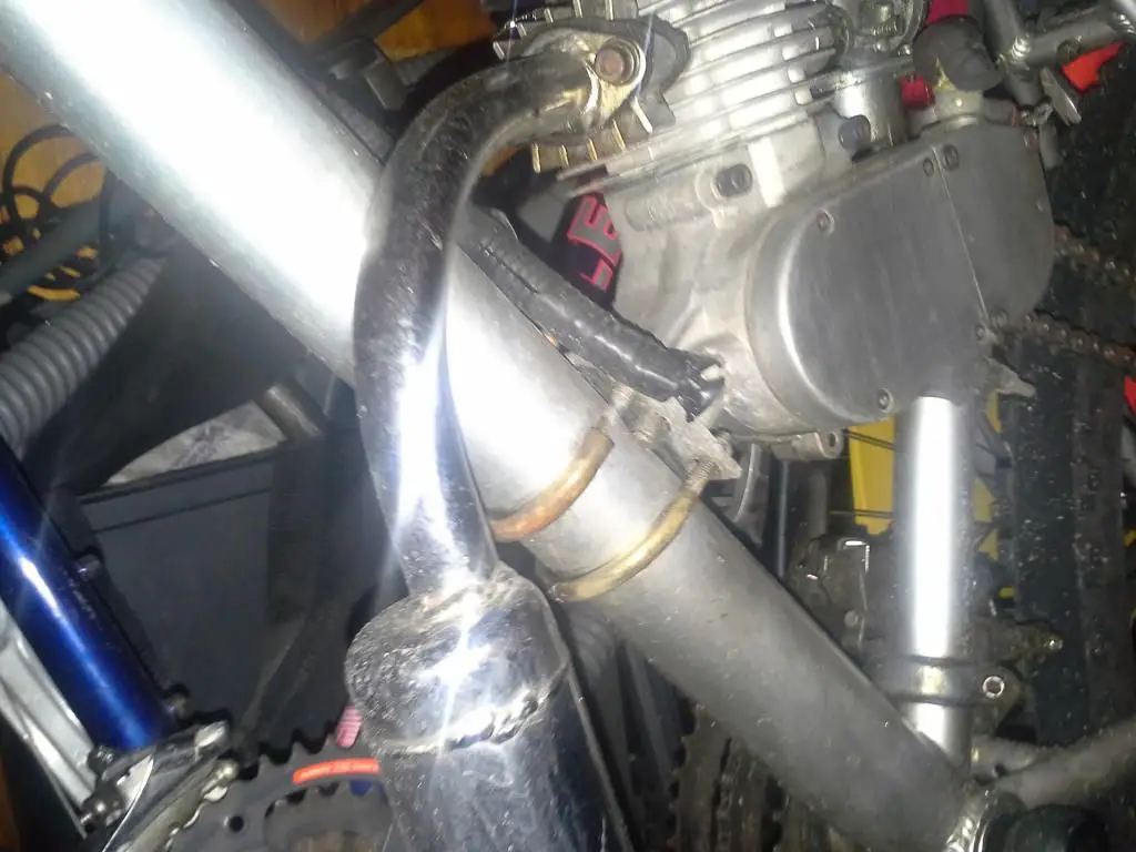

Most kits today come with 2 u bolts and a 2' X 2": piece of ¼ flat stock steel as an alternative mounting option enclosed is a picture of mine I hope you can use it to your advantage!
Jumpa
Aug 12, 2011
607
2
Cape Cod
2 smaller bolts are used to bolt the 2' X 2": flat stock to motor.
then the U bolts go into that tighten up & your done! No drilling needed I hat to see people drill their frames it weakens them considerably and also can let in major elements that rot the bike all inside it is a cancer ! TRY NOT TO DRILL unless you absolutely have to
