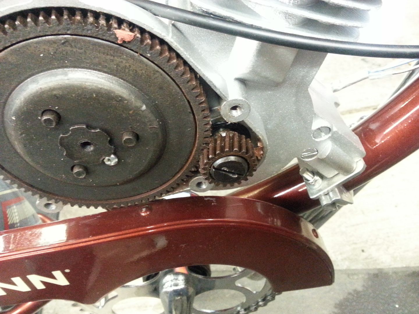

I ordered some 2 stroke motor kits from a supposed reliable supplier and what I received leaves me scratching my head.
First, The motors were rattle can spray painted nuts, gaskets, wires, everything. I called and they said send pics. I did and no response, so I went ahead and installed one of the kits. When trying to start all I heard was a grinding noise. I checked chain, alignment etc. and all seemed good.
I decided to look inside and found the crank gear not even engaging the larger clutch gear or maybe 1/8 in engaged.
Does this look normal to you guys?
Click on image for larger pic.
You can see the shiny crank shaft behind the gear.

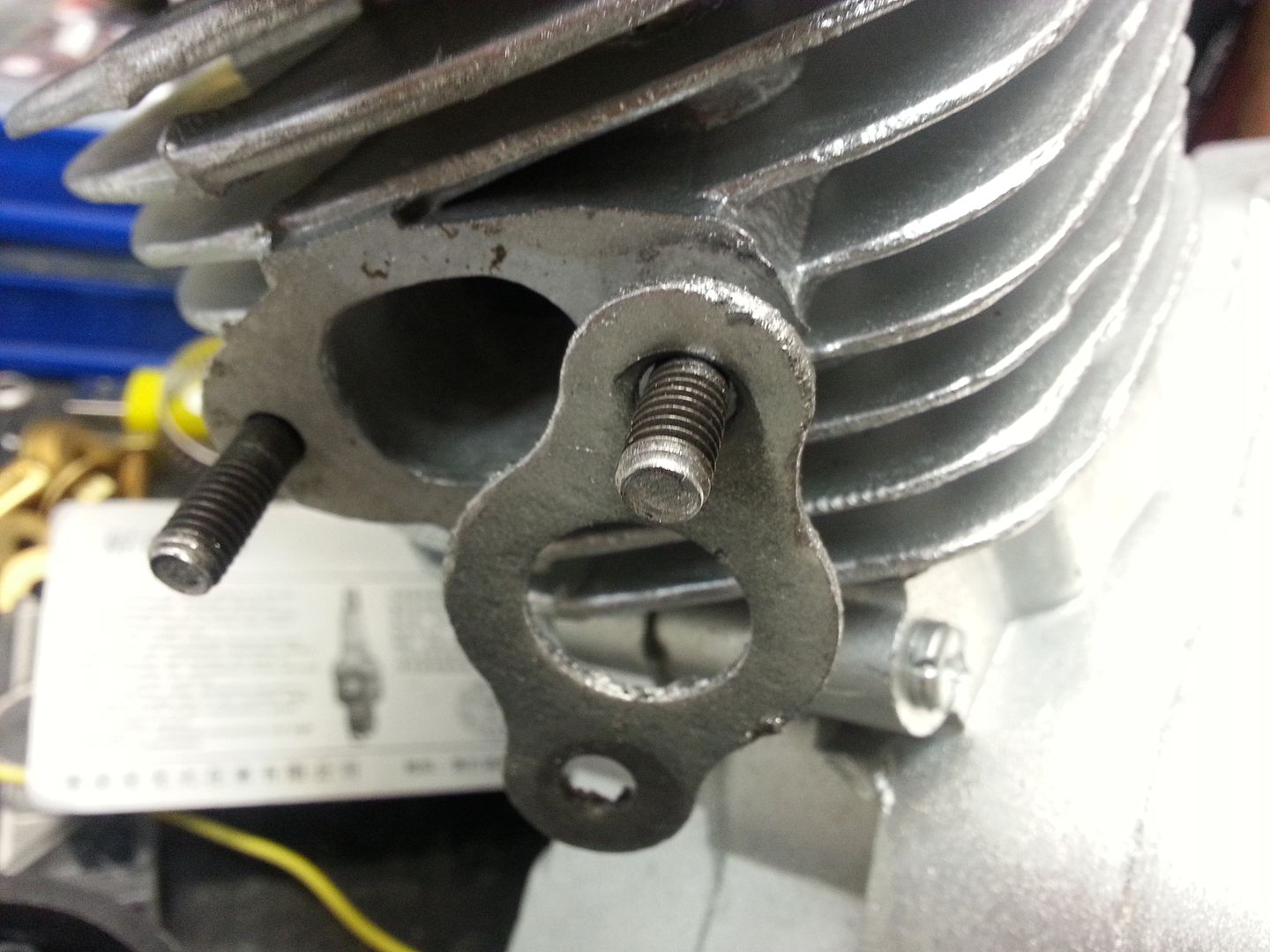

How about this spry paint on everything including wires and gaskets.

The spray paint is typical of the generic ht kits and the gear looks like an all-too-typical assembly mistake which is easy to fix as long as the key and shaft are not boogered up.

You take the mag cover off? That shaft may be out of whack.
As many times as I've had to futz with that crap on mine, your bevel gear is too far out.

Ya took it off had the mag side crank on an anvil. Did not whack it too hard, just enough to see if it would move.

Tried that. Even heated it with the torch. Just got a head ache from the fumes.
if you got your crankshaft very hot you ruined the crank seal on that side of the engine Pluto, and you are gonna need to replace that if you did, look at that seal real good when you remove the gear, if it looks melted in anyway you'll need to replace it, hammering on that gear may have destroyed the inside edge where the thread are that the puller has to screw into so you can pull it off......
if you can manage to get it off now you may also need to go ahead and get a new one.... never hammer very hard or with a heavy hammer on the crankshaft of one of these little engines, thats a recipe for disaster.....!

Kinda figured that. Prolly what gave me the head ache. At this point I think this little soldier is gonna be donating it body to science. There were other parts missing as well. Don't plan on BIKEBERRY doing a damn thing about it. They are thieves in my book.

Ive also bought several from "Mingsinternational" and one motor had a similar gear issue he "Ming" said to just send it back but I instead decided to fix it myself rather than wait half the summer for it to come back, besides it only took me like 20 minutes to do and that motor has turned out to be the fastest , strongest motor out of the 7 kits I have bought From Ming .

One of the single motors I bought from Ming had a similar issue the gear was out a little but I just tapped it back in and tightened it down but like he said make sure the key way is not binding prior to tapping it in .."If you decide to go that route" the price of these motors and the frequency at which they make them we are bound to have a few snags. Either way you still shouldn't have to wait for a response especially after he asked for photo's BGF also took forever to get back to me but they eventually did
