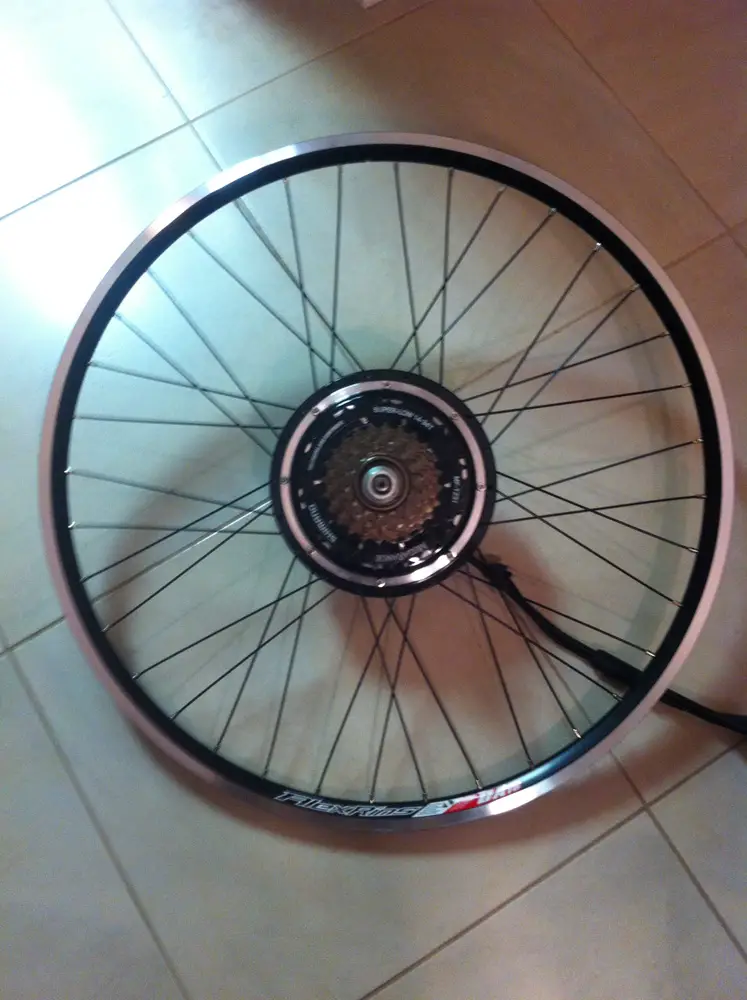

i was able to get mine done way out here in the middle of the atlantic. any bicycle shop should be able to do it for you. i used an alex da 16 rim and ordered stainless black spokes for it
