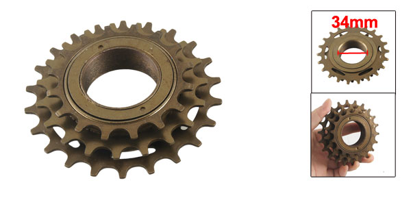

On my Staton hub a left side freewheel can be attached to it. So that multi freewheel may work with a left side freewheel hub. The question then becomes which setup would work best (multi left side sprocket vs shift kit). One that you must get off the bike to change (multi left sprocket) or one which can be changed while riding (shift kit). The other question is what's the difference in expense. I don't know how much that multi freewheel cost but a Staton hub or one of similar quality is close to a $100. And it still has to laced up. For the amount of money spent for a left side multi sprocket setup a quality shift kit could have been purchased. This being said thinking outside the box brings about better ways of doing things.

If it's left hand threaded I think it won't, I hope it works on my sbp freewheel crank hub, if not it was $12 so no biggie. BMX and tandems, and maybe your staon hub have the option of LH drive with left handed threads so it doesn't loosen itself. You might be able to find a left hand threaded cassette for a tandem if you're lucky.
