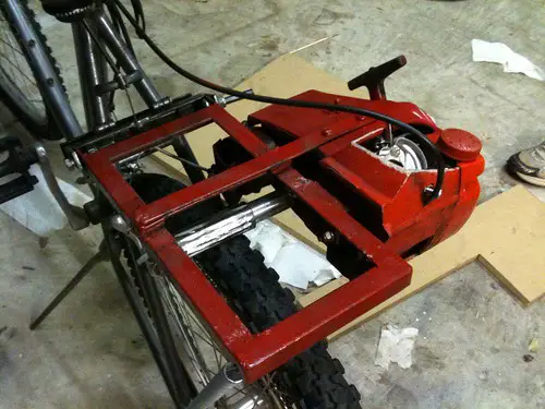

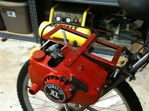

i did my research and decided to build a friction drive, mostly because of decon's sucess with them and their lack of points of failure
so i fabbed up a mount out of an old realtor's for sale sign (grandma is a realtor)
next i used some scrap plate to build a motor mount
there's two mounts. the first is attached to the original bar mount (this is a bomb proof mount in my humble opinion)
the weight of the engine and the shocks of riding bent this mount a tiny bit so i added an upper mount for support that threads into the aluminum head case
the spindle is a 1/2" schedule 40 pipe welded to the shaft. around that is a 3/4" schedule 40 pipe ( i added this to make the spindle bigger)
I took it out today on a six mile maiden voyage to my girlfriend's house and it rocked!!! it worked so well
i cruised at what i estimate to be 25 mph no problem.
but thats about it
take a look
criticisms, comments, opinions, and praise will be gracefully accepted
