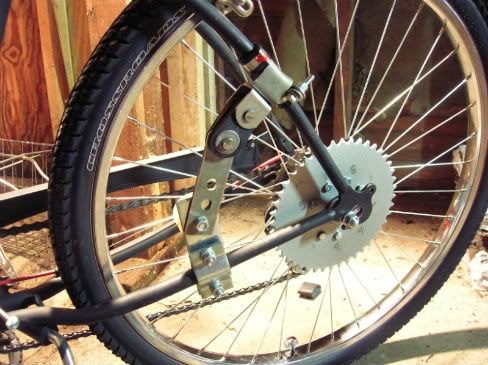

I have one of the stock tensioners with 4 bolts and it enjoys playing in my spokes. Does anyone sell a tensioner that has 2 brackets for mounting. I really don't want to drill thhe frame. 10months of work ends with an eighth mile of run time and a ruined wheel. :-||

I think (and that could be dangerous)
If you set up the tentioner so that it is hinged to pivit,,, yet have a stop built into the botton so that it cannot spring down past normal setting ,,and a safty bar that is attatched to the pivet bar/wheel that extends below the chain stay and above the seat stay on the out-side ,and can move w/the tentioner wheel,,,,add a spring from the tention wheel piviting bar to the seat stay,,,,,,It looks good in my idea note book,and solves the chain allowing too much slack when starting the motor ,and keeps the tention wheel out of the spokes w/the safty bar ,while keeping spring tention against the lower chain playing while moving foward !!!

This is great, If I can mount it on the stock bracket, I can have the springy part point backwards and keep the bracket on a thicker part so it won't slip, Thanks so much I might have to order this after I get my wheel respoked.

ive tried adjustable ones my advice dont bother even with a stopthe forces involved would cause problems use a solid mount.. theres no real solid way to garan tee other than drilla hole though tthe stock one though your frame or to weld a tab with a sliding hole..
a bold on one is dangerouse i found that out mine went into my spokes luckily i was only doing 5 mph if i was at 25 i would be dead...
im also looking at a shimaro derailer spinner thingie it has plastic teeth maybe that would be better who knows i got a free one from a bike shop today im going to see how it works

has anyone tried putting rubber around the chainstay tube. my tensioner used to move around too. i wrapped the tube with rubber and now no more moving.

i woulndt i tired it and mine went into the spokes rubber even though tightend down will move.. but your best bet even though it will mar your frame is use the thing like stock and drill a hole though the center though your frame that way it will never ever go into your spokes.. these tensioners are pieces of you know what ive seen other methods like sprokets used etc i just cant find the thread where a guy did it:-||

Seriously, I've gotten rid of the tensioner all together amd just shortened the chain to a perfect length and it works WAY better than the cheap tensioner that came with my kit.

I agree except there is some bike frames that simply do not offer chain clearance at the rear stays with out the use of the teinsoner.

There is interference issues w/some frames as Goat mentioned, there is also those that ride so constantly that "to take the time to mount & shim the engine to get the proper tension" simply isn't a feasible or even reasonable option.
For example I just replaced the #41 chain on my beater, which means ofc that for the next week or more I'll need to readjust the tension frequently as the chain and the sprockets wear into each other ("chain stretch" as it's otherwise known) and even after things settle in and despite the fact it's a heavy duty industrial chain, I ride constantly - enough that a minor chain adjustment/tension is required roughly once a month.
So, as potentially problematic as a tensioner/idler may be, honestly I simply can't imagine how messing around with shims to remount the engine & all that entails (critical stuff like chain/engine/frame/tube alignment, fastener torque & safety etc) just for frequent yet minor chain maintenance is in any way practical - TBH I can only see that as a solution for bikes that just don't get ridden very often and one that has it's own hazards as well.
In fact one of the few things that's irritating with my other build, one w/a shift kit & 3sp hub is the lack of such easy chain adjustment an idler provides - while it has 1/2 links and horizontal dropouts so chain adjustment is still pretty simple (don't hafta mess w/engine mounting), I still need to reposition the rear wheel to adjust, which means I hafta double check wheel/frame alignment and axle nut torque (safety issue again) and might even need to add/remove a 1/2 link - all of which is obv more involved than simply loosening one nut, moving it up a hair & retightening it.
So, while obviously this is a personal preference and whatever works for you is defo good enough - stuff like chain routing and idlers is so specific to individual frames and the rider's usage there simply isn't only one "correct" answer, wondering - even telling people to not run an idler based only on your experience with your bike is hazardous, you simply can't know what's best for them.

I never use any chain tensioner. They always want to play in the spokes..
I use an aluminum tee shirt..
A spacer made of aluminum plastic or anything else that wiispace the back of the engine one half chain link forward.

The ceapest and easyest solution is to use an old handlebar grip that you had to remove to put the kit grips on. Cut the end off then split it to fit the bar that your tensioner is on. Put your tensioner over this and tighten. I don't know what these grips are made of but they really stick to metal. Once done the tensiner would bend before it would move. Cost .....ten minutes work.
