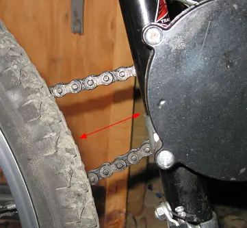

In order to shoehorn the motor into the mountain bike frame I chose for my first build, I needed to cut the rear motor mount spacer down to a mere 1/8 inch;
Obviously this didn't change the distance between my rear tire and seatpost any, it's still 2 1/4 inches (where arrows indicate) but you can get a good idea of how much further back my motor sits in this pic as the rearmost curve of the clutch cover is almost flush with the back of my seatpost;
So my question would be, how critical is this spacer supplied with SBP's shift kit? Is this something I can leave out of the build without too much trouble? Do the sideplates for the jackshaft rely on the motor mount to be an exact depth?

Per our web page:
8. have more than 1 1/2" clearance from the back of the seat tube to your rear tire
And you say:
Sounds like you are golden! .shft.
Click on Requirements for using the kit
You can't leave the block spacer out and gain anything in the correct direction. The sideplates don't really care where the motormount plate is, other than the right one is attached for stiffness. But again there is no need for you to change anything..flg.

I'm sorry. I must have worded that poorly... It isn't the tire and seatpost (I perhaps shouldn't have included that pic) It's the lack of room between the engine and seatpost.
Due to the engine's placement I don't have enough room for the spacer provided in the shiftkit. I believe I do have enough room without it, the plate itself is about the same thickness as the clearance I have (see second pic) - but if that spacer is crucial then I can't install this kit as I can't move my engine enough to accommodate it.
Thanks for your prompt reply though ;)
Your spacer;
My lack of room;
(arrow tip indicates edge of cut down stock spacer, approx 1/8" clearance between engine block and seatpost)
"The sideplates don't really care where the motormount plate is" <this fills me with hope! *crosses fingers* :D

With a non-adjustable front mount there will be no way to move the engine to adjust the jackshaft to chainring chain tension. I am not saying it is impossible to adapt the Shift Kit I just think it would be a lot of work.
All you really would need is a different frame. The rest of the bike is nice. Things to consider when looking for a compatible frame are headset type and diameter and rear brake type and of course if the engine will fit.
