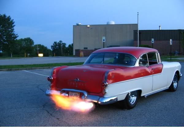

I had one on my truck. All it was, was a spark plug in my exhaust and a black box with a button. when you pressed the button the power would be cut from the spark plugs in the engine and sent to the one in the muffler, where the unburned fuel would light. It did blow up my muffler one day. i wasnt even messing with it. i was on some back woods high way. and boom sounded like a 12g in the cab went off. I about s&!t my pants. Im sure I installed it wrong wires were touching the hot engine and causeing problems.

You could probably tap in a switch so when you hit the kill switch a plug in the exhaust would spark and then engine would throw gas into exhaust.
Would maybe want to put a switch before that wire.
Like run two CDI's, I believe kill switch just cuts one wire to CDI, so if you ran two, but when you push the kill switch it grounds to the 2nd. Then add a swithc so your not always throwing flames when killing the engine, unless thats desired.
No idea if that'd work, you also need oxygen in the pipes for a good flame.
