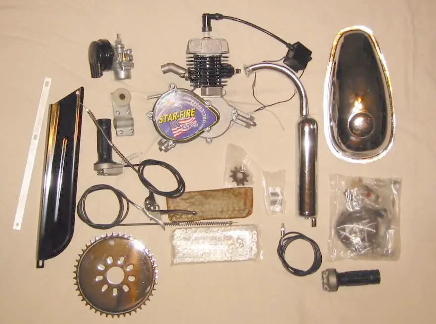

i dont know i saw it on ebay description said starfire gt-3 so i snaged it,is it the real deal wont know till i get it. prob just another motor,you know ebay buyer beware.
Starfire GT 3 is a 55 cc motor and must be old stock by now
as they haven't been imported for quite a while.
They weren't very common but they are very good motors.
here is what the kit should look like.
