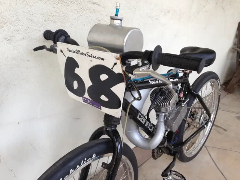

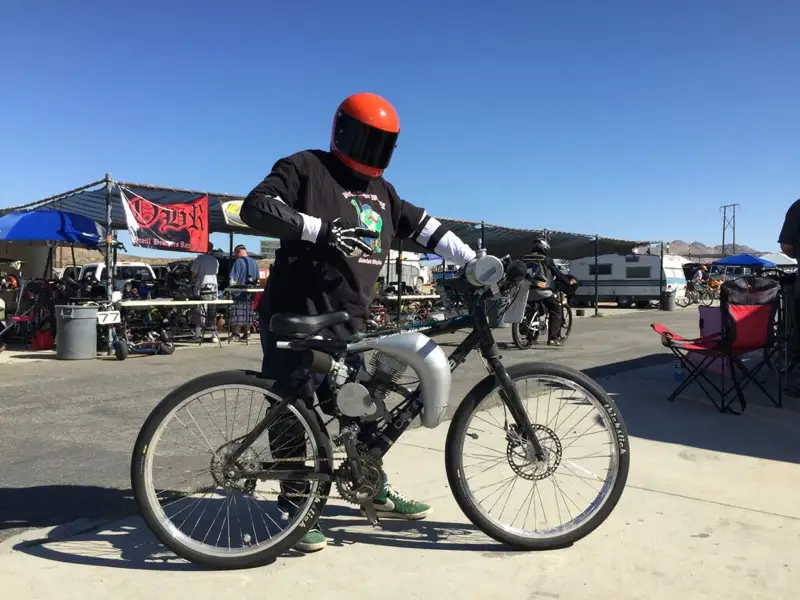

My personal race bike uses a hydraulic 200mm front disc brake & a rear coaster brake (it stops great & it's one of the fastest bikes on the track).
Honestly, a rear coaster works plenty well for these bikes as long as you have a good front brake. ;)
If you're h*ll bent on having a rear disc?, look for a quality brand for both front & rear. (^)

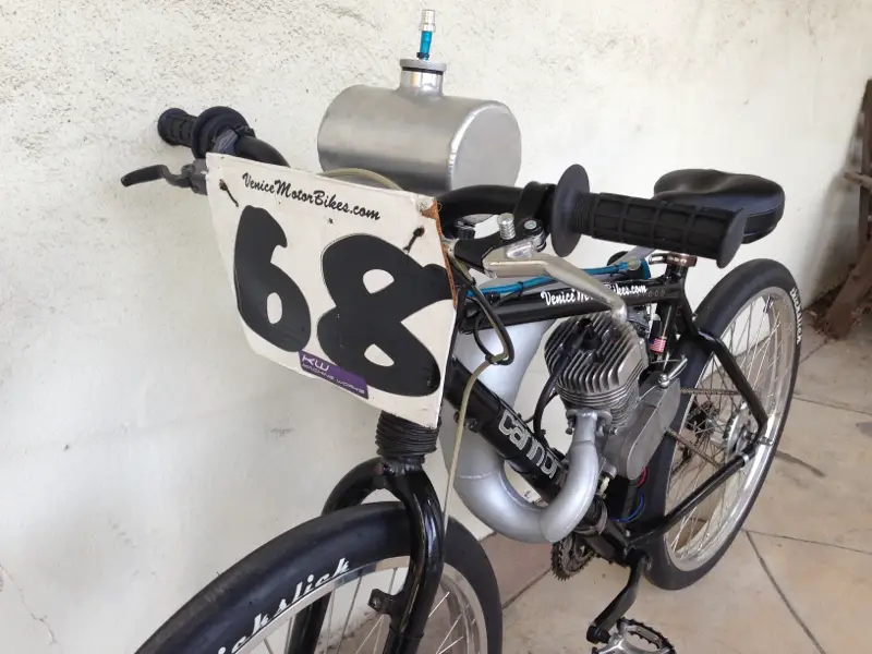

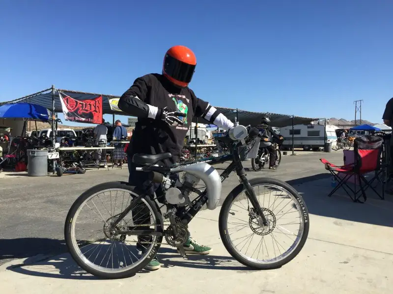

No disrespect intended, but I highly doubt that you'll be making anywhere near the power of the real 'Pro' bikes... There's a lot more to making these engines powerful than just bolting on a few parts.
