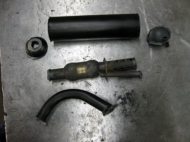

Ever wonder just what was inside the newer style "catalytic converter muffler"? The one with the domed endcap & welded together so ya "can't" take it apart?
Well, I did lol and as I needed the headpipe for a different project I figured I'd go ahead and chop up the rest of the now-useless muffler ;)
As you can see the exhaust is forced through the catalytic converter unit first with no possible alternative route - then it's allowed through the baffles, exiting only after a convoluted S turn to be able to go out the tailpipe.
Verdict? Drill away as much as you want on that endcap - while you might make it slightly louder by bypassing the tailpipe, you will not see any significant reduction in back pressure as the exhaust will still be forced through the honeycomb and the baffles. Additionally as 2 strokes are known for carbon build up - I'd bet that honeycomb would clog up pretty quick.
Solution? Don't waste yer time on the thing - if yer after performance, get an expansion chamber FTW

Just a quick thanks for the "biopsy". I have the older style but this is still interesting and informative.

Aye ive got one of these from BGF. i removed hte disc from lower end. left everything else in place. pulls harder i notice. and top speed isnt hardly touched at alldrn2

These black mufflers use pallidum instead of platnum and is much cheaper but does about the same thing. I drilled the small inside holes toward the cap larger,works better but also a little more noise.
Also heres a pick i found of one cut in half.
