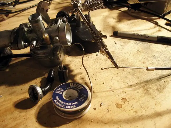

Hi, I have a CNS2 carb on a Grubee GT5. I want to adjust the size of the throttle cable (shorten). Rather than using Norm's cable shortening method, can I use a small cable crimp on the end? I have some tiny one here. Not sure if there are any issues I should be aware of.
Second, when shortening the cable housing, do I absolutely need to crimp a new cable ferrule on the end the shortened cable housing?

As long as there is no interference and the crimp is done correctly it should work. Crimped/swedged cable ends have been used in industry and aviation for years.
You have little to loose by trying it.
Let us know how it works for you.

Crimped or not, a dab o'solder will provide peace o'mind ;)
As for the ferrule - it all depends what the housing is going into, if the hole is larger than the cables inner core it might cause problems by pushing back the outer housing... but that's rare.
