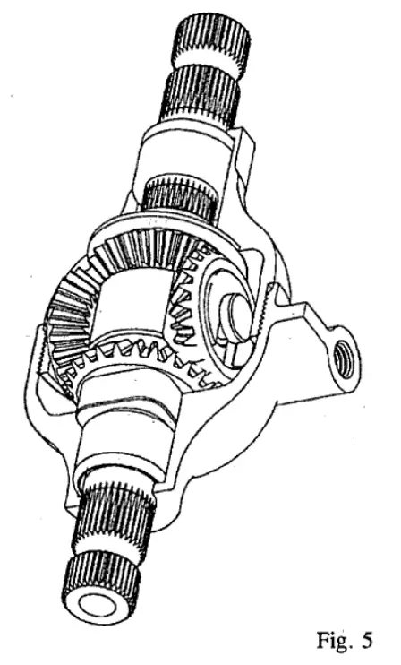

Just needs some re-engineering to lockout the planetary section to provide 1:1. Any ideas?

I chanced upon a google image of a "steering quickener" and was intrigued. It's a compact, very robust, lightweight, coaxial gearbox that is available in 1.5:1 and 2:1 ratios. There are a couple of other ratios but they are rarer.
Now the application of this as a dual-range gearbox would require some re-engineering. That's the fun part. I can see (see images below) where a shift fork or simple cam could be designed into this that would lock out the planetary gears and give 1:1 for high speed selection. Shifting it back to 2:1 (for instance) would make it low speed. Ideas would be appreciated. I'm going to buy one of these and work on it in the shop for a while.

The one I imaged previously is only slightly larger. Very robust input and output shafts. The one imaged above is of the type described in that patent .pdf as "previous art". It utilizes a spur gear input running inside of an internally toothed ring output. Cool way to make a gear reduction ultra compact. Despite the photo appearing otherwise, it's not truly coaxial. The slightly larger unit uses the two planetary gears and is truly coaxial... which lends itself to the possibility of locking out the planetary stage for 1:1 "high" gearing.
I'm not an engineer so these might be wildly inappropriate for anthing exceeding a few RPM (what would be expected in automobile steering). Only experimentation would tell. But they're so cheap and appear to be so well built that it might be an interesting gearbox to mess around with.

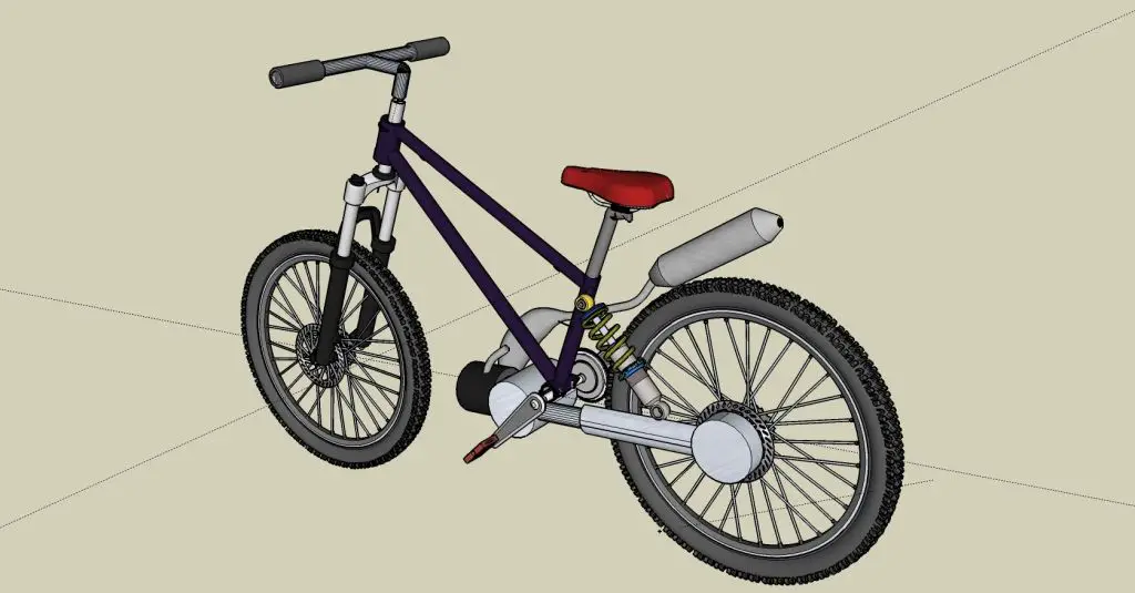

To explain my interest in this specifically..
..I'd like to find a very compact coaxial gearbox like this to incorporate into the swingarm/driveshaft of a QT50 like so...
(google sketchup drawn to scale with Yam QT50 motor/shaft/rearhub, specialized mountainbike frame, 24 inch bicycle downhill rims).

With the OEM gearing on 14 inch moped wheels the QT is good for about 0-30. With the driveshaft lengthened to accomodate a 24 inch bicycle rim/tire (roughly equal to a 17inch moped rim/tire) it should be good for 35 to 40 with lightened frame, rims, and tires. A gearbox on the driveshaft, selectable from 1:1 to 1:2 would provide a perfect low range for (very) light exploring off-road.
