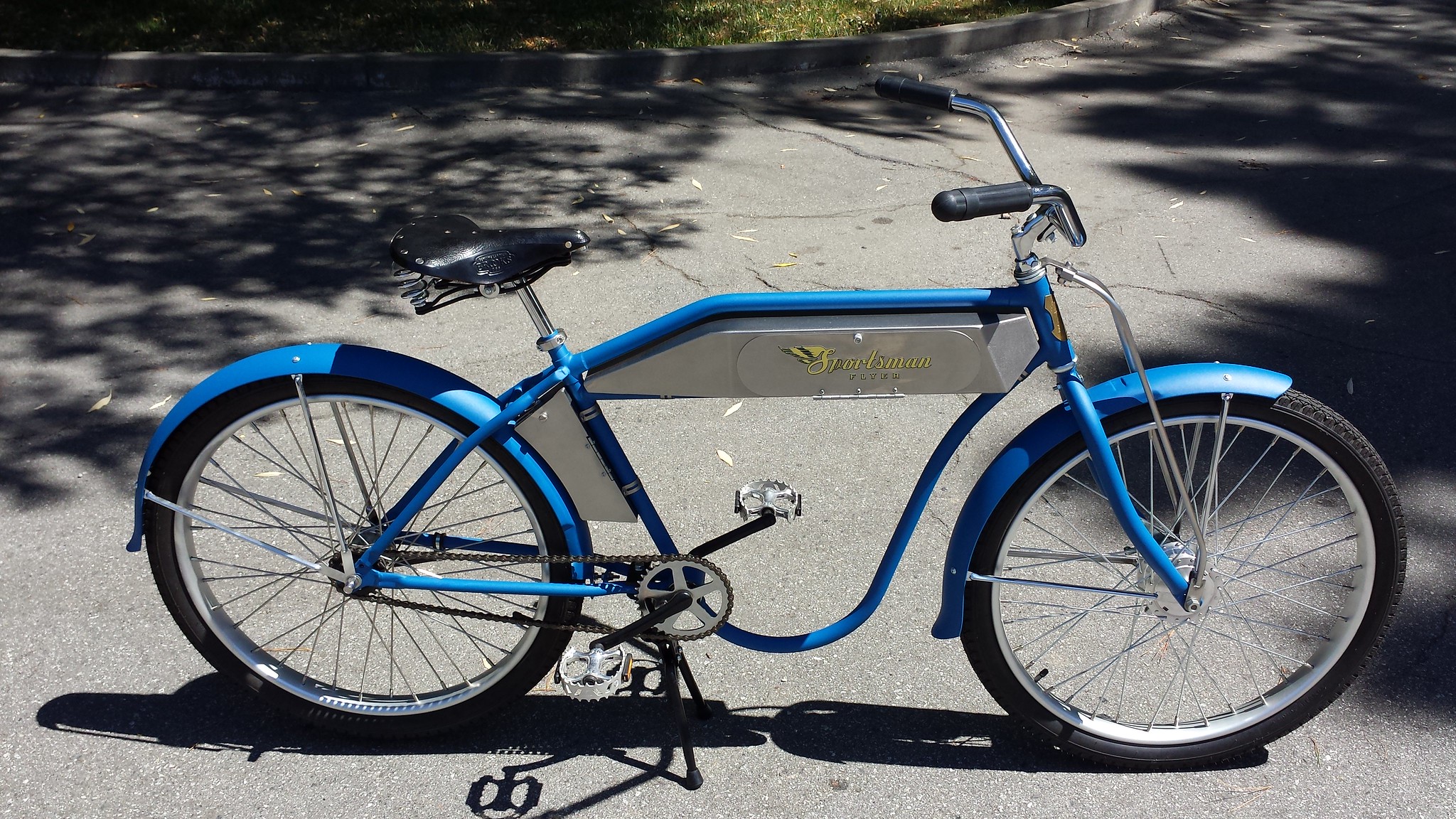

It's been awhile since I did a build thread. Recently I traded off one of my favorite bikes, a Sportsman 80 that even had one of the discontinued Harbor Freight 99cc engines. It was worth the trade as I kicked down the bike and cash to a friend of mine for a 1949 Ford F1 pickup. The bike was a beautiful machine with the best of everything. I rode it to work, all around town, and did the 90 mile Whizzin ride a few times. So, time to replace it with another work horse.

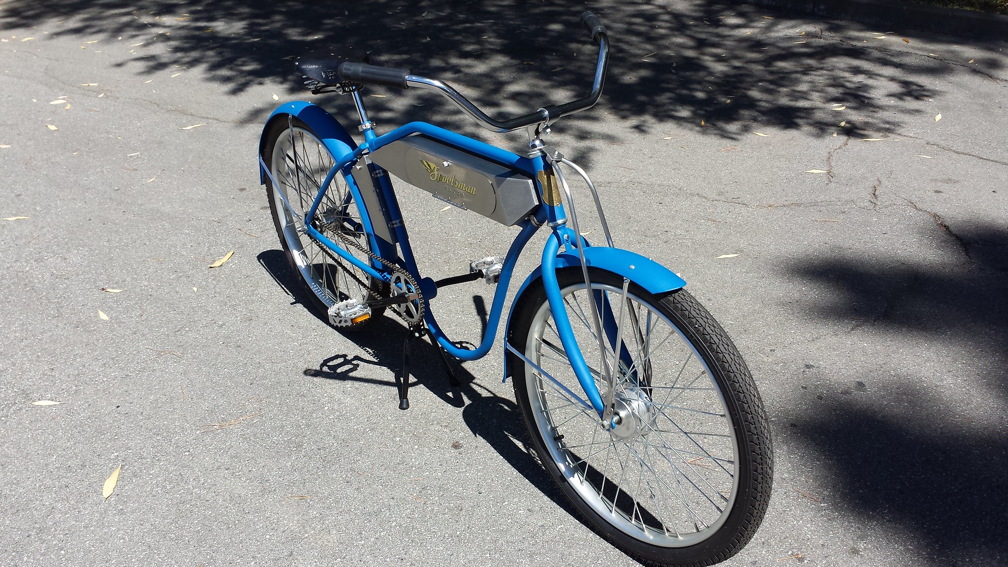

Here is the starting point, a Sportsman Flyer pedal bike which I call my "Super Cruiser". It started life as a no option Worksman Sportsman Flyer to which I added truss forks, panel tanks, fenders, and a Strumy Archer two speed kickback coaster brake hub and Brooks saddle. I pedaled this clunker to school (yep, school) twice a week and even stuffed my homework inside the panel tank compartment.
Sportsman Pedal Bike by Pat Dolan, on Flickr

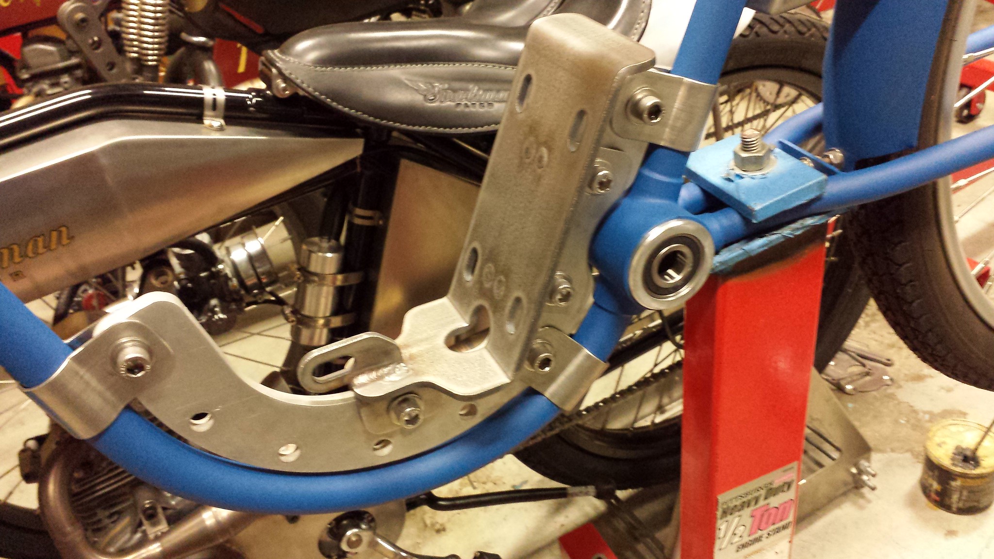

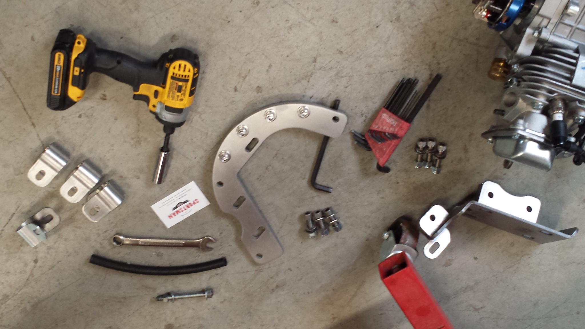

Here is the engine mounting system and a fresh Harbor Freight 79cc four stroke. I set the engine up for the application by making a few mods.
1. Take stock engine and remove ALL external components.
2. Remove side cover to access internals and then remove the engine governor system and plug the holes.
3. Drill side cover for oil fill point.
4. Add stiffer valve springs.
5. Clean up the outside of the case to remove a few engine castings no longer necessary.
6. Add a proper clutch assembly designed for correct output shaft size and street rpm range.
Sportsman 80 by Pat Dolan, on Flickr

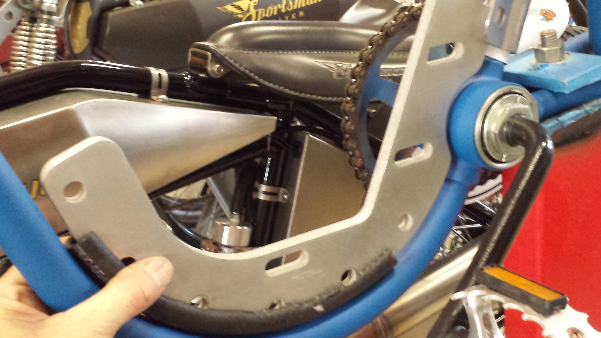

I like to take a piece of rubber hose, split it, and use it to properly space the engine mounting assembly with an even gap from the drop loop. This also keeps me from scratching the paint. The engine cradle, as I call it, is water jet cut from 3/8" aluminum plate.
Here it is clamped in and ready for the adjustable secondary mount. Notice how this main mount ties in all the frame tubes. It is a structural member and ties in the downtube to the seatpost tube without touching the bottom bracket. Solid. This mount isn't going anywhere.

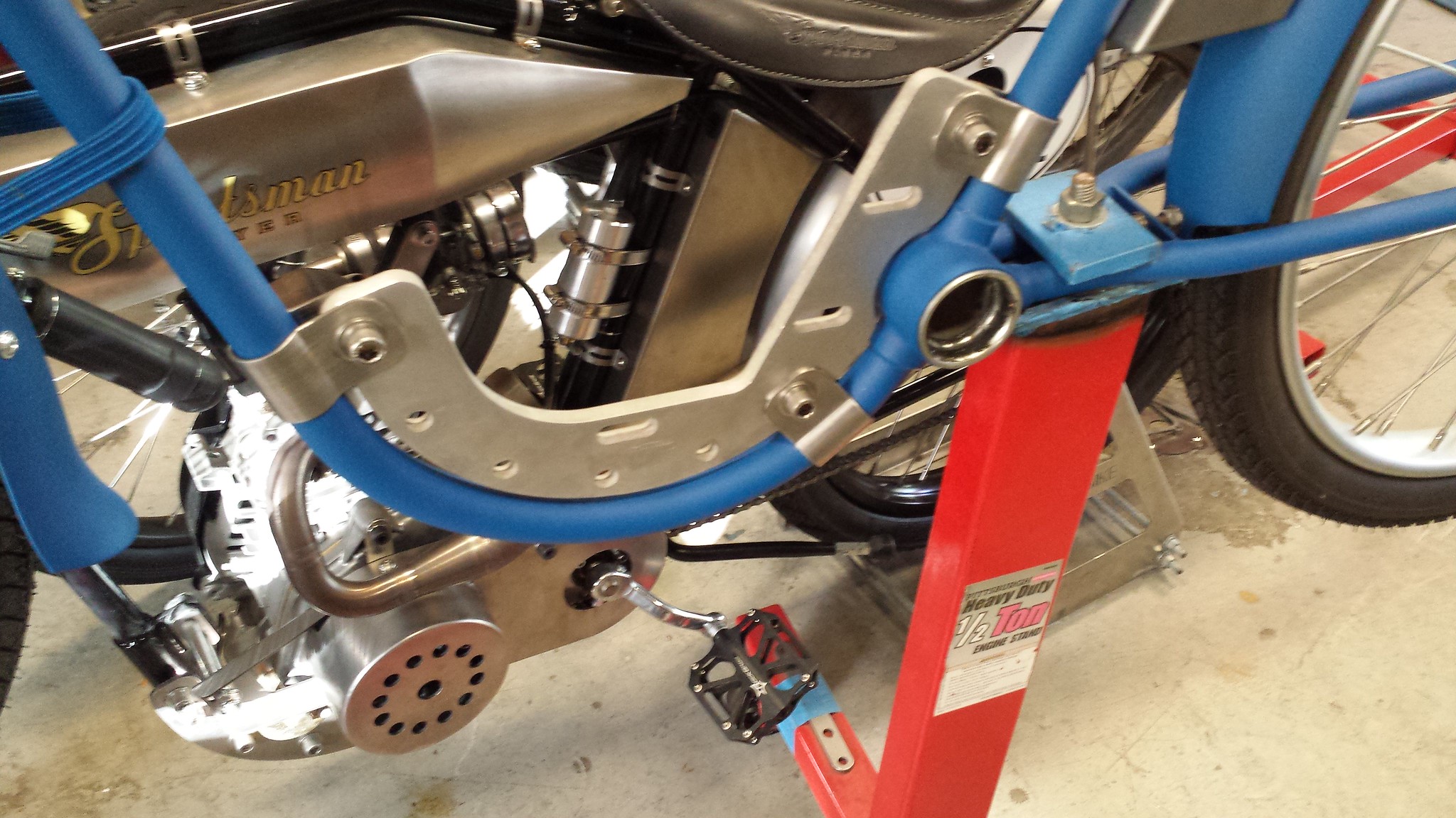

This photo shows the secondary engine mount. The main mount is fixed in position and this next mount carries the engine and has a full range of front/rear adjustment to allow for primary chain adjustment. Also shown are the pressed in bottom bracket bearing cups which will carry the reduction drive pedal crank assembly.

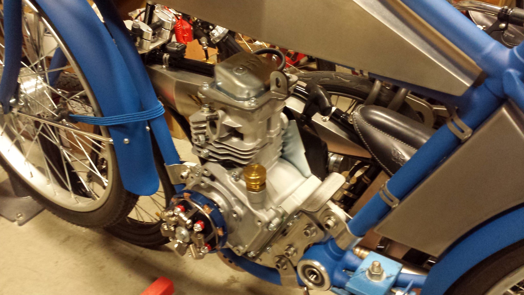

Next up is the engine. I just quickly mounted it to see how everything looks. It will still get a vibration dampening rubber sheet between the engine base and adjustable engine mount. The entire engine mount assembly is laser cut stainless and tig welded together. You can also see the head mount bracket bolted down with the valve cover. This bracket will tie the top of the engine to the frame middle tube to keep the engine from moving around under load.

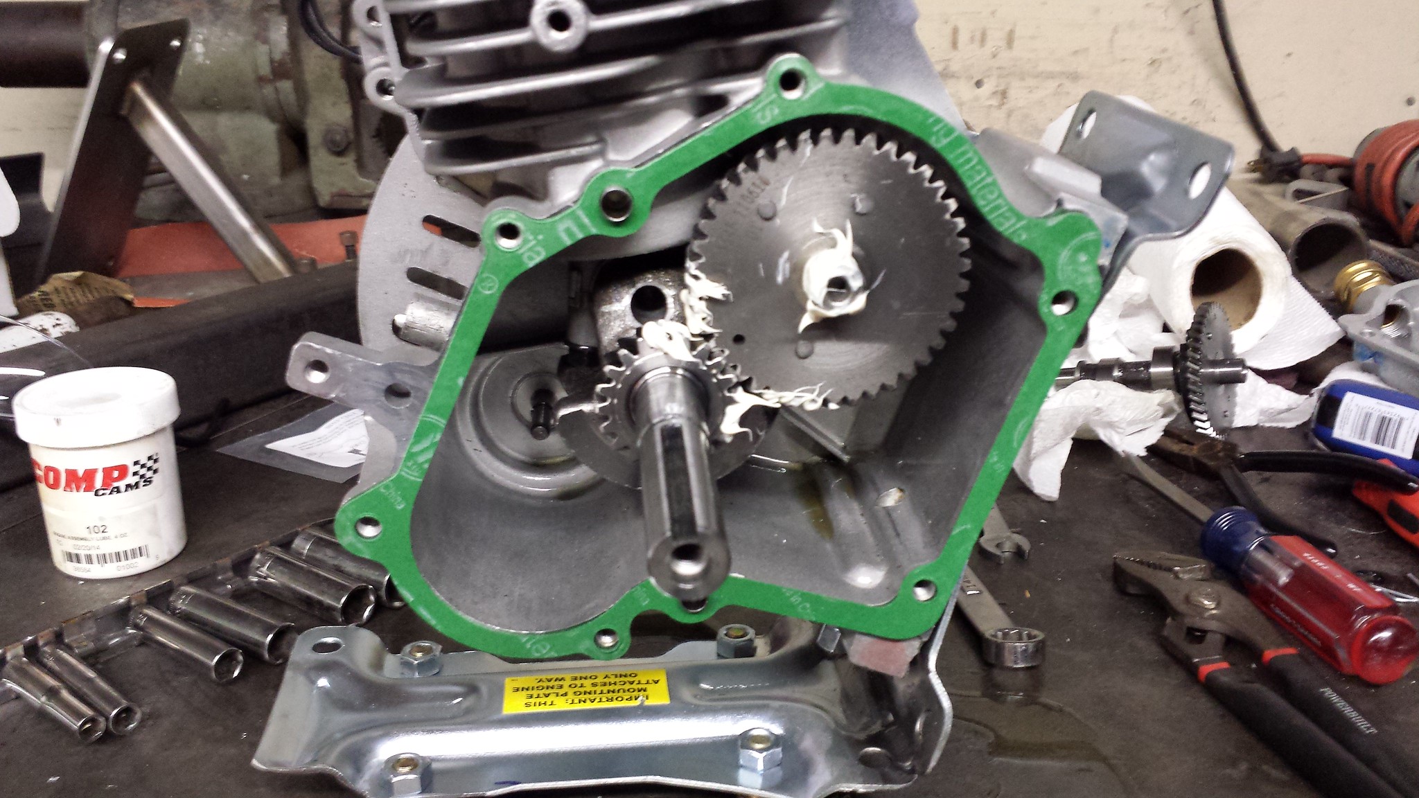

Here is what the inside of the HF79cc engine looks like. Simple, right? The engine governor was sitting to the left of the crank and is removed in this picture. There is a pin sticking through from the right side of the cover that carried the governor plastic gear. I knock the pin out, remove the gear, then reinstall the pin to plug the hole. On the front of the case there was the throttle lever, part of the governor assembly, that was also removed. Once removed I tap it with a pipe thread and plug it. I really need to show the whole procedure to remove the mystery from the process.
