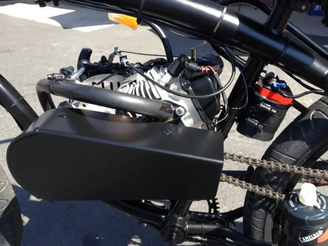

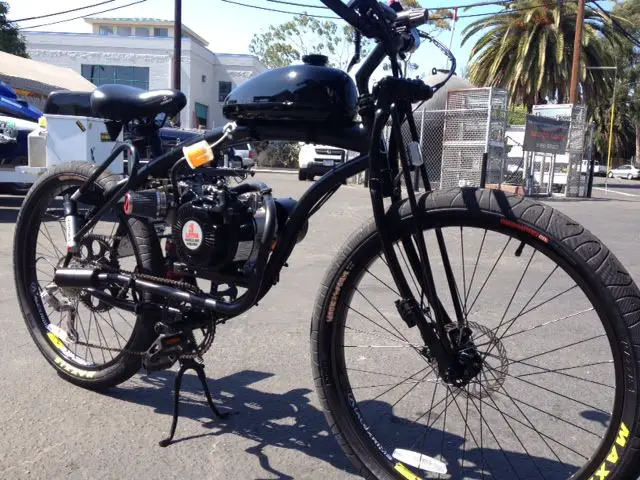

We built this bike for one of our good customers. He went with the 99cc Predator and all of our performance modifications including a custom built header and a custom cam grind. Our customer Craig also added a tach, bicycle gauge which includes a speedometer, water bottle, bike lock, a battery to power license plate lights and several powder coated parts. We used wide rims with Hookworm tires and installed a springer front end with disc brakes.

I'm just a little curious how much a bike like that costs. It looks great and I bet it runs really good also.
You know what...Craig spent a lot of money on this bike. I don't know what his bottom dollar was all said and done but I think it was close to $3000. He opted to go for several engine mods. The bike would perform great with a fairly stock 99cc Predator but we installed our bored carb, a high flow air filter, a custom built exhaust, we ported and milled the cylinder head and we installed a custom ground cam. Craig also had several parts powder coated. He coated the sprocket, the chain tensioner, the motor plate, the motor plate frame mounts, the cranks and several other miscellaneous pieces. None of our other customers went to that extent. Craig also put up the cash for custom built wheels with wide rims and a cassette for multi speed on the bicycle end of things. We used our jacks haft kit and Craig powder coated the clutch cover/chain guard. We painted black our throttle linkage kit, header braces and several other pieces to give it that midnight black look. We added the battery for the license plate lights which required a mounting bracket welded to the frame. The list of unique stuff goes on and on. Craig was not messing around and knew what he wanted. The result is a motorized bicycle that can climb any hill around here with ease and can exceed 40 mph!
