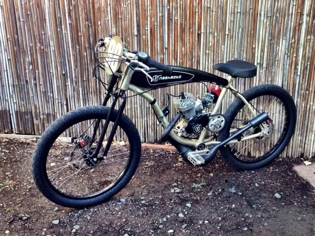

OK girls and boys, the frame of reference here the Grubee GT2A which we know is made of aluminum. The picture below is a race bike built by someone who knows of what he speaks and I think his build on this frame speaks for itself......
Nashmoto is the guy who built this bike and he knows aluminum better than KC know's his wife......if Brian Nash tells me and also shows me how soft this aluminum frame is and is worried of it's strength, I just thought I'd pass on the info and fore warning of such.
If you don't get it, try riding it hard and do your double back flips and get back to us on how it's holding up......comprende?
I love aluminum frames most of all, but only if they are built right out of the strongest heat treated aluminum! 6061 T-10 is as strong as steel.....the frames that Grubee makes and sells are more comparable to soft thin walled lead......not heat treated aerospace quality aluminum.

OK girls and boys, the frame of reference here (is) the Grubee GT2A
Just for clarity this is NOT the GT2-A frame with the curved down tube and front 2-stroke mount pedestal in your reference pic, this is a GT2A-S frame with a straight downtube.
That has nothing to do with the quality of the metal used in both models, but structurally the S is superior.
Good tip for someone that wants to build a high performance dirt bike or frigg'n stunt bike I guess, but I would take this frame over say a Schwinn Frontier for such things.
For example this POS Frontier frame that wouldn't take motorized street riding without breaking in a month.
(that story is for a new topic as it is not over)
Heck, I don't care if it's made out of hemp and horse piss, I rate the strength and quality of the GT2A-S between my low end minimum quality standards like a Macargi and a Giant frame.
The frame is not to blame for my current mount problem, I mounted the engine too far left.
(the engines top silver cap should be direct under the center of the top tab)
No biggie, I can put 4 little lateral slots in the base without taking it off the bike but it has re-inspired me to mock up my design for a base you attach this engine / 4G combo with a right site drive sprocket first, then you can just drop that unit onto the bike like a 2-stroke kit.
Sounds intriguing doesn't it ;-}
Not capping on the bike or build here....it looks great!
Thanks bud, I am pretty pleased with how it is coming along myself ;-}
