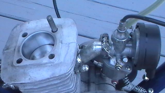

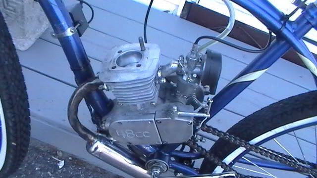

Thanks guys - the motor is a Raw 48cc.

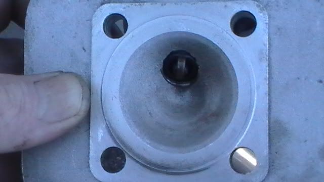

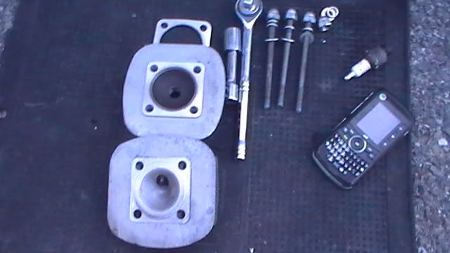

I'm confused my crank doesn't even want to turn my tire moves but it won't turn the crank it seems to me I'm not getting fuel to the motor. Damn Chinese
If you get a head with the plug hole in the center all your problems will go away as far as not turning over when the rear tire is spinning. For some reason the slant heads produce a bit too much compression for these clutch set ups.
I had the same exact issue I swapped out heads and blamo all set . You can do it right on the bike it took me all or 10 minutes ..seriously
