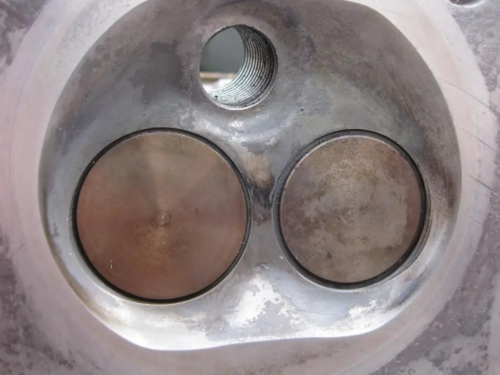

This is the head that I run on my race bike and it is a Honda 160cc milled down .050". The stainless steel valves are oversized but use the stock size valve seats ground to fit the larger valves. It is fully ported and has 1:1.3 billet steel rockers pushing 37lb. valve springs with lash caps on both valves.
I'm using a stock type head gasket that is .040" thick as the flat top Wiseco piston sticks out of the cylinder by .020". I use several shims to index the NGK iridium spark plug and keep the piston from making contact to the electrode.
Hope this helps....
when your head is milled down enough to where your compression is high enough to run VP 110 octane race fuel, there is no need to run thin copper head gaskets that are nearly impossible to get a good non leaking seal. The new thin steel gaskets (multi-layered and such) form a much better seal than the copper gaskets, just so ya know.
Billet lifters and hollow chromoly pushrods are also a good idea if you are gonna build your engine past 10hp.
