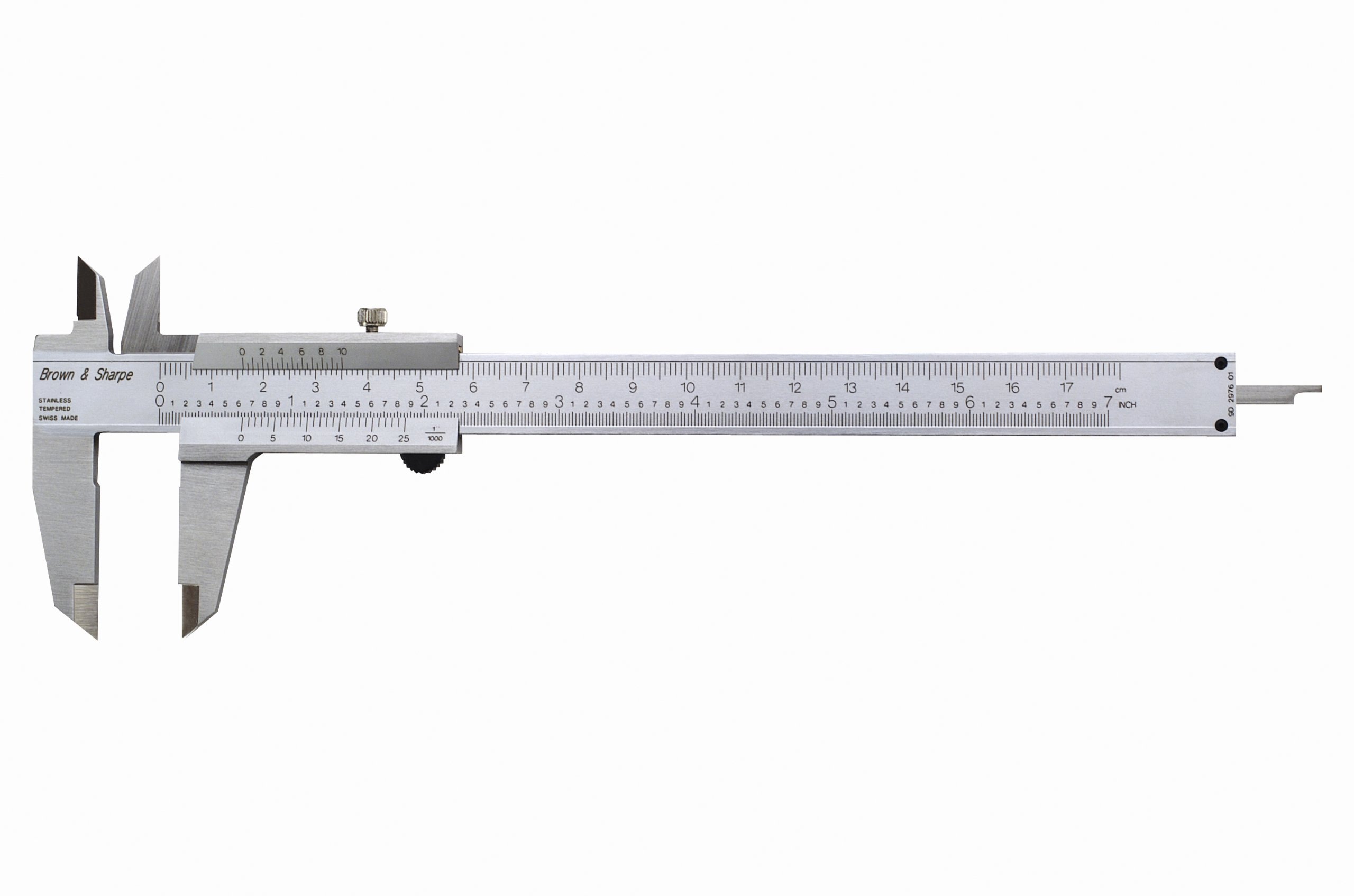

you need to measure your hub first though. that will require one of these in a pinch any autoshop/ mechanics shop should have a pair if you can convince them to measure your hub for you. they can also be bought as almost any hardware store (you probably won't regret owning one)

The most critical issue is matching whatever adapter you choose to your hub. It can't "almost fit". Like the above advice says, measure the outside diameter of your rear hub and determine if the seller has an adapter to fit it. Use a precision caliper, either manual or digital but the measurement MUST be correct down to the thousands of an inch so you'll get an adapter to fit/work.
