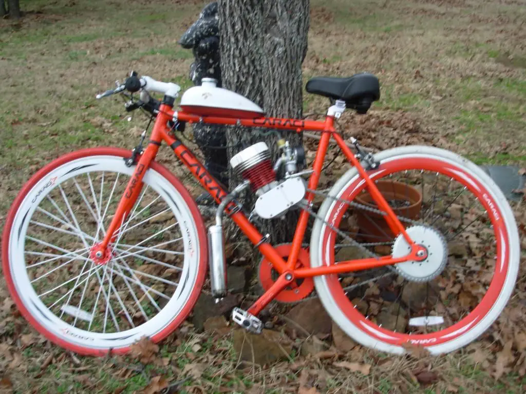

Flyman
Nov 28, 2014
259
3
18
Vian Oklahoma
Well as far as my post some moderator took it off himself thinking I was
trying to dig at you & I think I know which one.He seems to be the big brother here.
But Ya bud my son lives in Tucson & I love that city.I will bring my bike out & you can show me around.
