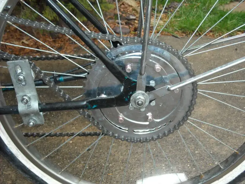

OK, So I guess a person cannot buy a 52t motorbike sprocket exactly. So I found a 52t steel sprocket on Ebay. I cut out the middle section of it and clamped it to another MB sprocket I wasn't planning to use.
No problem drilling the holes and fitting bolts, washers, etc to hold it together. But I did have to be very careful about concentricity or the up and down movement of the sprocket assembly. Using some care, I was able to get it pretty close to right.
The end result may not be the prettiest arrangement you've ever seen, but it works good for me. Pics below.

Good for you, Fred. I like to see people make things work when the odds are against them.
And I disagree with you that it's not pretty. Actually yours looks better than many I've seen. Congratulations.

Lotsa chrome, darn nice looking bike, and the sprocket looks great!
I'm impressed with the work-around. Good thinking.
