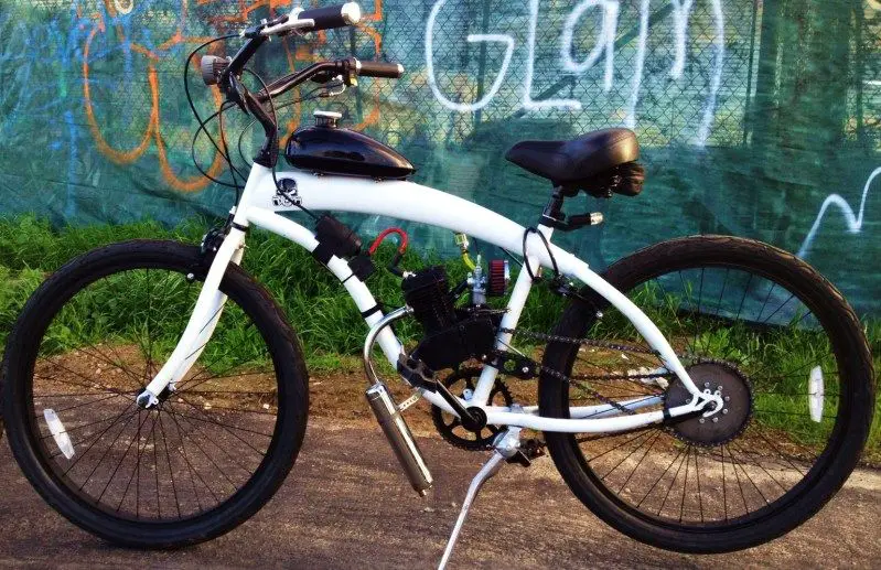

I have this
Was thinking about slightly taller bars, I like how this position is already but not a fan of how far back the bars force my wrists to be
But before I go waste money on bars that may not work out I would like to see some pics of what you are using so it can help me decide what to get

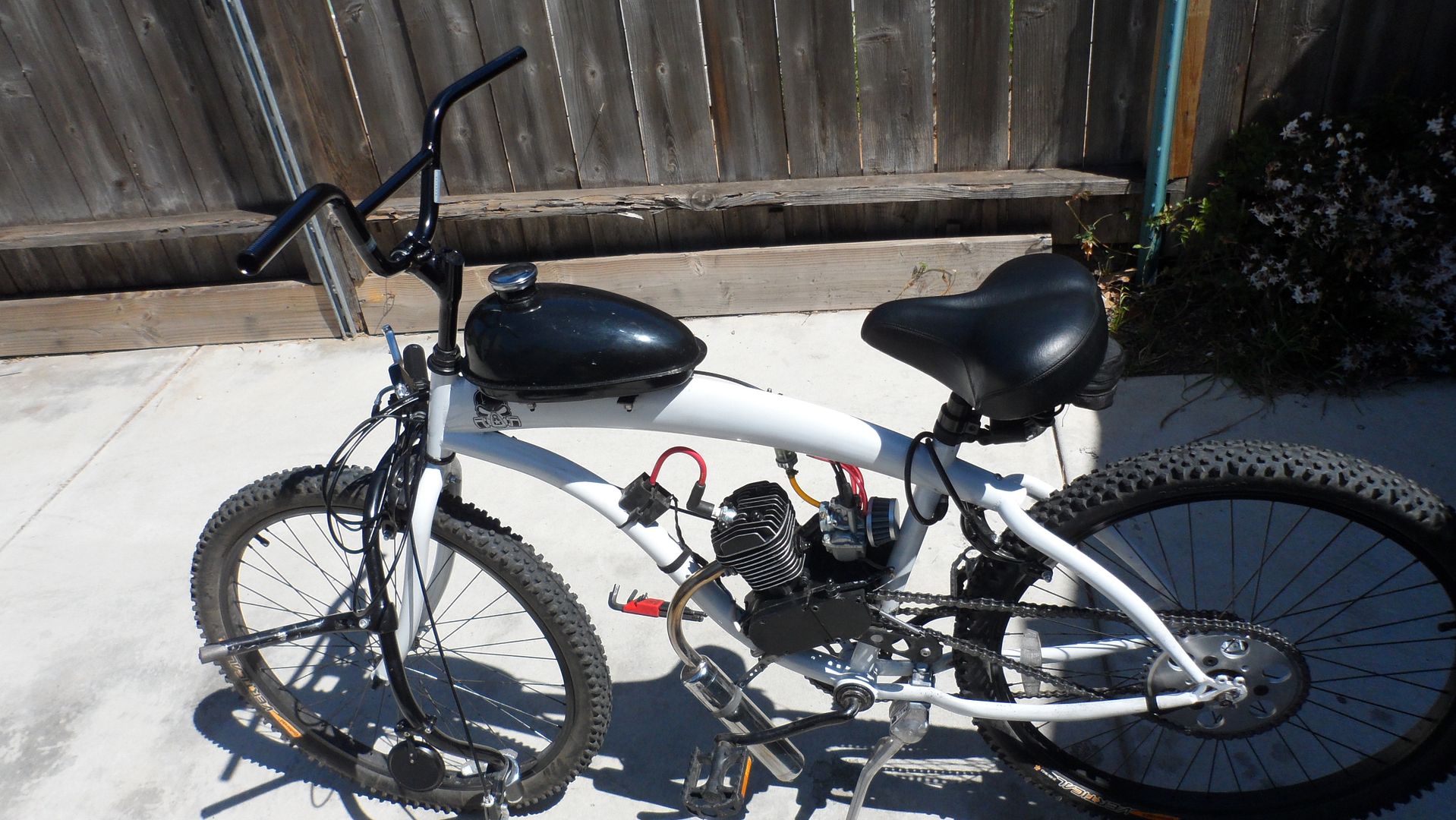

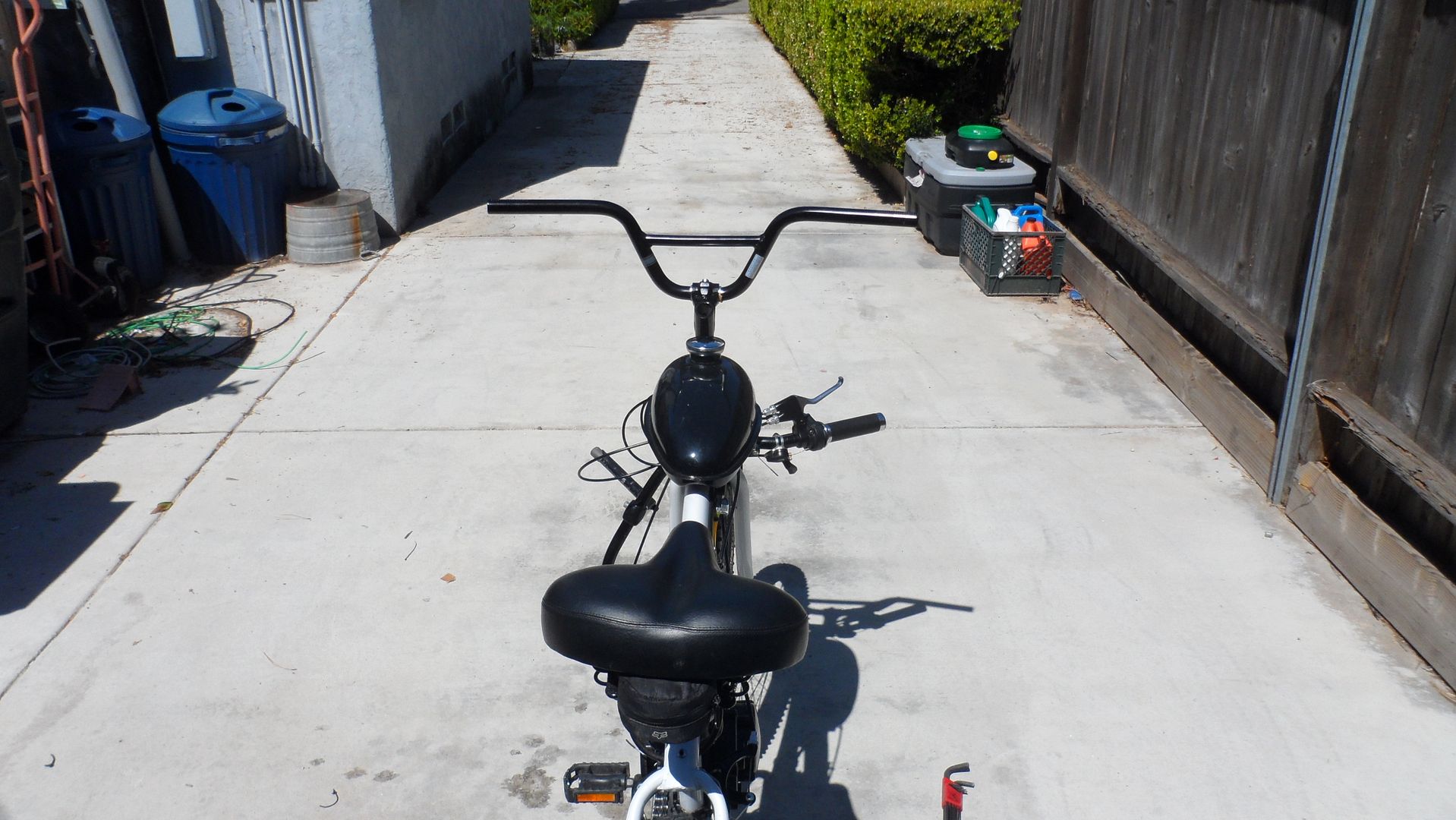

I have these bars on one of my scooters, was thinking about putting these on the bike
but its just too hard to picture how they will look and feel
so I was thinking around this type of height
these bars are pretty wide and flat, so im not sure how much that will change my riding position if it will make me have to lean forward more

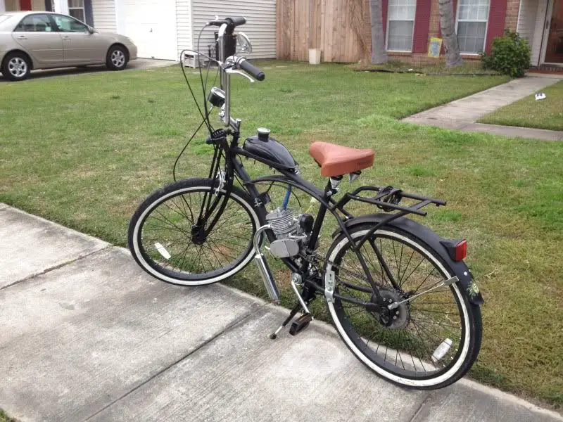

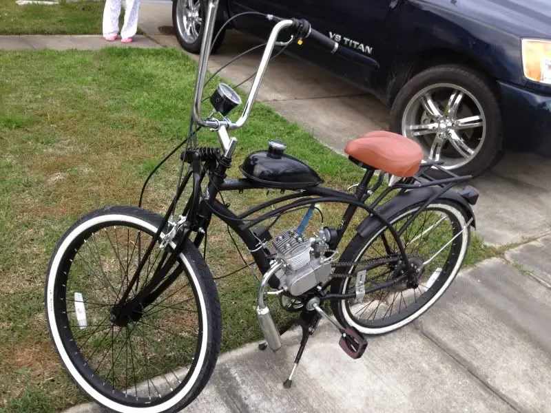

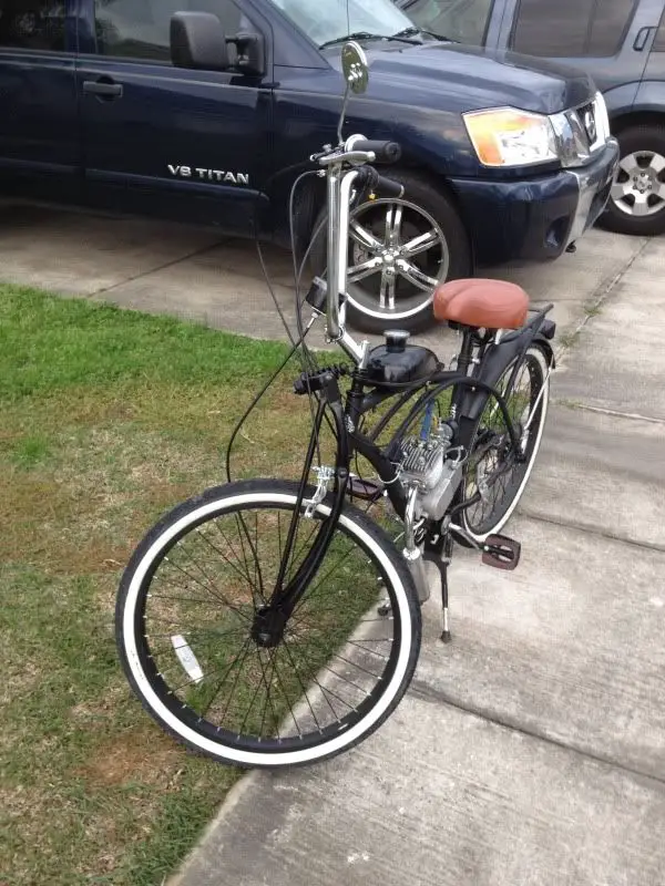

I got bored of my original bars. I flipped them to give it the cafe racer look. Then I flipped them back because they were very uncomfortable.
I then went to a local bicycle shop and got me some mini-ape hangers. I LOVE them. I love how they make a standard 26 inch bike feel so much bigger. It rides a lot higher.
If you do it right, you might not have to do much to make your front brake/throttle and clutch cables longer. But, then again, you might have to.
Let me know if these are what you're talking about.
here are some before pictures

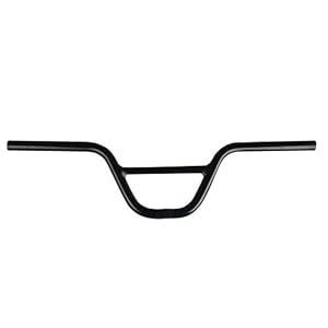

Well I ordered some last night
From looking at my stem it said 22.2
and online bmx stems said 21.1
So im guessing a bmx stem wont fit, so I ordered a mountain bike type thats 22.2
But the bar clamp is way larger so I ordered a shim for the set of bars im getting
They are like 5 inches tall with a cross brace
Hopefully it all works out, but ive been seeing a ton of old schwinn bikes with bmx stems on them, do they fit right up with no problems. Or is it just my bike uses a larger hole? Because the bmx stems were pretty cheap and I like how those look

well I got the parts all off the same place on amazon to save on shipping
I never could find the bmx style stem for my size on amazon, at least the store I was looking at
But here is what I got, not showing the shim
if this all works out I may put a 2 inch rise cross brace bar on my mountain bike just to sit up straighter

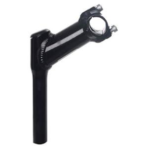

I'm not sure if this will help or not, but it will open some possibilities, I hope.
1st pic is a aztec/delta quill stem adapter... Using the included shim, it will fit either a 1" or 1 1/8th" quill stem.
2nd pic is an adjustable quill stem.

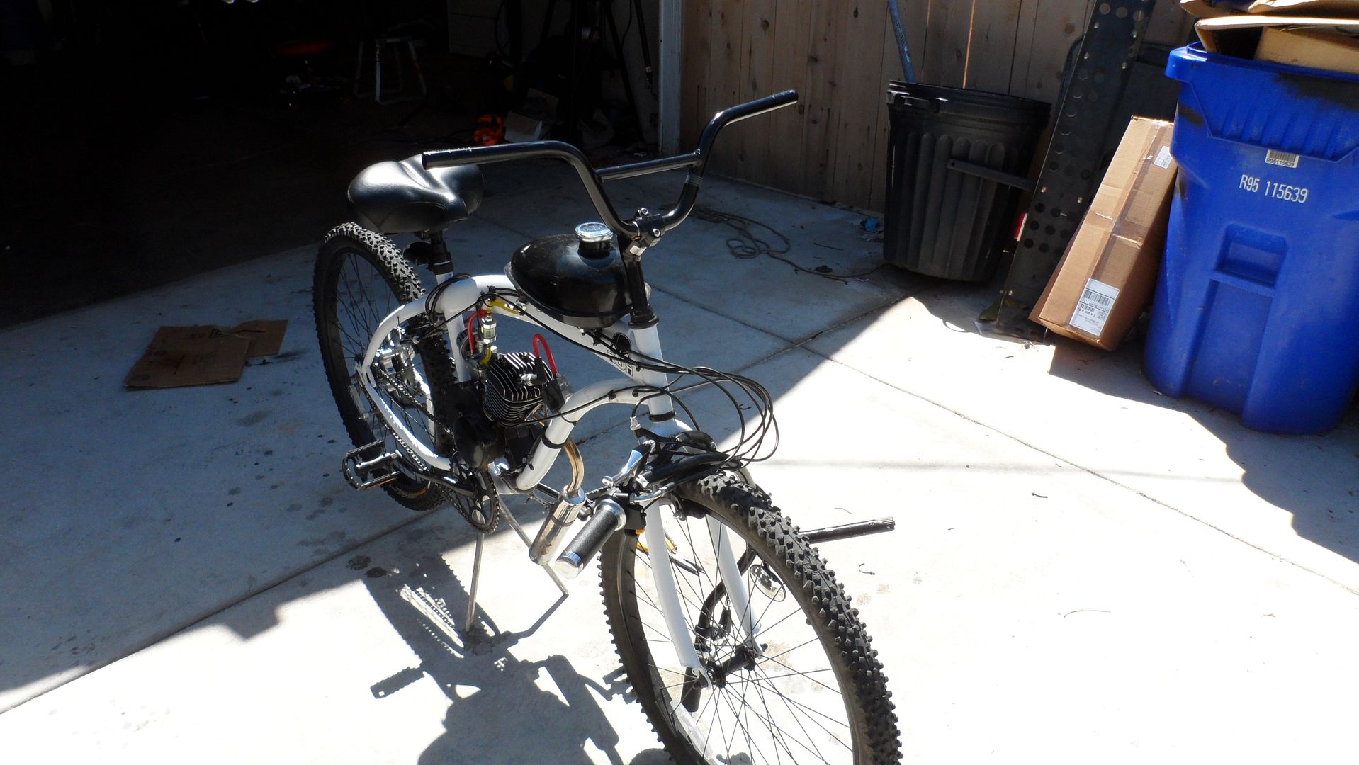

well finally got the bars and stem in, box was torn and of course one shim was missing
so now I have to wait to install all this
bars are a little smaller then I imagined but we will see
I may try to mock it up with 1 shim and cardboard
just so I can make sure its going to work out or if I need something different
SdCruizer
Feb 15, 2012
108
San Deigo
so to me it just doesnt look right, too small
maybe because my seat and tank is so big
not sure if once all the controls are on if it may look normal, so far its comfortable at the height and angle I have them set at

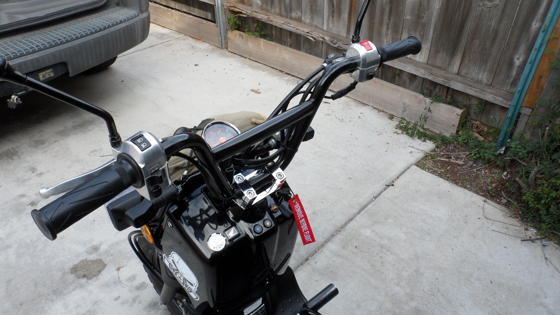

Here is a scooter handlebar for comparison
not much wider but it is more like what I thought I was getting, also little taller but I knew what height I was getting and chose the smaller height
I also chose the middle width of bars too, so now im wondering if I should of got the wider ones
Im also debating weather or not to put bars on my mountain bike, so maybe I will see how these look on that one

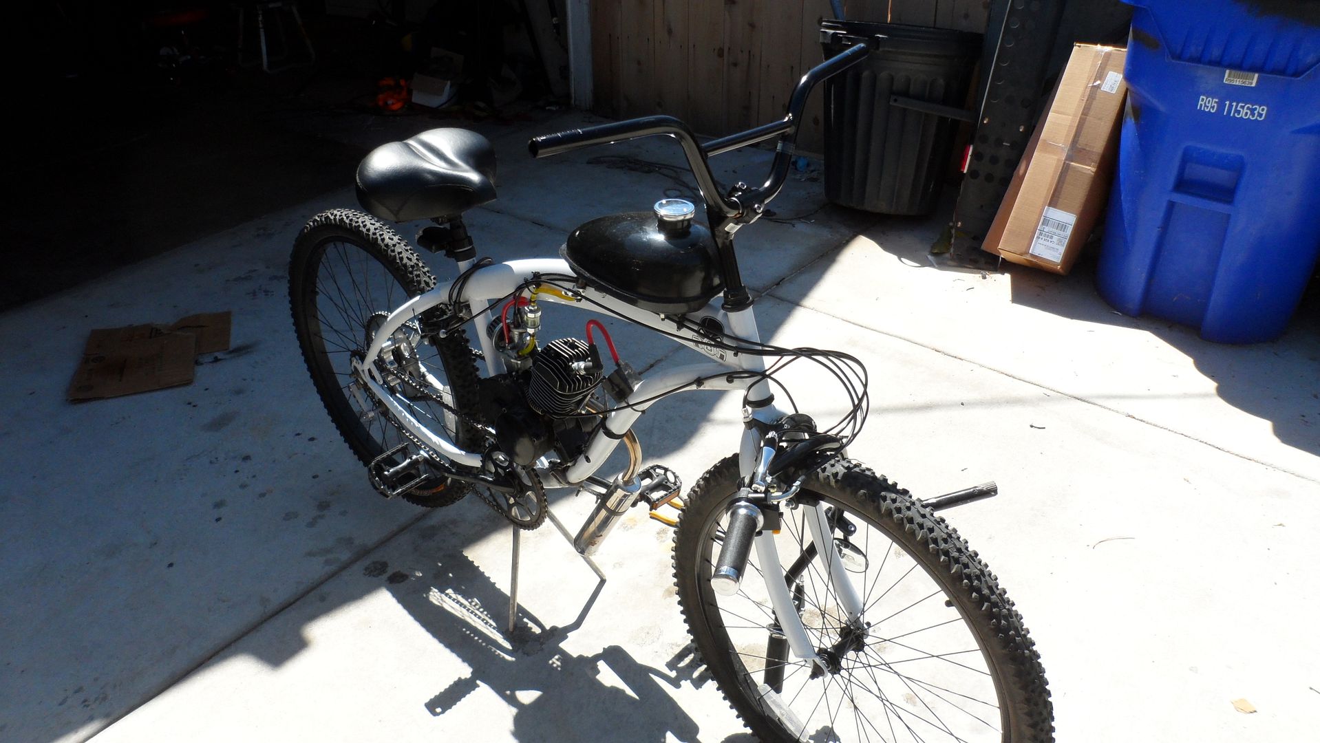

decided to order new bars, just like the large ones I have on one of my scooters
So I put the stem and new bars to good use on my mountain bike
I only use it for running the dog, gotta love the soft ride

Hey Bro, Whatevers comfortable for you. Of course they gotta look good too. but I think they look just fine. I've seen what I think are some pretty silly lookin bars on some bikes, and yours don't look stoooopid. And anyway, It's YOUR bike, Do what YOU like.
