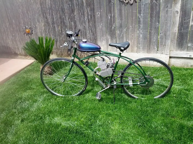

So I've been apart of this forum for a while. I started posting my project on the intro board and now it's pretty old and been a while since I posted so figured I would start a build thread here!
So in March 2012 I picked up this AMF Beach Cruiser for $75 off Craigslist.
Wanted to go with a slick looking ride almost like a cafe racer.
Ended up taking off the fenders and got the motor kit. (April 2012)

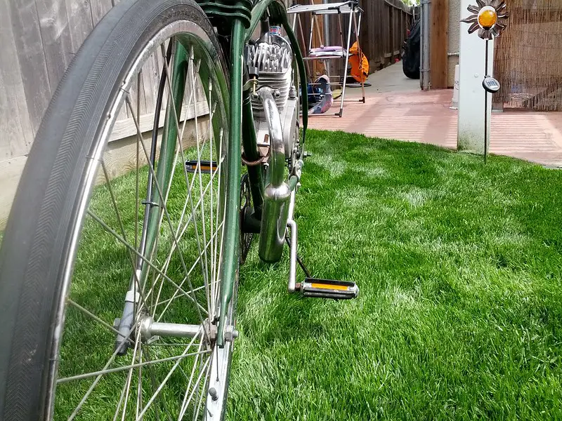

Upgraded the tires that came with the bike with some Specialized tires. The guy at World of Wheels (bike shop) told me that for the size rim I have most places don't make tires for and these were the only tires they had for $20 a tire.

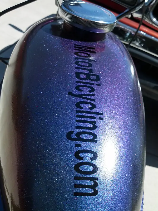

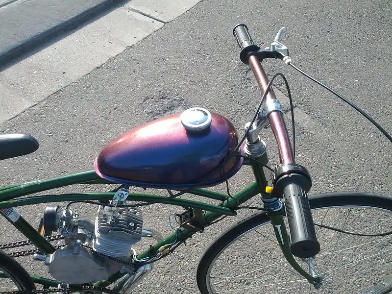

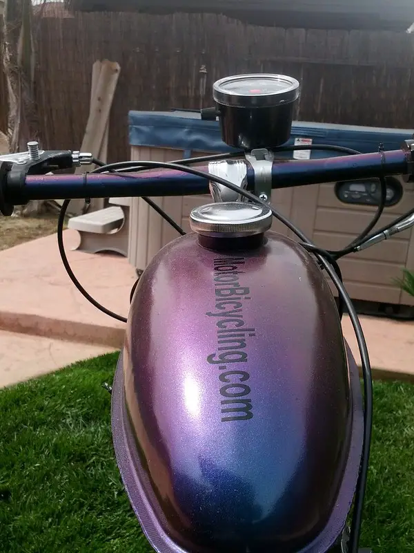

Towards the end of April I got this color changing paint from Autozone for the gas tank and ended up painting the handle bars too.

In August 2012 I got the MotorBicycling.com decal. (Thanks again Paul!)

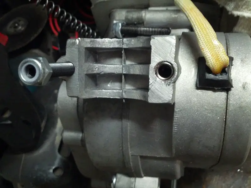

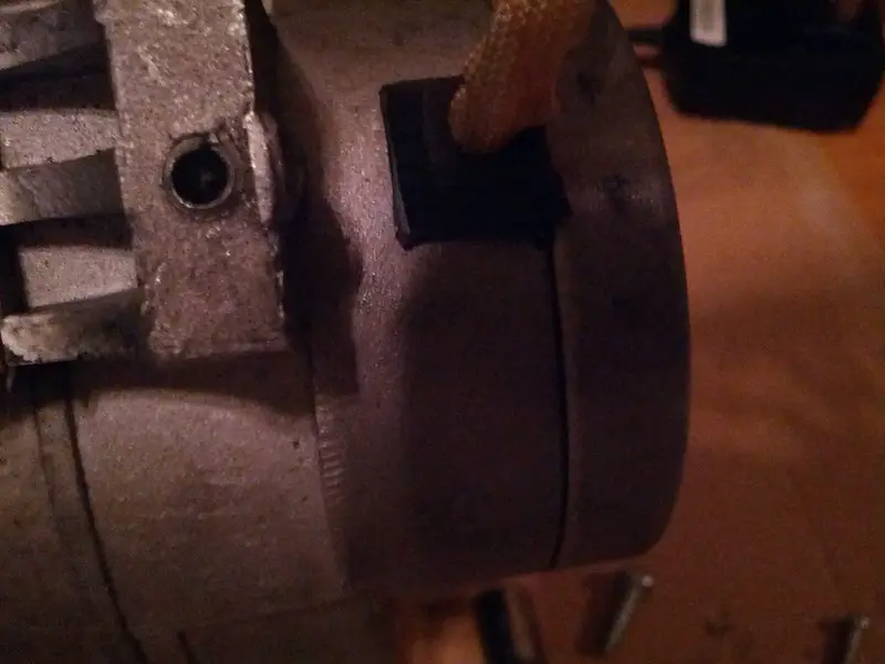

In September 2012 disaster struck when snapped the mount stud in the motor.
Got it Heli Coiled and at the same time ordered the SBP hardware kit.

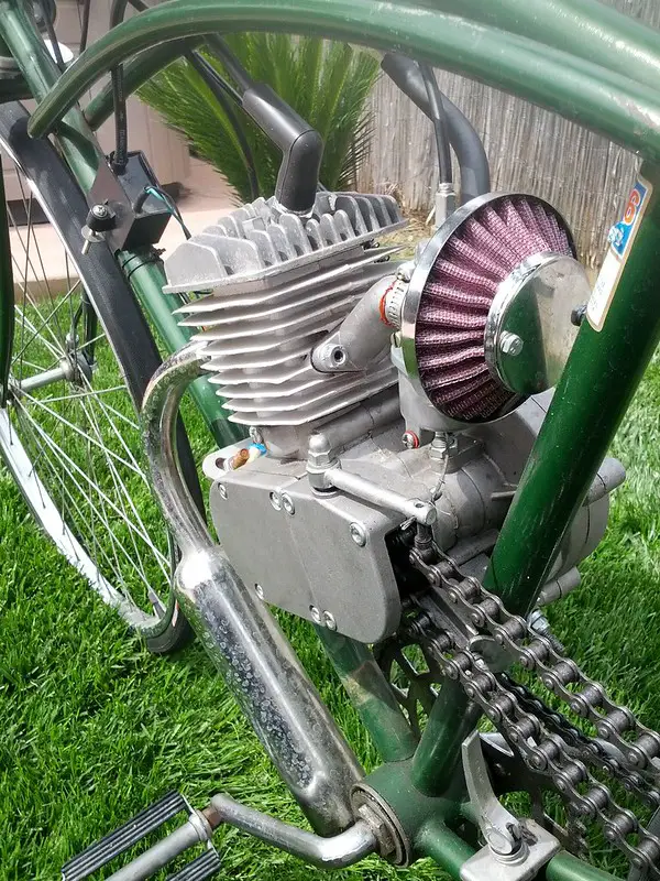

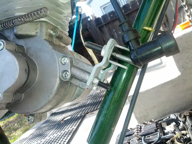

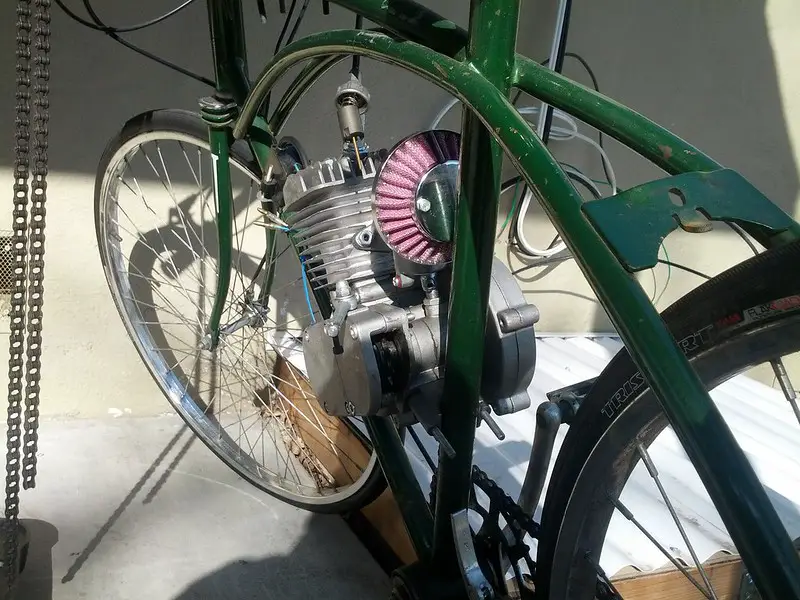

Then she got put aside during the rain and cold here in California. Today I pulled her back out and worked on her a little bit. I had ordered a front mount kit and the aftermarket intake from SBP. The mount bracket for the mount needed to be modified a bit because the heli coiled stud was off just a tad. Got the motor mounted again but I messed up the clutch cable.
So I pulled a rear brake cable off of a spare mountain bike I've had for years. All I need to do is put the clutch cable back, put the chain back on, filler her up and off we go.
Future mods I want to do is get a layback seat post, sprocket adapter, and some type of lighting like an HID projector running of a small battery or something.

If you want to give it a bit more power match the ports intake and exhaust doesn't cost anything except a bit of time. Expansion chamber will help out a bunch as well.

Thanks Mannhouse51 I do like the way it looks with the skinny tires as well. I'm not sure if I can even get a thicker tire in the front maybe just the rear. The forks don't have that much room.
@ Chainmaker, I have a dremel so I definitely will be port matching. And saving up for the expansion chamber. Also plan on going up in sprocket tooth size when I get the adapter.

So just a little update,
Got the clutch cable installed and the chain back on, ended up having to stop by tractor supply and get some new master links. I started it up for the first time since September of 2012. Took a couple tries but she fired right up and I thought I would have to fiddle with the carb a little since I have the SBP filter but I didn't have to that much. And the SBP filter sounds a little bit louder than the stock filter.
I did notice on initial start up the first few minutes it smoked, like white smoke from the exhaust. I'm using Lucas smokeless 2 stroke oil at 32:1 mix and before the bike was down it didn't smoke. But after a few minutes it stopped smoking, I guess it was just old oil still in the motor or something I'm not to worried about it.

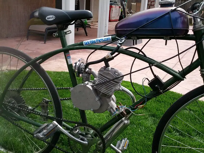

Some goodies came in today!
So today I got my new plug wire and a couple of spark plugs from SBP. Installed the new plug wire and decided to try out the NGK BPM7A Spark Plug. Put a couple miles on her and it runs and drives great! Also put on my SBP sticker on the frame, have to represent where I get my parts from!!

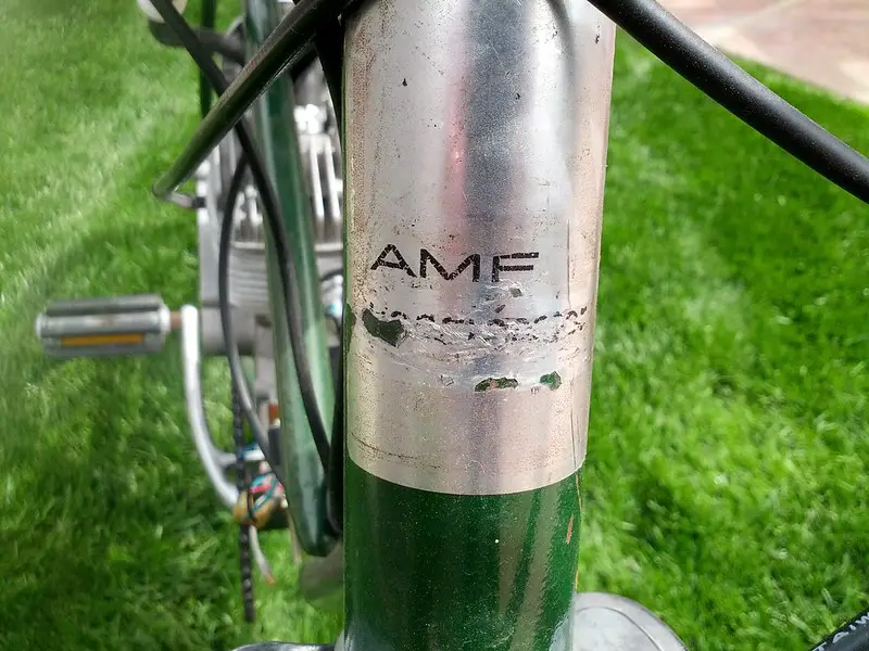

Thanks FLKnifemaker. I didn't really have the intent of getting an older bike. I just wanted one I knew I could mount the motor too easily lol.
The day I picked up this AMF I had zero knowledge of the company, all I knew was that the motor would fit and it was only $75, when I got back home I looked into it because I had never heard of this company, since it is old I wanted to know if this bike was worth motorizing or flipping and making some money, and I found out that these bikes are pretty common and not worth much.
But I really do like this style of bike. Skinny frame and skinny tires makes for a fast looking bike without it actually being fast lol. All in all I'm just glad I was able to give this bike a new life. It's awesome when people ask about the motor and stuff, but it's even more awesome to me when people ask me about the bike itself because it isn't a Huffy or Schwinn or some other common bike you see.

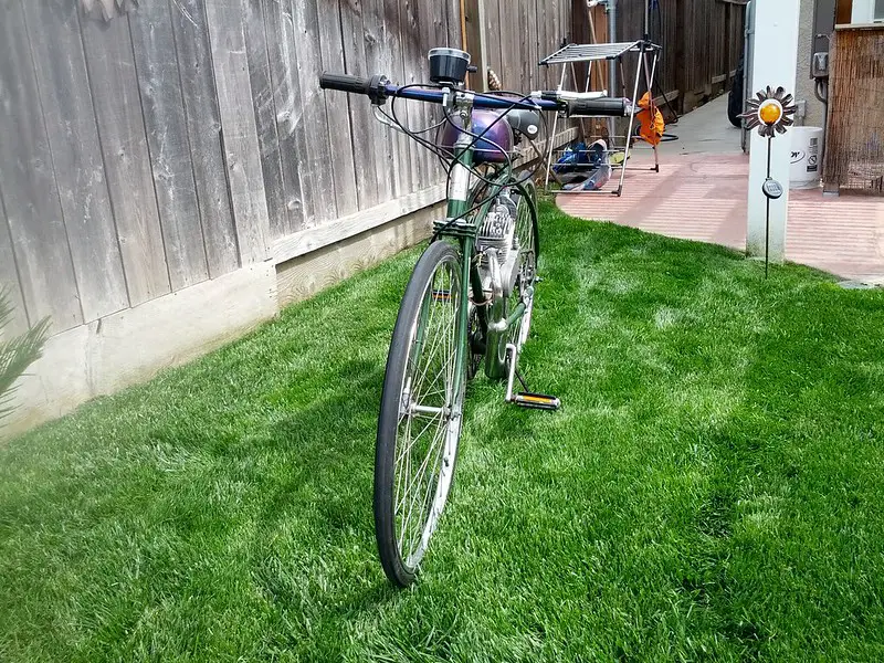

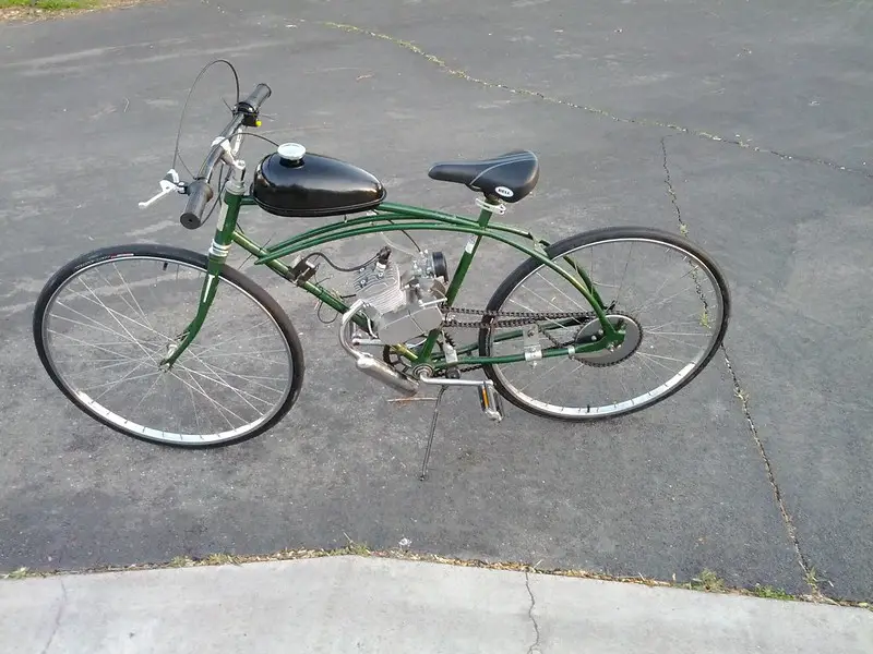

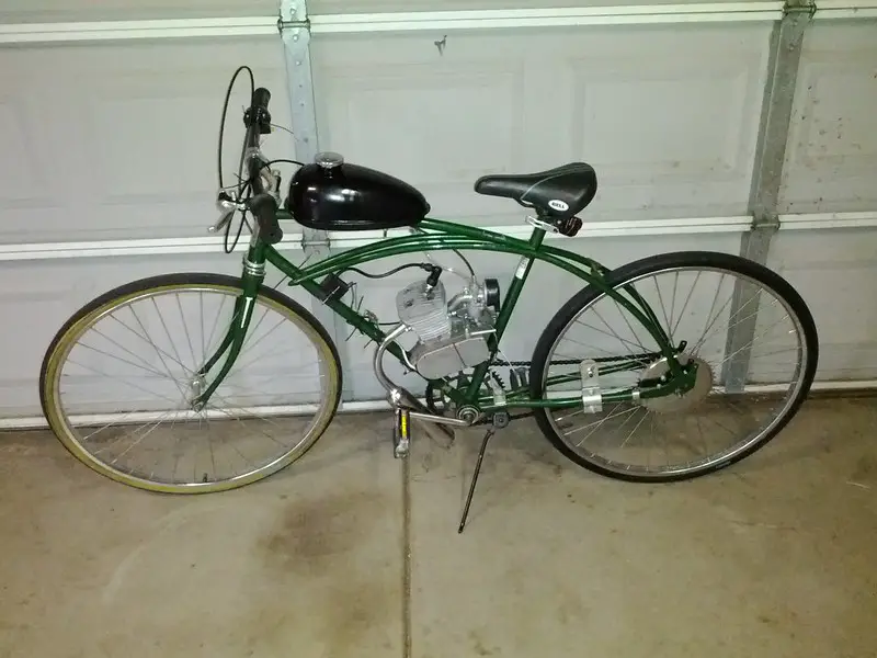

Nothing special to report, just took some pictures. I need polish my exhaust and I'm still debating if I should paint the frame or leave it as is, what you do you guys think?
darkhawk22
Aug 17, 2010
733
8
Acworth, GA
I would add a springer to the bike, you'll notice a much smoother ride as it will absorb a ton of road vibration. I had an AMF frame similar to yours on my first build and used a Sunlite springer from Pirate cycles. Also would advise a hub adapter if you can find one to fit the rear wheel. If the bolt gives out on the exhaust and it falls apart see if you can find someone to weld it at the end cap, mine kept coming apart even after using some high temp threadlock. Great build!
Also, I saw that someone mentioned it before but I'll repeat, get yourself some front caliper brakes on there. A local bike shop might have a simple set or even Wally World / Target.
