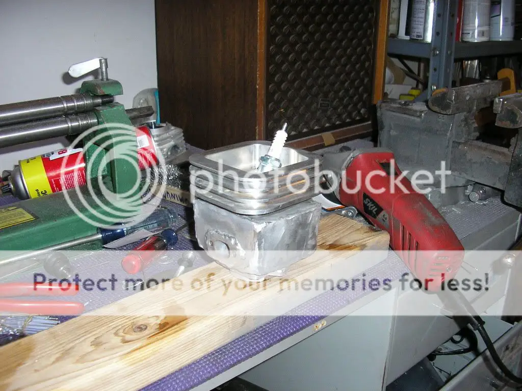

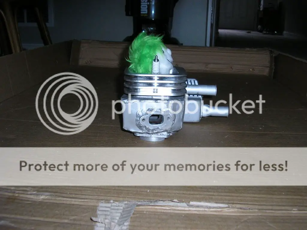

After all that welding is the bore anywhere near still round or will you have to bore and resleeve it? What are you going to use for a radiator? A heater core maybe?

it didnt get any hotter than a running engine does. I welded it 2 inches at a time and took awile the bore is round still yes =. I am using a pocket bike radiator

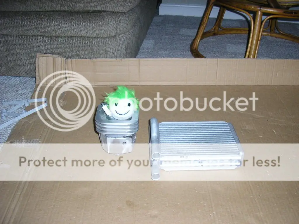

Jim i am working on a thermostat prob 1 off a honda cbr1000 it's the radiator cap and stat in 1 I am just gonna use a heater core as the radiator it was a great idea jauguston. I can aquire 1 at the junk yard 3 streets over from me and prob the cheapest way out. I am so stoked on this project now i just need my crank pully and I'll be in biz

What you may want to do is grab some auto parts store ads, I see specials in them quite often that read "Heater core sale! Priced from $10". Just go in and say "I want the $10 heater core". :D

finished boxing it just need to grind it up nice and weld in the nipples for the hoses
Don't forget to use the full cooling capacity of the cylinder head.....fill it up to the brim with ice cold water!laff
On a serious note, it looks good and should work just fine with the right pump. Keep it coming!
