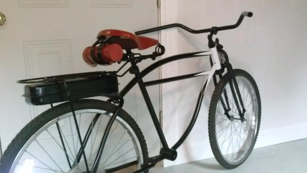

I am about to go under way on a new build and I am looking into getting a gas tank that mounts to the seat post or rack mount. Who or where out there can I find a keg style tank?
currently I am using the 79cc predator tank strapped down to my bike rack. I am really happy with this and would do it again on my new bike but the fuel capacity is under 1L and has a fuel range of 30ish miles.

If you can weld ... Or you even just know how to cut out a pattern ... You can cut and fit an in frame tank made out of steel or aluminum and have someone weld it up for you...

I have one of those same weed whacker tanks strapped to the seat post on one of mine. That particular chainsaw tank is pretty small, so I like to have a reserve on board.

bummer, was thinking of 2 of those for an HT, but getting a petcock in there doesn't seem easy
