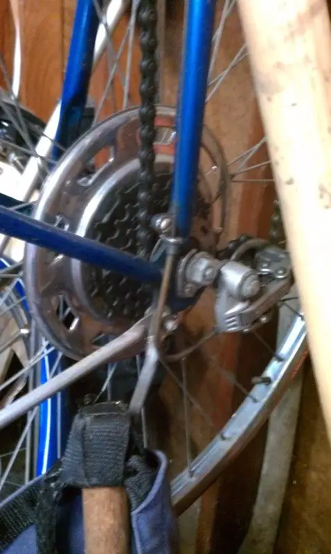

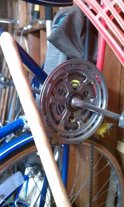

I have a couple of old schwinn suburbans (76 womens 78 mens). Both have the shimano FF system, the womens is also positron. It's been quite a while since I serviced them, they are difficult to service, but I can. As I remember they were well built, but maybe not up to motorized bicycle standards.
Anyone jack shafted one of these shimano FF? I have a 49cc china that would fit it well, and they all gather dust a few feet away from each other.
The mens was my dads, a 10 speed and requires his legs to straddle the bar, mine are too short, but I still ride it once a year. The Womens was moms and has a 5 speed positron. Its in great riding condition still, and has an absolute ton of miles.

Nice to hear somebody else enjoyed the system too. They make such a nice sound in freewheel, unlike any other bike I've ridden. The womens with the positron and ff was really neat coasting and clicking as it shifts. It wasn't until recently I found people are not very fond of the positron, but I think its great.
In interesting fact, the rear sprockets have dogs and springs. If your chain was to become jammed the rear wheel could freewheel without the chain moving, but there is considerable resistance to do this. When assembled the gears are very tight against each other. each rear gear can turn independently. If you are nuts enough to take the rear apart, be very careful those dogs and springs are very small and can take flight, If i remember each gear has 3 dogs/springs. it is tricky to stack them without getting frustrated.
