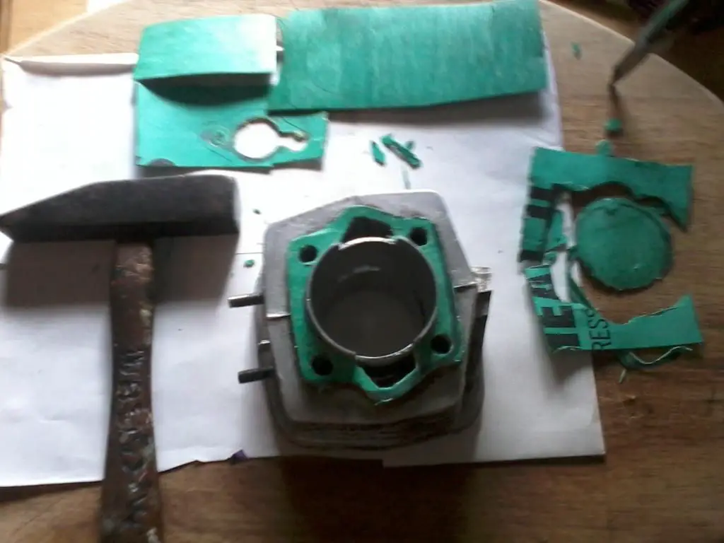

At the same time I replaced exhaust manifold studs also. I could find bulk exhaust gasket material so I bought a set for a 350 Chevy. I made a couple but will eventually get 10 from this. I cut out the holes perfectly with a dremel and a cone shaped grinding stone.
