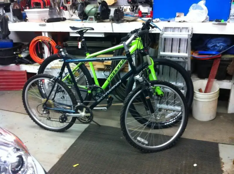

Sorry guys, I'm a total newbie when it comes to bikes. The schwinn mountain bike was tired (bad tires, tubes, shocks, front deraileur, etc.), so I bought a cannondale trail sl 29er to replace it, and just couldn't bear to junk the schwinn. Hence, how the antique schwinn/my old schwinn/2 stroke engine combo came into my head.

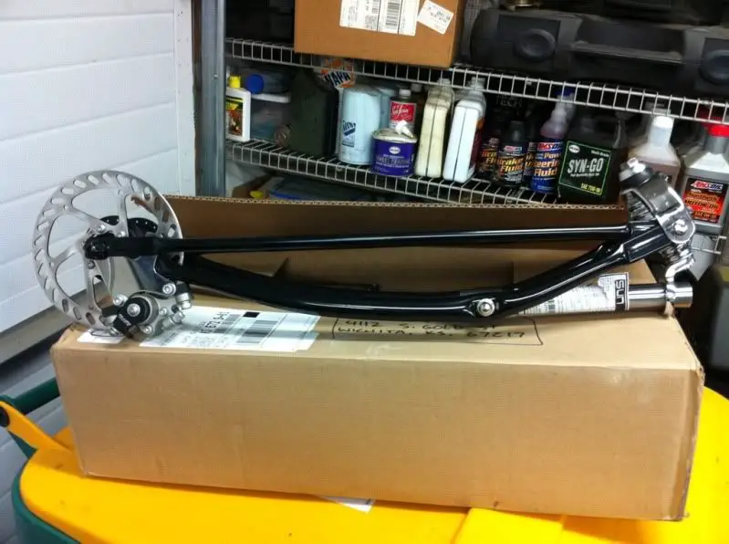

Schwinn springer front forks:
Front disk brake/caliper/hub kit:

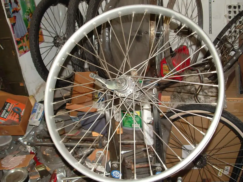

I think I'll be running a set of worksman alloy rims like this guy has:

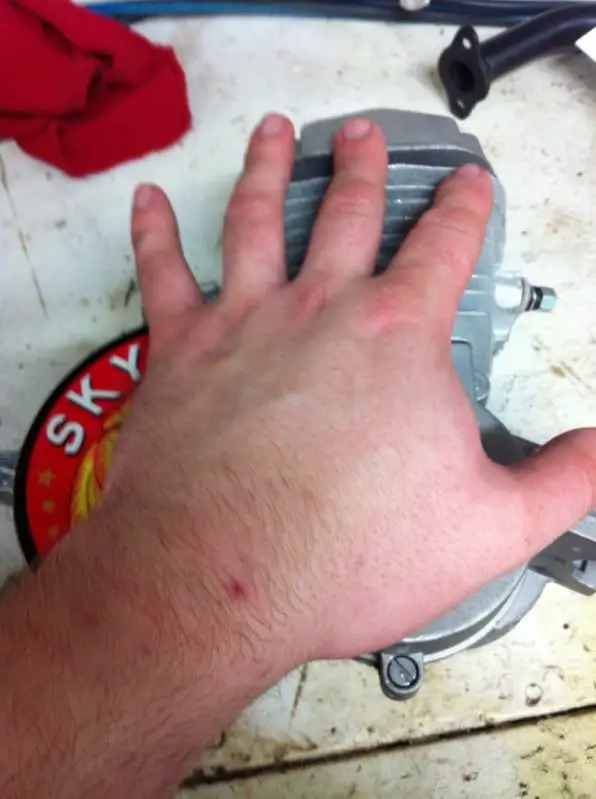

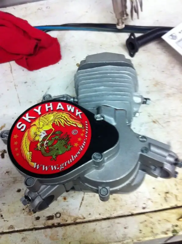

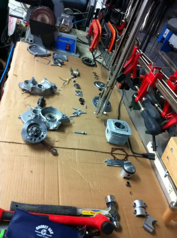

The engine showed up a few days ago. I tore it down, what a messs inside! It's full of sand, swarf, and sludge. There's no way this engine would have lasted even an hour, I bet.

Well, I knew they needed work right out of the box, I didn't think it could be THAT bad, though.

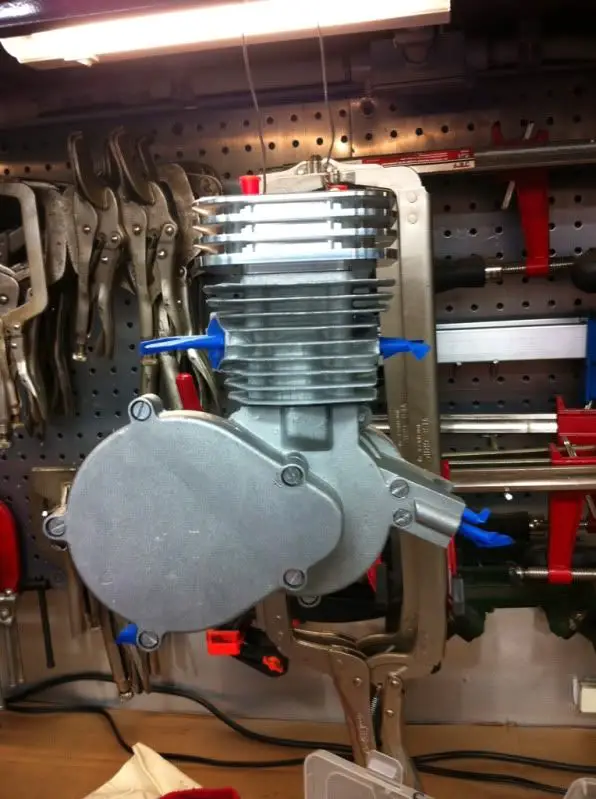

Ok, I need opinions here. The bike frame is going to be flat black, whitewall tires, and any metal left bare will get that dull silver cad plating, pretty subdued old school look.
I'm debating what to do with the engine. The chinese case and cylinder is pretty ugly, and obviously doesn't match the shiny new American machined head. I think the case and cylinder should be painted flat black for sure. Do I leave the entire head bare, paint all of it, or what I'm thinking is find some foam weatherstripping that goes between the fins on the head, and stuff that in there when I paint, so only the face of the fins gets painted, and the inner part stays shiny. I think it would look good, considering how thick the fins are on the head. I could also do the opposite and leave the face of the fins bare, and paint in between them. I'm going to have some vinyl race numbers made with just a white outlined circle, and a white 49 inside it to go on the covers on each side of the engine.
I could also do the above ideas, but paint the shiny part white instead.
If it helps, google "board track racer" that's the general look I'm going for.
The engine isn't together yet, I just put the big pieces together for ideas on paint.

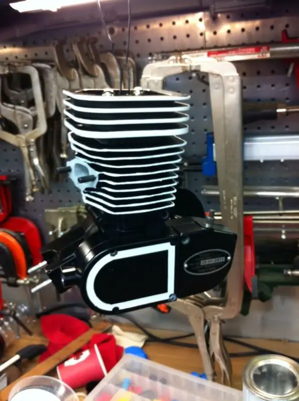

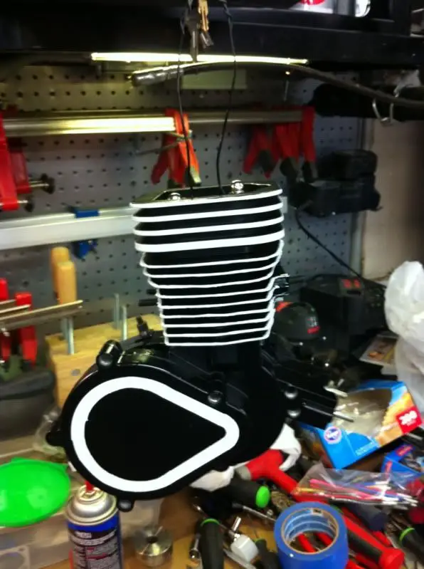

Well, a guy at work was nice enough to shoot the engine for me for free. I went a little overboard with the white, I think I wish I had left the jug all black. Oh well, doesn't bother me enough to change it.
My sister is going to do calligraphy racing numbers (49) on each side cover in the outlined part when I go up there for labor day.:thumbup:
Hopefully the bearings will be in in the morning and I can get this thing together.

While I might have left the new head alone, that is one nice looking motor.
I really like threads like this where I can see the build progress. Keep up the good work. This, I think, is going to be a really nice bike when finished.

Front fork came in today, looks great. Have a few little issues to address (that or I'm inept, which is also likely), nothing major.

I have heard rumors, old wives tales, of people buying new kits, and replacing the motors with old motors using the cases from the new motors and reselling the kits as new. Mostly E bay, or Craigs List. Every Customer that ever brought me a Grubee kit to build was in factory new condition. They opened the box looked at it and brought it to me. The drive chain in some kits were way to slender for a motor in My opinion. I replaced it with a larger one. (c)
crawler
Aug 5, 2011
Wichita, KS
This was brand new from piston bikes. All pieces look brand new, it was just full of junk on the inside. With as much junk as was in there, and bearings like that, if it was ran at all, the jug, rod and crank would show obvious signs of it.
I have nothing bad to say about piston bikes, they have great service and shipped this engine promptly. This is on the manufacturer. I had already read some of the stories on here, which is why I tore it down to start with. You're not going to win arguing with a Chinese company, and there's no point returning it, who knows what the next one is line? When this is put together, I'll have the satisfaction of knowing it's done right.

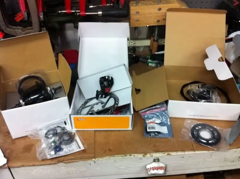

I ordered a shimano alfine 8 speed internal hub, sprocket, 6 bolt disk brake adapter, shifter, and avid bb7 160mm rotor/caliper set from tree fort bikes.

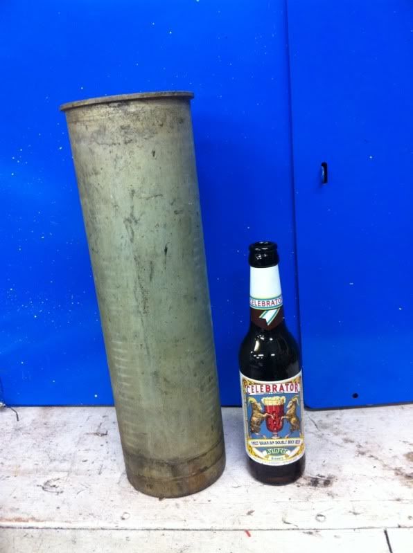

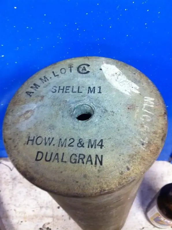

Well, one of the gas tank choices showed up so far.
Steel 105mm howitzer shell:
Still waiting on the brass one, haven't decided which I'll use yet.

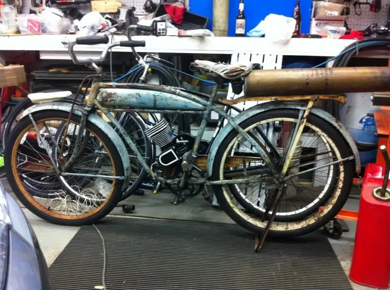

Well, I threw a monkey wrench into the works. I picked up the schwinn, but I also found and bought a nice Monark Rocket.
Now I'm thinking the Monark will get all the neat stuff, and the schwinn typhoon will be a (somewhat) basic build for friends and family to use to ride along with.
I can't decide if I want to strip and repaint the Monark, or just leave it alone...
Here's a picture of it with the motor (painted for the schwinn, I'll get a different motor for the Monark), and the brass 105mm howitzer shell that will mount on the rack for a gas tank (after being shortened).
To paint or not to paint?

I think it looks awesome the way it is. Would make a cool lil rat bike. Would look neat with the engine painted hammered copper and brass fittings. Why use the shell for the tank instead of... well, the tank? It'd be ok either way tho. I'd just be weary of the fenders, and I'd hate to trim the rear one up for the drive chain.
