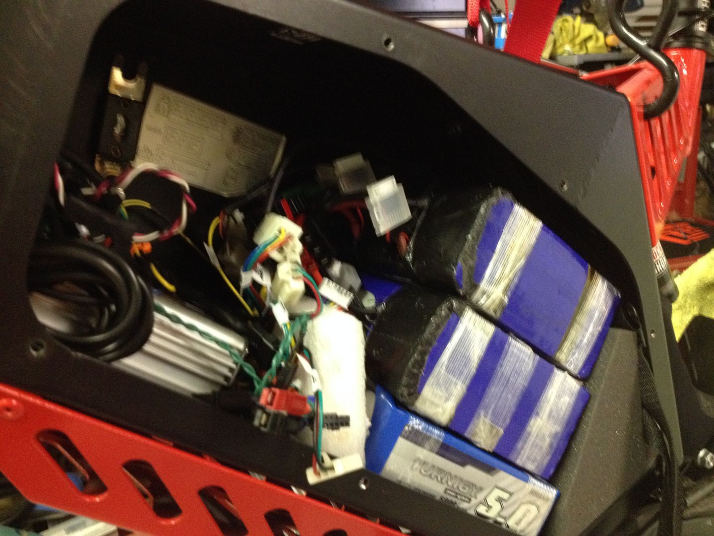

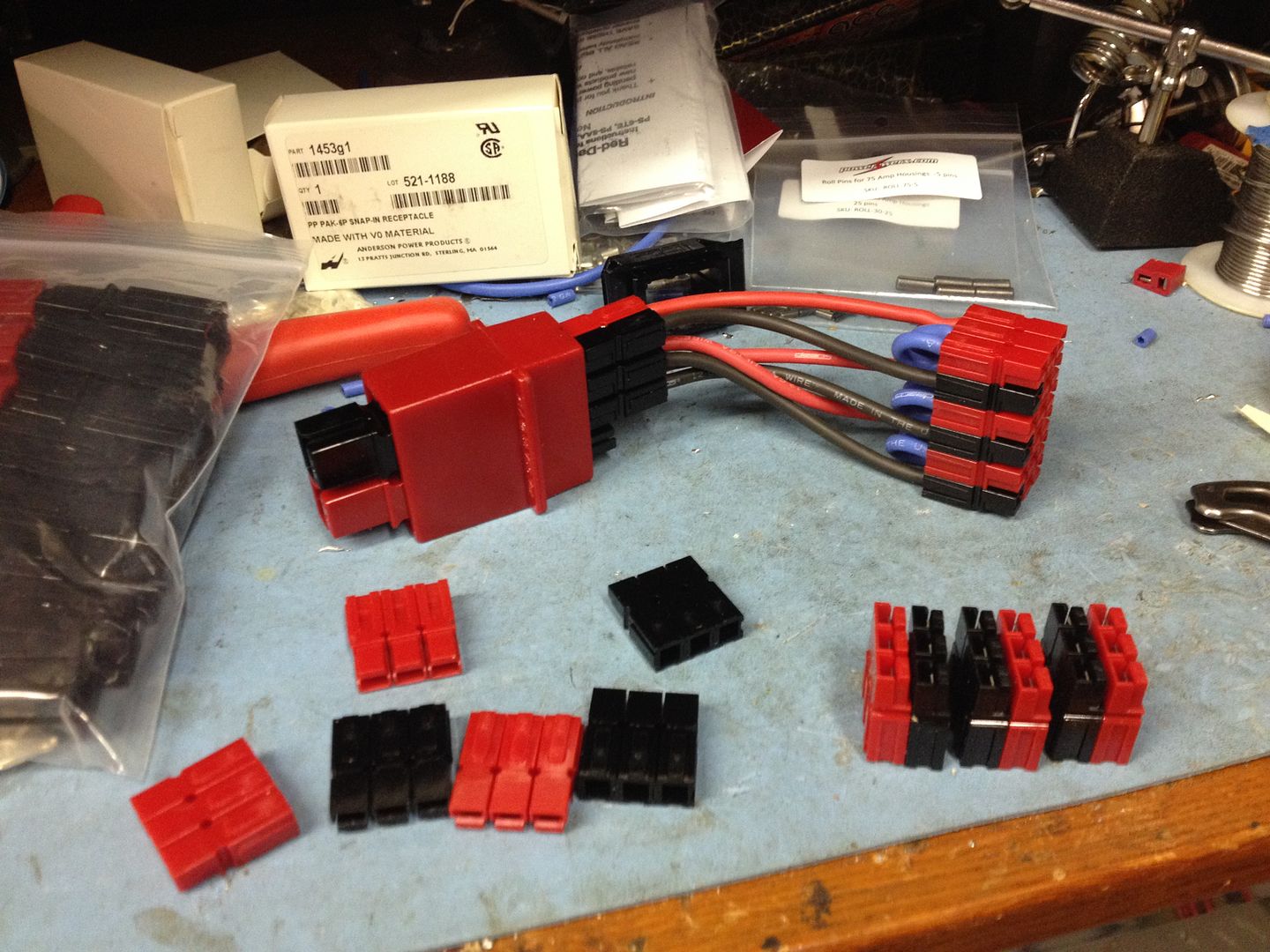

Only update I have on my bike is a new battery power configuration that I'm going too. I barely go 40mph, so I'm dropping my voltage and going with 18s3p 5000mah lipo. Also swapping over to Powerpole connectors for ease changing voltage configuration.
Sorry for the bad phone pics.

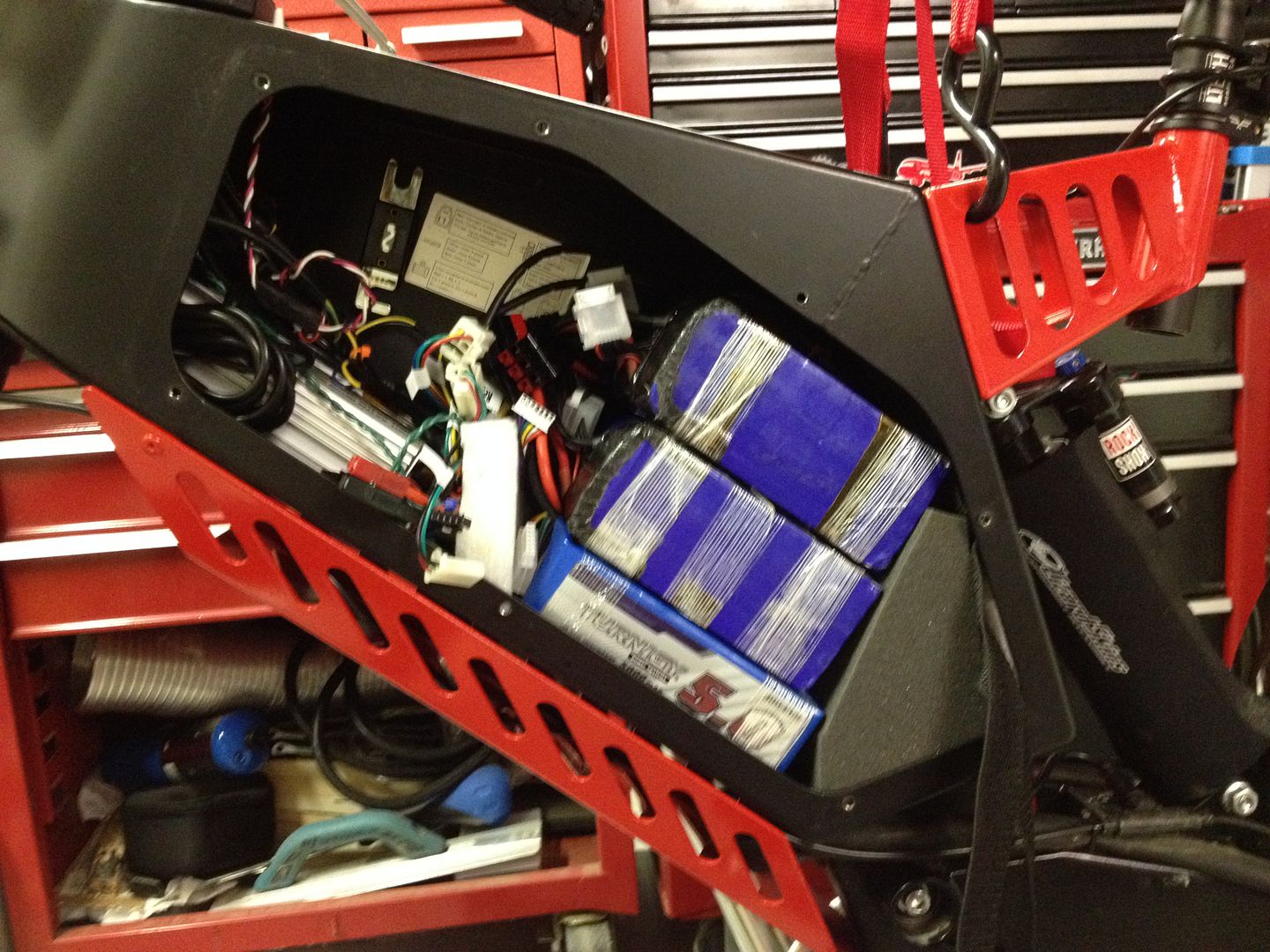

Went riding the Raptor a bit today. Was hard on throttle most of the time.
75.6C Controller, heatsinked to chassis. After 10 minutes of rest, case temp dropped to 55C.
67.2V, 10.8A used @ 18.4 miles.
49.4 Wh/mi, 7773.8Wh.
4.1% Regen.
Motor at 143F.
91.52 Amax, 65V min, -22.9 Amin.
54mph Max. Max throttle set at 115%.
Battery 101F max.

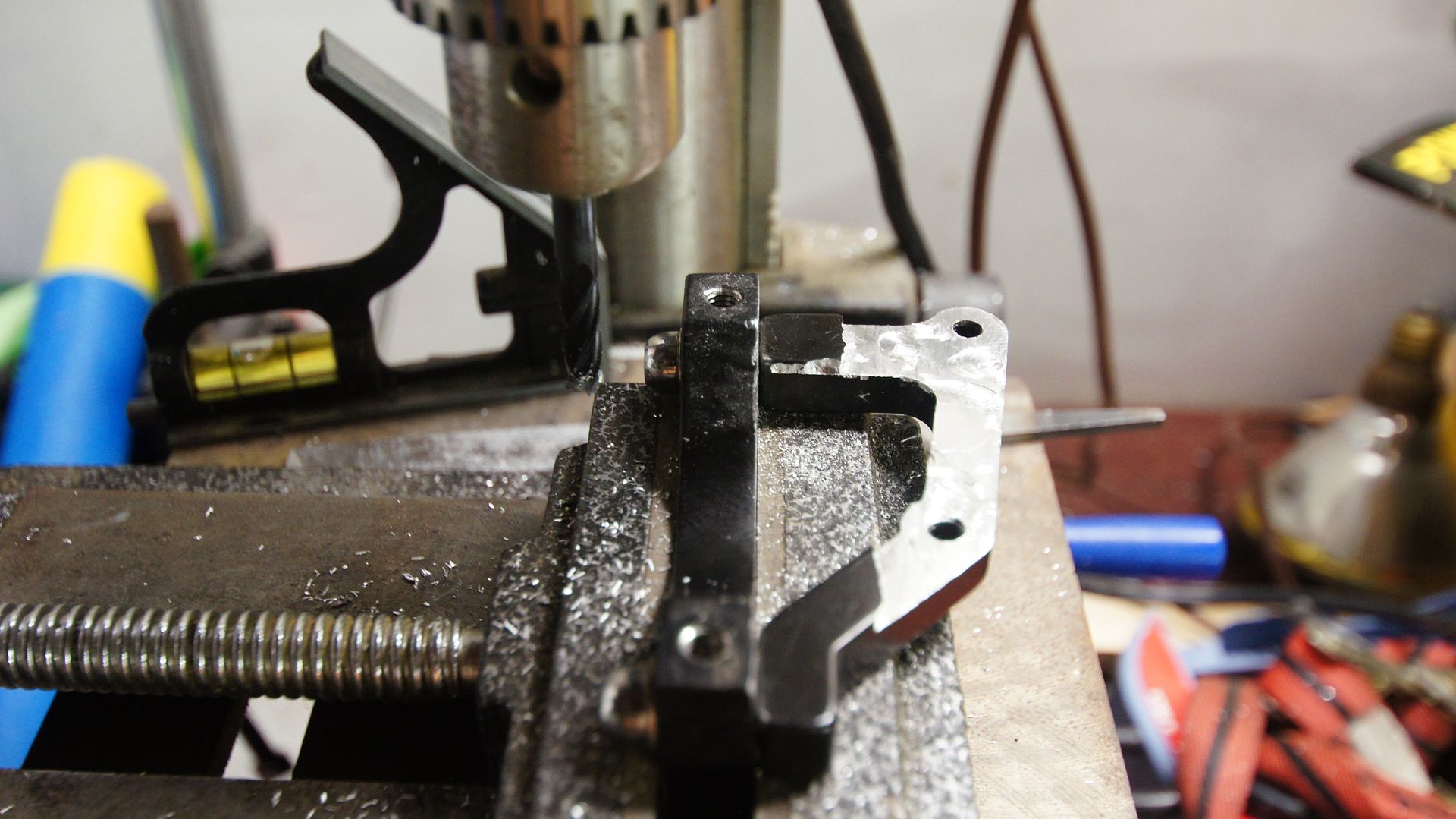

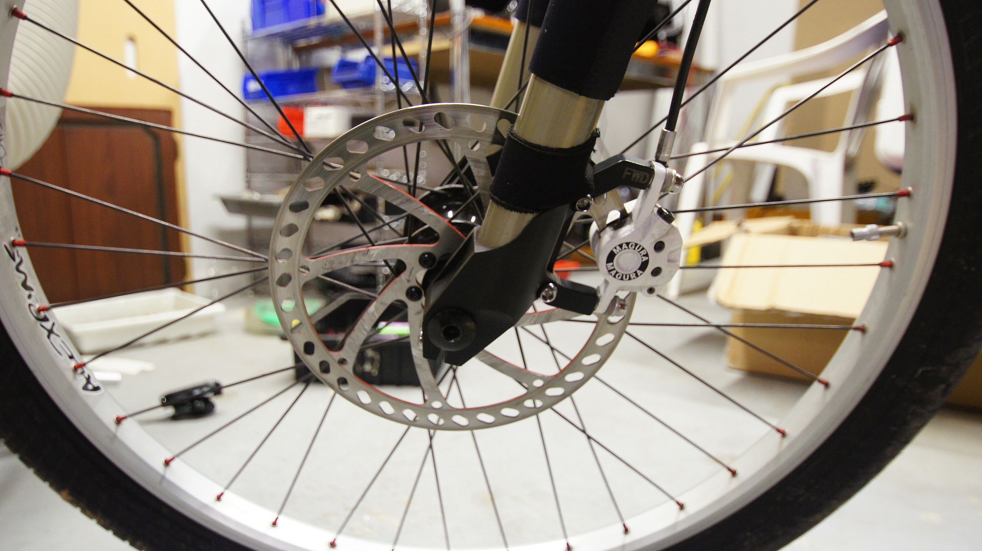

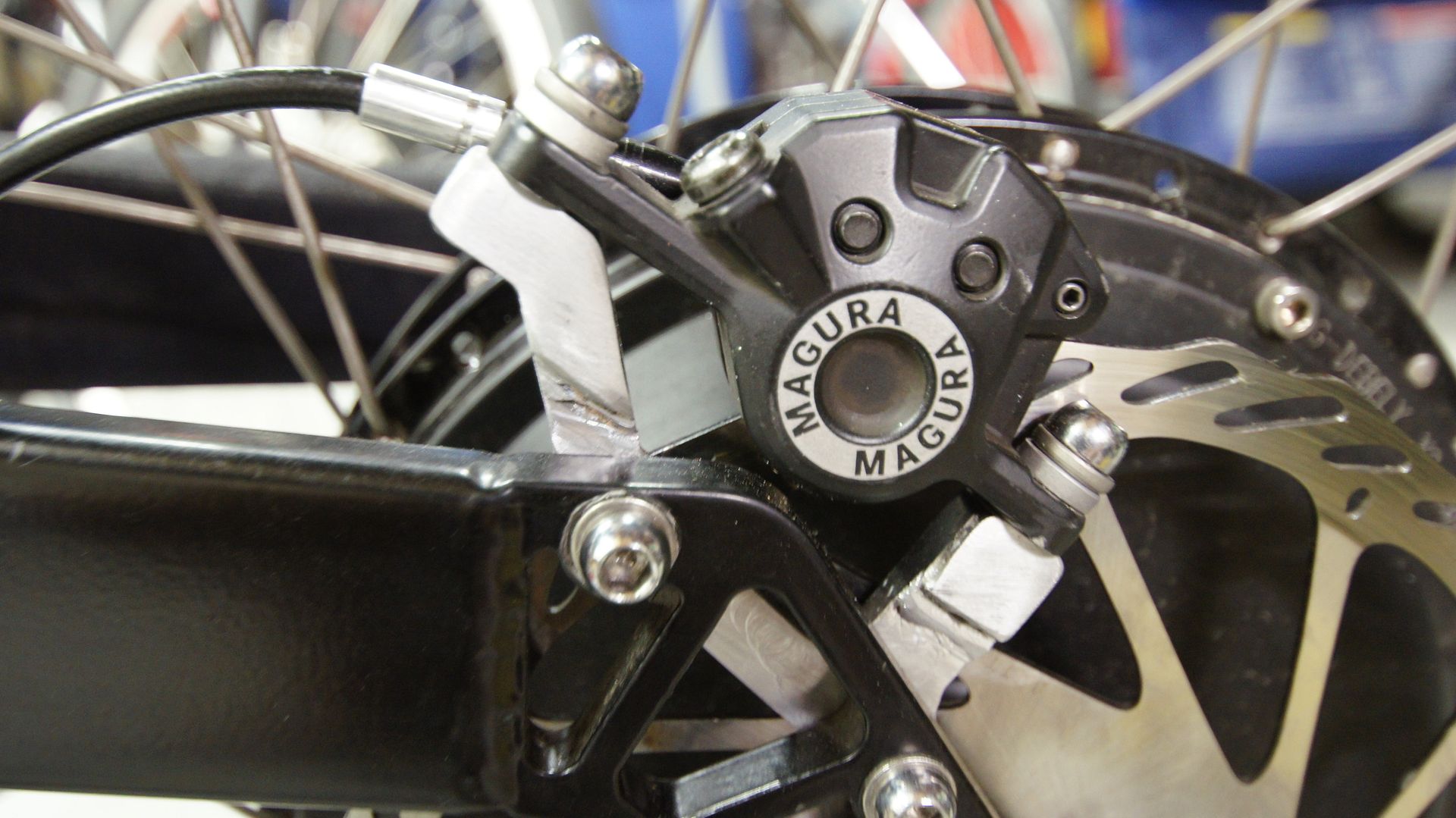

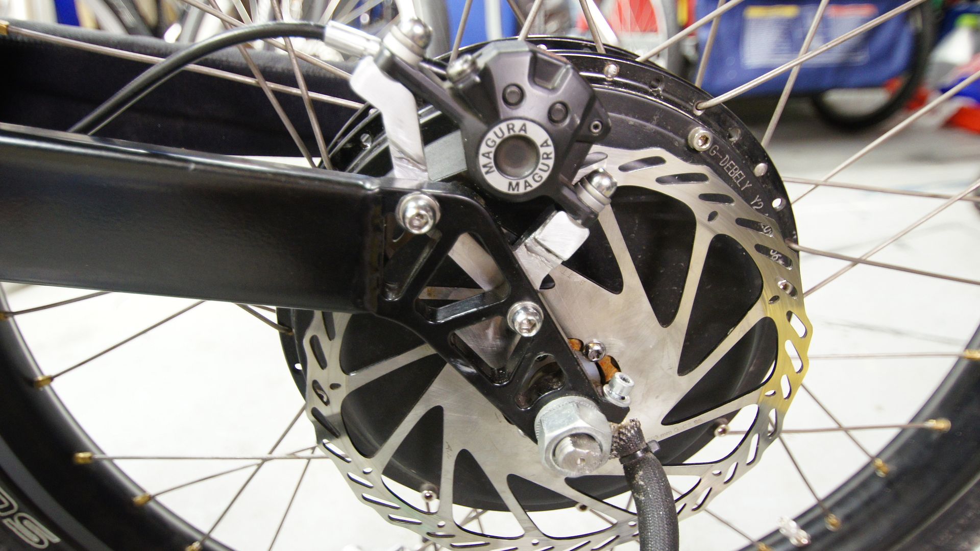

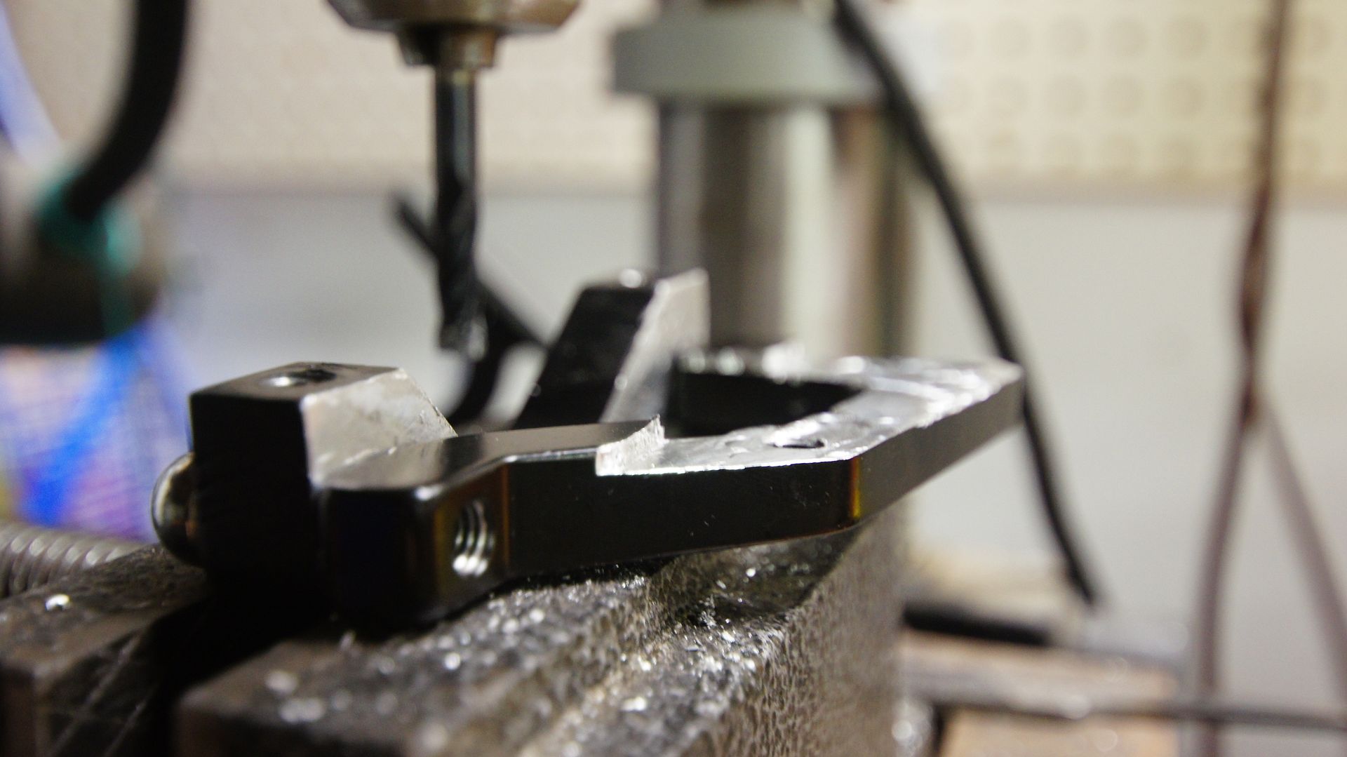

So I went back to the 203mm rotors. I'll be changing the front caliper to Marta FR one of these days, which is slightly bigger and uses the same brake pads. I used my poor man machining skills and trimmed up the rear brake caliper by a few millimeters. It fits nicely after some filing and sanding. Now I can clear the rotor with the 5 speed freewheel installed.
