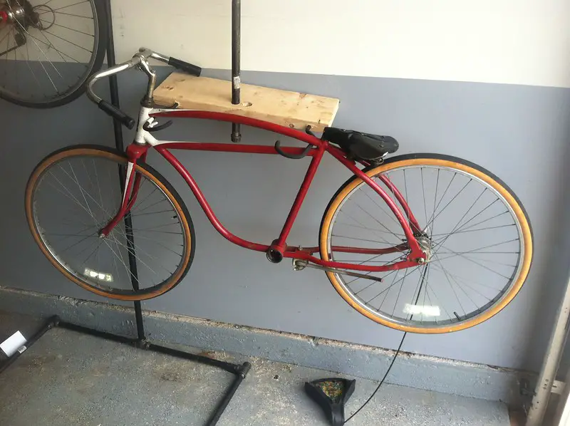

I bought a 1952 Road Master frame and fork to use and found a good deal on another vintage bike for parts. Here's a pic of what I have so far in my build:

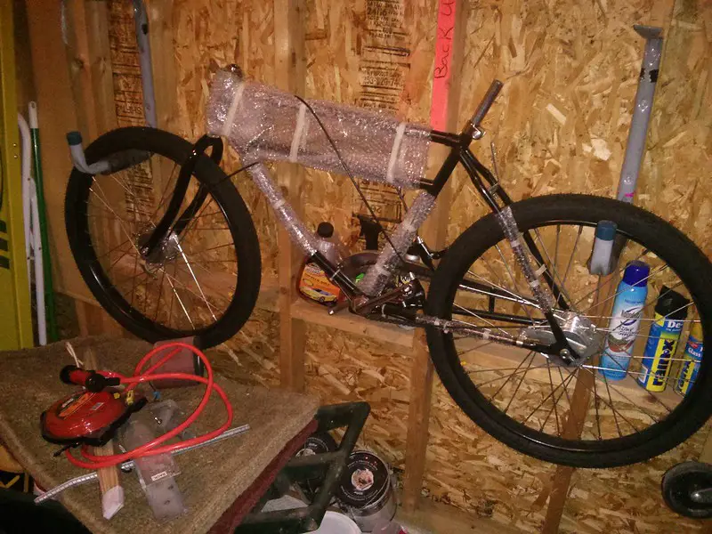

Here's a pic of the M2600 with the black wheels.
When I went to go look at the wheels, I ended up buying both bikes for about $75 more than I budgeted for the wheels with the hopes of piecing together some stuff and selling what I don't need of the woman's worksman (which also has front and rear drums).

That's a no brainer question USE THE WORKSMAN ! and save the other while collecting parts for it, that particular Worksman frame would make a very unique & cool! styled BTR

Roadmaster if the motor will physically fit.

The Roadmaster can fit the 212cc without modifications. The front loop is so big it requires custom mounts to fit a kit engine.

Roadmaster. It is a shocker to discover that fitting a 2 stroke china girl engine is not easy. I had to buy an offset intake manifold to squeeze the engine in.
I ended up scrapping that and cutting the front down tube in the Workman frame and replaced it with a vintage girls Sxhwinn front down tube which then gave decent room for fitting a Sachs motorcycle engine in place for my Indian Hiawatha tri-car.
Stock, there is little you can do with the Worksman frame.
