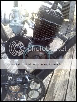

ok here is my problem i got a motor kit from gasbike.net wow these people really dont know there stuff i got the 2010 SkyHawk Pull Start, Centrifugal Clutch, GT5-GGG-2 66cc/80cc well i was out 10 miles from my house and the motor started to acted up like when i gave it some gas it didnt want to go at all well the clutch is slipping and they didnt give me the tool to fix it or have any kind of pdf file on how to fix it so i need some help if any one has worked on this motor kit please help me here is a picture of what iv run into
i just need help thanx GothTech:-||

i dont understand what your talking about?
In the center of the clutch there is a round rod,on that rod there is a slot or keyway,in that slot a woodruff or key should be there to hold the clutch to the rod.Check to see if the woodruff is missing from the keyway.
the pictures are for a visual only,your HT is similar but not exact as the pictures.
my next? is how do i get the clutch off ?
