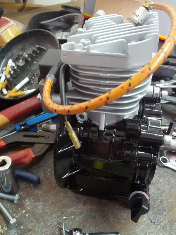

OK. Heres the senerio. Im re-addressing my BTR and going a different route away from the 2 smoke. Lets assume This motor: Lifan/Doodlebug /Baha 97cc 2.5 HP This Jackshaft:http://www.affordablegokarts.com/mm5...egory_Code=PCJ From AGK With the following gearing. Clutch has 12 teeth Back end of the jackshaft had 18 teeth. 41 chain from the jackshaft back to the wheel sprocket 11teeth and the wheel sprocket has 44 teeth. Using AGK's gear calculator this gives me a final reduction of 6 even... SOOOO. With a 26.5 inch tall wheel / tire combo, what would my SPEEDS be at say. 3000 RPM 3500 RPM and ( if ittl spin that fast ) 4000 RPM?? Im hopeless when it comes to ratios and fractions thingys... Thanks in advance!
