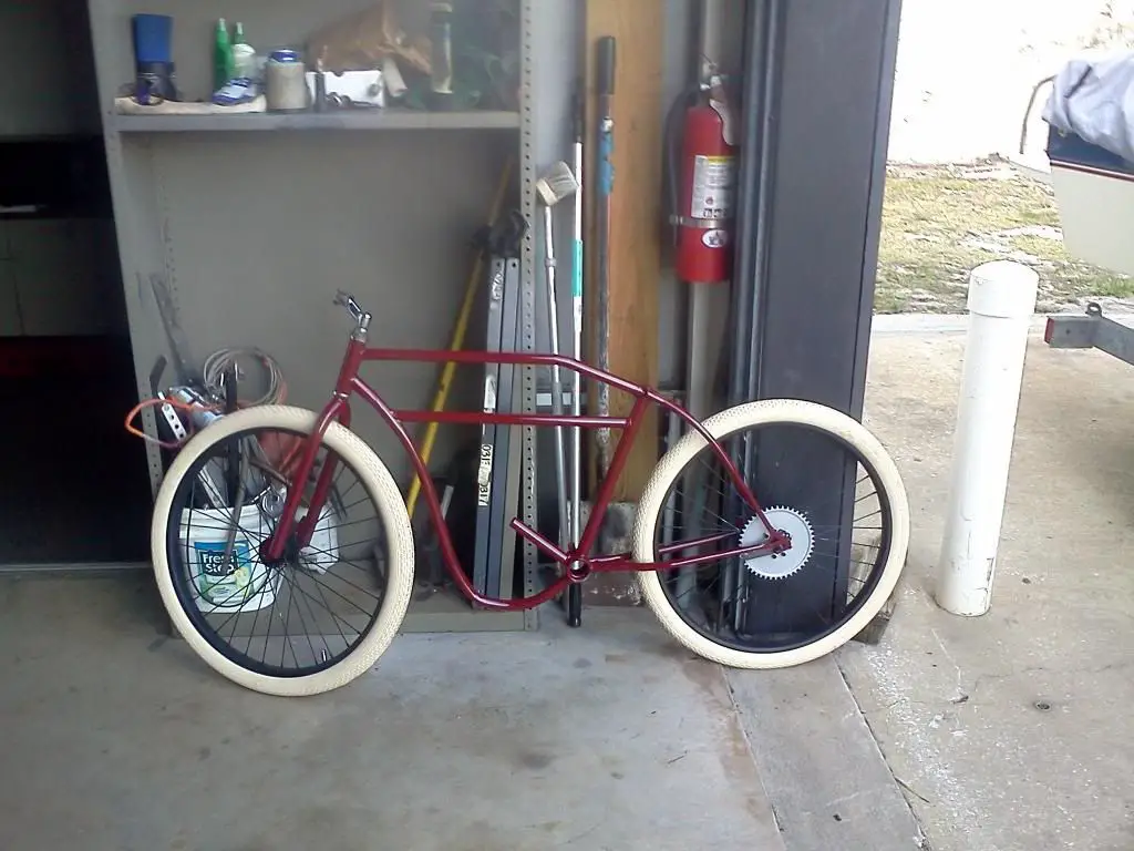

Hey ive just been lurkin for a while on here and i finally started my BTR project, i started it on tuesday(been gathering some parts for a while) and it needs to be finished on monday... so ive got about a 6 day build process, started off with a oldish cycle pro mens cruiser, chopped it up, then bent and welded in some steel i found, did all that on tuesday, and fabed up mounts for a 49 china girl yesterday.
[/IMG]
let me know what you think, i just ground down the welds and primed it tonight, made a faux alluminum tank an hour ago (putting a weed wacker tank in it, dont have time to make a real tank) painting it merlot red tomorrow

painted it today
putting it together tomorrow

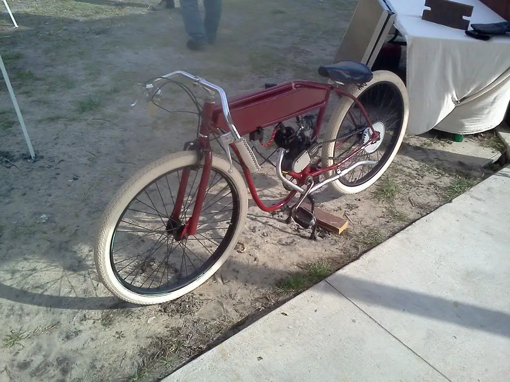

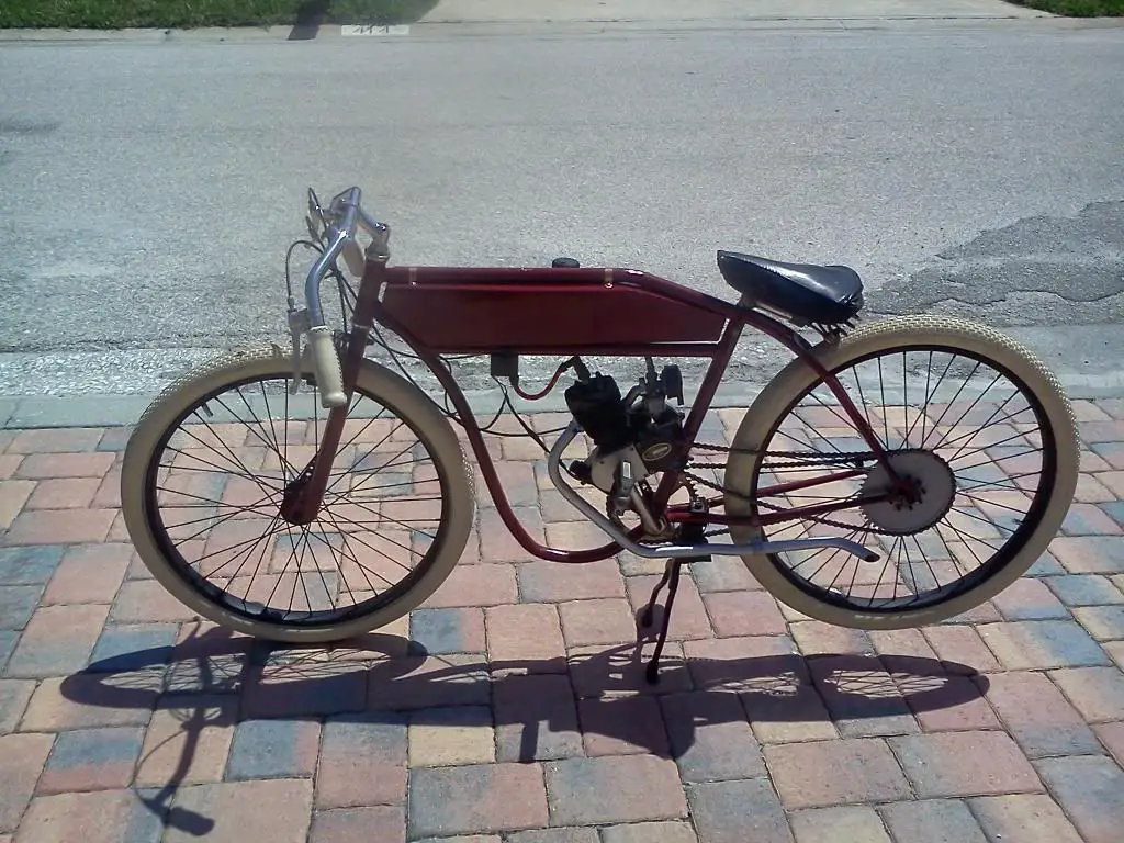

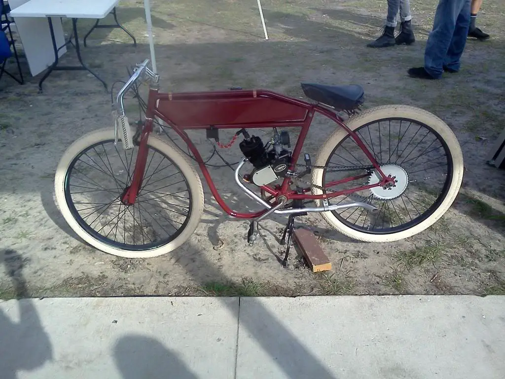

here's pics from the event, and a few others, wish i had more for you guys but ill be pulling it out to overhaul it soon, might even make a real tank(especially since the faux one was hit by falling debris and it crumbled) build was completed night before the event on the 26th, whole thing was built in pretty much 6 days so theres plenty of kinks ill need to work out soon lol.
Btw i won best of show(only award there was lol) got an award and $300! :D
At the event,
months later taking it for a spin
