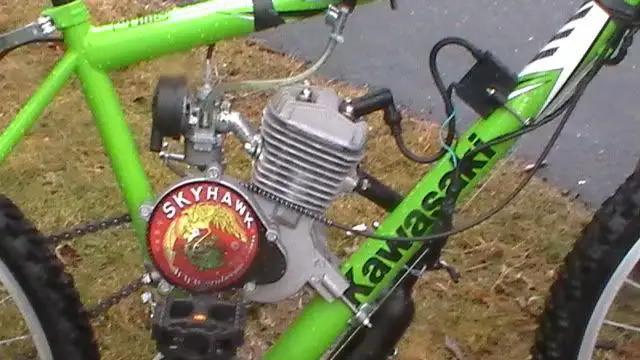

Did you guys see me second build? Serial number #002 Haha
Did any of you guys know "because I sure did not" That Kawasaki started making Mountain bikes My wife says "Finally after 85 years Kawasaki makes a bike without a motor and you gotta ruin it by putting a motor on it". Sure is nice to see she appreciates my talent as a bolt turner.
I cant stand this mess I need to invent wireless brakes , wireless throttle.
With my luck though the throttle will stick wide open like it did on my Nitro car & go from 50 M.P.H. to 0 into a brick wall that wouldn't be fun now would it?!!
Not nearly as big and roomy as my Schwinn it is a lot tighter though
