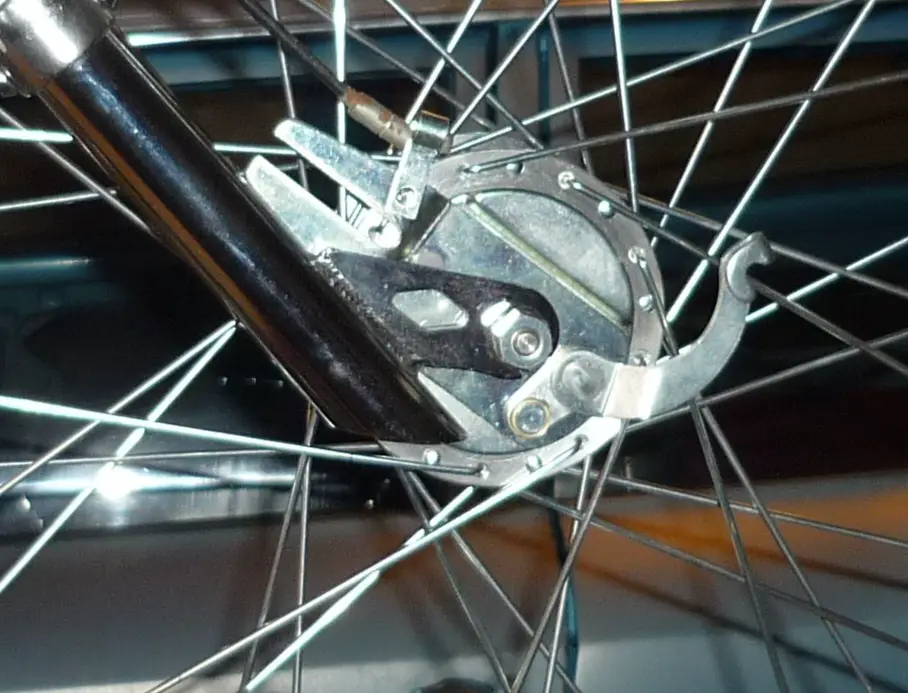

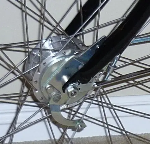

Since my last post I've had a growing concern about brakes... To be on
the safe side, I ordered a heavy duty 24" front wheel with a drum brake
from Worksman Bicycles.
I now realize, Worksman mounts their wheel with the brake
arm bolted to the L/H side of their fork as pictured...
Because the OCC fork tubes have larger diameters, the brake bracket
won't clear on the L/H side. It appears at this point, the simplest way to
install this wheel on the OCC chopper fork is with the brake arm bolted on the
R/H side as seen in the second picture...
Question 1: Is the Worksman drum brake designed to work in either direction?
Question 2: If the wheel/brake is installed “backwards” will it still work safely
and be as durable?

Well, a friend with a welder is stopping by today... I guess I'll have him weld tabs on both sides of my fork until I figure out which side is best to mount the brake arm? Ideas? Suggestions? Anyone?
okay, I've re-evaluated the brake situation and decided to modify the existing cable housing tab on the brake arm that attaches to the fork. I decided to drill through the spot weld and remove the tab. Now, I'll fabricate a new bracket and attach it to the brake arm in the opposite direction allowing the arm to be mounted in the original direction on the L/H side of the fork. This way it will function as designed. Simple. All is well in the kingdom.
Left alone long enough, it appears one can arrive at the simplest solution by pure desperate deduction. Elementary, Watson... It just takes a little skill and a bit of cunning to find the easiest way to a sound functional mod.
