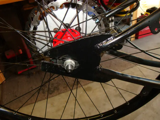

after the Death race I realized that I might have to make a tire change between heats. The way that my frame was built with the backwards 'schwinn' rear dropouts it would've taken me way to long to do a tire change. So I had horizontal rear dropouts welded in. I'm giong to try a different tire at the Willow race, because from what the manufacture told me the Kojaks are a softer compound, and I just plain wore through them. i'll bring an extra tire just in case.

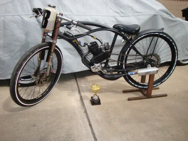

The willow race was great and I thought i would post an after race pic of my MB with the winning trophy. The tires held up through the practices, heats and 2 finals. I won't race with them again, but still can use them to cruise around town.
ID:	37338   Click image for larger version

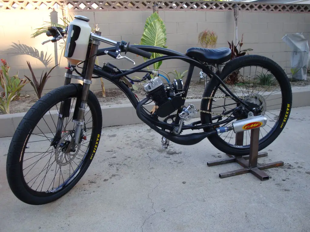

My china 2 stroke rat as it sits waiting to start the 2012 racing season here in So. Cal. I really didn’t have to do too much to get it ready. I installed the manic gen 2 head, new fuel line, new clutch pads, new pimp ass gold chain, new brake pads, and a new FMF sticker on the silencer. It seems that I have to replace the clutch pads and brake pads every other race. The hookworm tires held up great at the last race so they will be used again. Oh yeah, I almost forgot I changed the air in my tires also. See you in the pits--Magrider--
