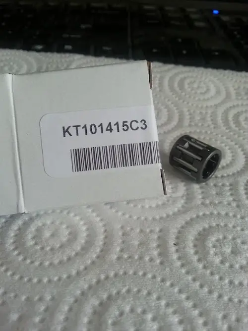

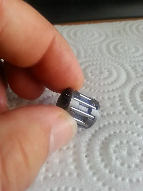

Below are some pics of the KT10x14x15 needle bearing from bearings direct.
