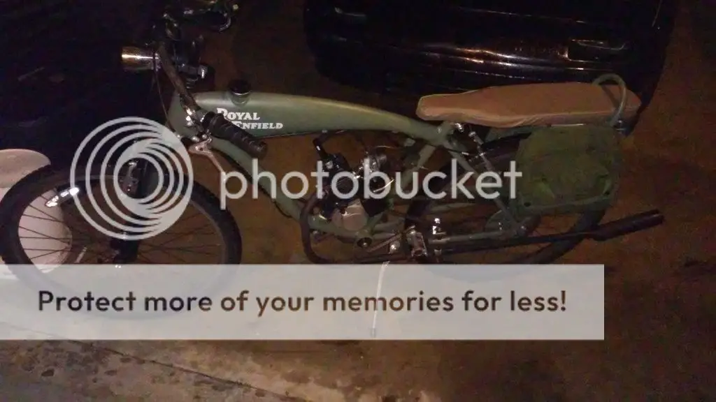

I will for sure have get some half links then for my GT frame chain. I have the 4 bolt tensioners now and would love to get rid of them too. I squeezed my chain stays together 2 inches and may not be able to remove mine. Also can you post a new picture or two of your tensioner-less bike with the long exhaust and how and where you mounted it...if and when you get some time. Thanks

This was taken at night time a couple days ago. I haven't been home in daylight long enough to work on things, let alone to take decent pictures.
What you're seeing here is that I have cut the tensioner bracket and converted it to an exhaust hanger. And the shiny object above it is a wheel reflector.
