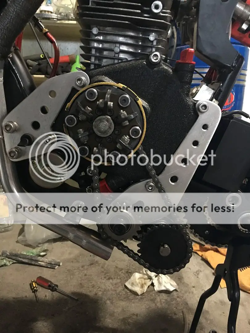

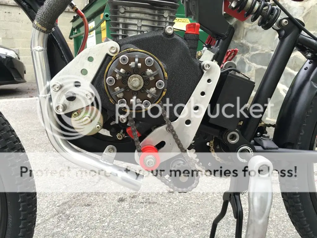

Well back to the 212 I made a new chain tensioner for the clutch side so that it tensions on the slack side of the chain. This helped a lot with a driveline vibration I was getting. I also swapped out the small front sprocket on the freewheel side to a 24 tooth sprocket down from a 36 and that really helped however I still have yet to have to shift the bike. I just ordered a 24 tooth to go up from a 17 tooth on the clutch side of the jackshaft so hopefully that gets me where I want to be. I'm also playing with clutch engagement points and I believe I need to go up a jet size however agk is always sold out of them . I may end up just drilling it slightly bigger.
That sounds good! Hopefully you get what you're looking for. Is that the tensioner on the other page you posted recently? I like that side cover! Did you buy that or paint it?
That's the new tensioner and that is a stock cover that I just removed the big extra boss off of and then wrinkle painted. That smaller sprocket in that picture is the one I'm enlarging going from 17 tooth to 24 so hopefully that gets me down even further.
A few things that would help with the vibration is to replace that tensioner wheel with a #35 sprocket type: Offered from Northern Tool and made by Azusa. All my past builds use this type, makes a big difference. Another thing to consider is a support on top of the motor connected to the frame, the torque with-out the top support will cause vibration. Look at Sportsman Flyer builds and you will see the type of mount I am talking about.
On another note: I would leave the clutch alone as is, you start playing with it and adjusting it will lead to headaches...trust me on that one...lol
After you get that all fine-tuned and can shift that bike you will have one beast for sure.

well little update I took the bike out for a high speed run. had a few issues but overall was successful the red roller that tensions the clutch side chain locked up and the chain wore a nice groove into it. that doesn't matter since my tensioner sprocket should be here any day now. It is still geared to tall but first and second are now useable, third gear the motor bogs down it just doesn't make enough power so im going to gear it down further and I think im going to get a cam and a billet rod. The bike on gps did 52.3 at about 75% throttle in second gear so im getting there a lot of trail and error with gear ratios.
Chain tension is done it deff is smoother the only vibration I'm getting now is under partial lock up from the clutch which doesn't bother me since it's only for the first 5 feet of movement or so. I also drill the jet out to put me at about a 119 jet size that made a huge difference on the top end.
